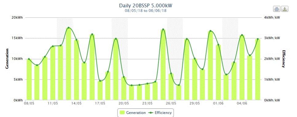

so, I have had a bit of a look around pvoutput.org at a few systems in Adelaide.
may and june this year for some of the low angle NE facing systems seem to be averaging 1.9 to 2.2 and they jumped to 2.5 for July. in the Plympton to Hallet Cove strip.
it looks like you could be 25-30% off the pace, unless you are on the rising ground towards the hills.
