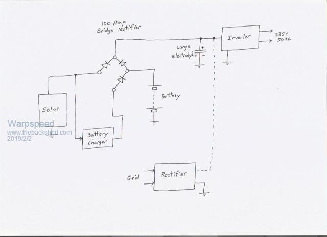

There will only ever be one diode voltage drop, regardless of which source is supplying power so only ever 1% loss.
The diode bridge in the circuit below has four diodes but only three actually do anything. Adding the fourth diode to the schematic only makes it look more confusing.
The rectifier is now optional. It started out with just solar + rectifier.
Its now solar + battery.
Cheers,  Tony.

  Warpspeed said
You had asked me why I was complicating the system by introducing multiple processors. Right in this diagram I see the need to have 3. 1 for PV MPPT. 1 for managing the charging algorithm for the battery chemistry. 1 for the inverter.
If you think this is not an efficient design, we can talk about it.
Right now, 5 questions:
1. What's the system that represents the dotted line connecting the rectified grid to the inverter?
2. With the heavy ripple from the rectified grid, what life would the large elec. cap have? How big should it be and what ESR?
3. How would those reverse biased diodes behave capacitively with the heavy ripple from the rectified grid?
4. What in this system ensures that power from the PV panels are drawn first and then any slack/difference from the grid?
Depending on the insolation levels, the output from the PV can vary above, at and go below the rectified grid output, but I still want to extract the last possible watt from the PV panels, right?
Let me clarify a point again: my requirement is not a "get power from any one, whichever is higher" source.
It is "always get power from PV FIRST and THEN take the remainder from" the other sources.
AKA Load sharing.
What are your thoughts about the following:
Scenario 1: Let's assume it's bright and cloudless outside and PV panels are in a situation to output their max. power (Pmp)
If I connected a 800Watt resistor as a load to the above circuit, which of the following scenarios would happen (and why):
a. Almost all of the power drawn from the grid and only some from the battery and some from PV
b. Almost all of the power drawn from the battery and rest from the grid
Scenario 2: Let's assume it just became cloudy outside and PV panels are in a situation to output half their max. power (0.5 Pmp)
b. Almost all of the power drawn from the battery and rest from the gridEdited by LadyN 2019-02-03

Warpspeed
Joined: 09/08/2007
Posts: 4406
Posted: 02:40am 02 Feb 2019
The dotted line is a cable with a plug on the end. If the rectifier is not in use its unplugged and effectively just not there. With a battery providing power at night, its no longer required.
My three phase six diode rectifer has only about 2% rms ripple without requiring any further filtering. A much bigger issue is ripple current caused by the inverter load which is going to be BRUTAL.
I am using three 12,000uF 250v electrolytics each of which has a continuous ripple current rating of 18.8 amps at 100Hz, and 14 milliohms ESR.
Capacitance is a non issue at 100Hz.
The highest voltage source will always take up the initial load. The Solar voltage must be higher than both the rectifier voltage and the battery voltage.
If its able to do so, it will supply all the required load without the voltage falling very far.
If solar struggles, the solar produced voltage will eventually drop until either the battery or the rectifier will be able to make up any shortfall. But solar will still be producing every bit that it can produce, and its only what extra is needed that comes from the battery or the rectifier.
Cheers,  Tony.
