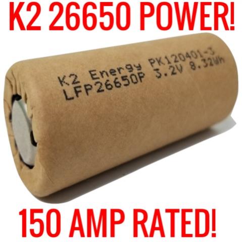

for those in the US.
The battery hookup has some 26650 lifepo4 cells for sale
the voltages of 4 series cells is well matched to 12 volt.
you could fit balance wires to fit a hobby charger or something standalone from knacro or jiller
my best estimate is this is 30% cheaper than retail for larger prizmatic cells however the hassle and expense of pack building means it really is only viable for something small.
still would be handy for tinkering.

No interest in second-hand, nor in small cylindricals, nor in drop-ins, nor discussion of ancillary electronics to deliver "BMS" functionality (however y'all define that), all those ideas are OT for this thread, OK?
