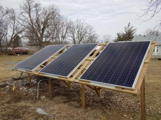

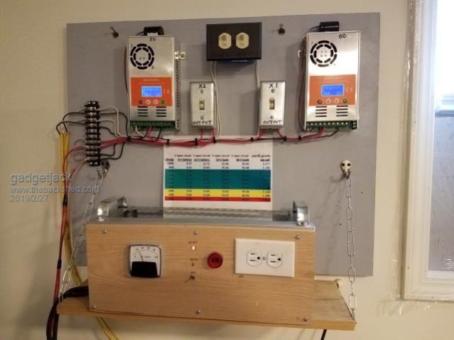

I have been using (2) of the MAKE SKY BLUE charge controllers on a 24v system for over a year and a half. I like the units , they work well with my panels. I have 1500 watts of panels and plan on expanding to 2000 this spring. It just runs my window air conditioner and a small electric oil heater in my shop , where I am most of the time after I retired. Can't be beat for the money.

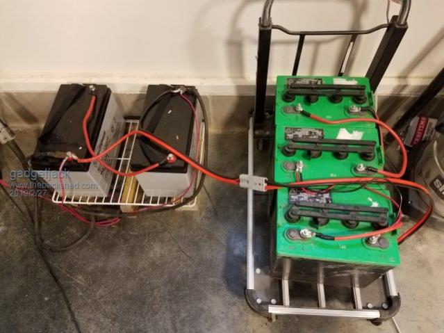

I charge a set of golf cart batteries and a backup set of deep cycle batteries that are 260 amps total. I attached pictures of the whole setup. I am always busy , little slower in the winter , but still always working. Always have new projects and repairs for friends. I built the inverter in the picture with the help of this great group of people on this board. There is a lot of smart people on this board. Glad to see new people coming in every day. Enjoy the day!

That is a beautiful neat set up you got there
I really like how you got everything laid out
looks like you took a laser level to it seeing what all you guys have done will give me some good ideas
