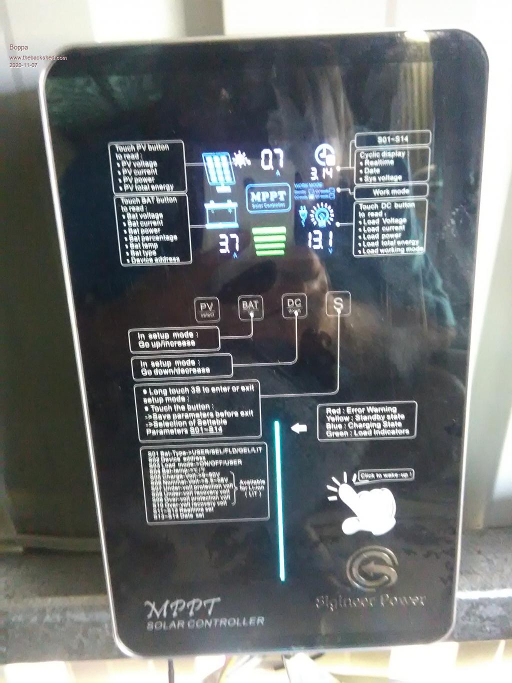

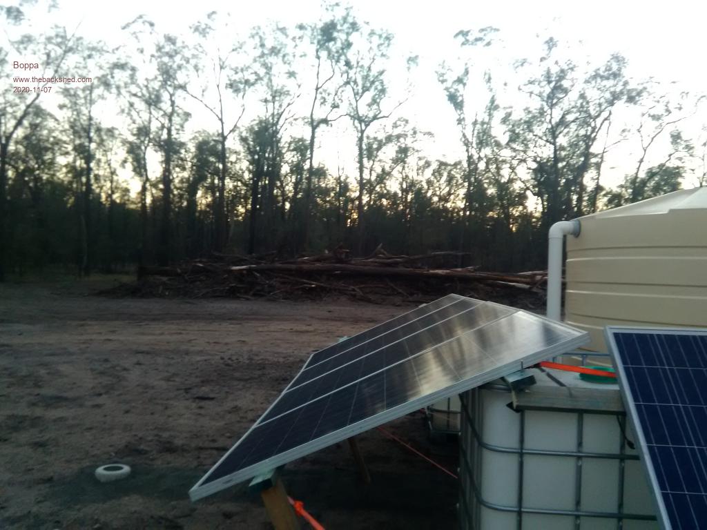

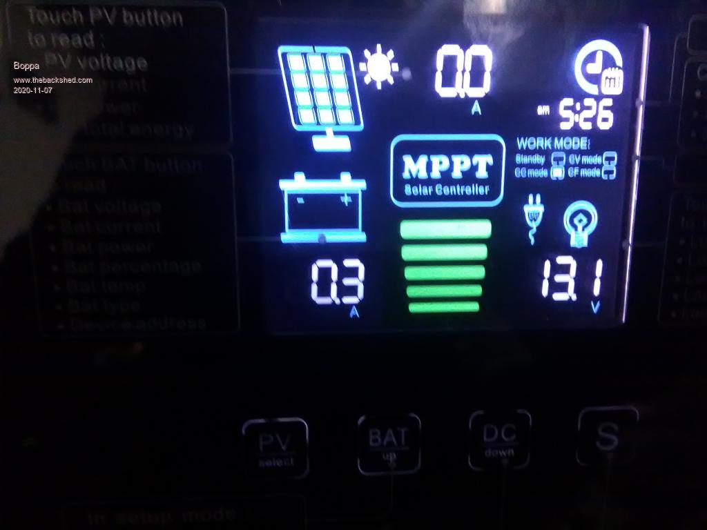

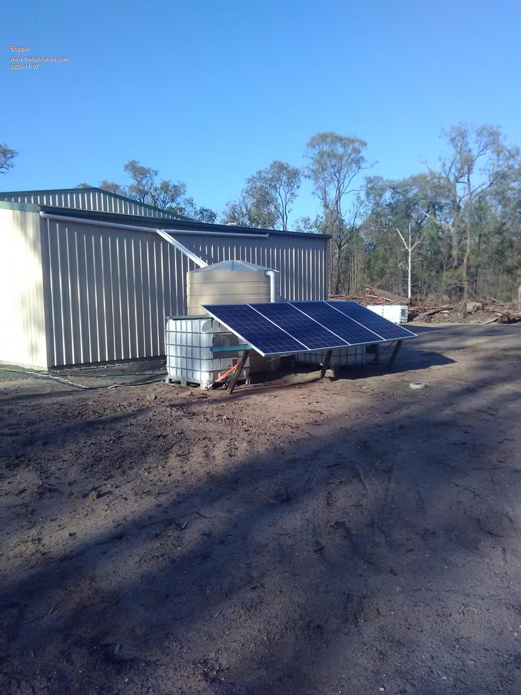

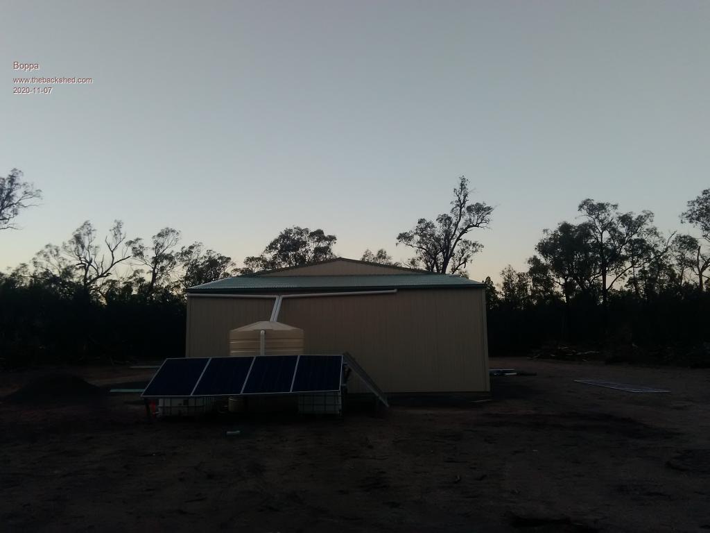

Posted: 07:19pm 06 Nov 2020
I'll start a separate thread for the shed, but just quickly...
here's some shots
Just took these...
300mA- not a lot, but still...
The suns not even up yet!!!
Eventually there's 17kw going (points) up there, 5 east, 5 west and 7 north
ETA- thats north we can see, east is to the left, west is to the right...
eta2- yes that 300ma shot was taken just a minute before that shot of the shed- with NO visible sun at all, the panels were putting in 10% of their maximum into the battery bank....
Edited 2020-11-07 05:25 by Boppa

An hour or so later- still no direct sunlight on the panels
Well....
MPPT and high voltage series strings- versus PWM and low voltage parallel strings...
No contest....not even on the same continent, let alone the same ballpark....
Later on, with full sunlight, it will hit 30A plus but as it starts putting some charge into the bank before the sun is even up- I'm impressed....
Edited 2020-11-07 07:01 by Boppa
