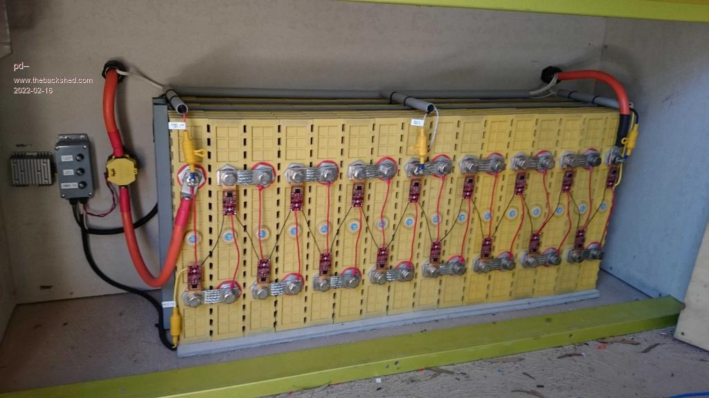

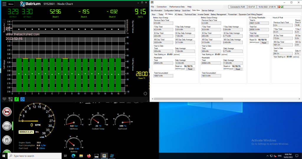

Winston Lithium have been good for me so far  6+ years and 27mw of energy out
Photo is from before my swap to Batrium bms
The console for the house power system
The best thing about the lithium's is that you can just fill them up quickly
and in winter you do not need to worry about having them at partial charge for extended periods of time

Thats pretty good stuff hey!
Similar reports from Boaters with 8 years up and 90% capacity at least left.
Are the first sensors A123?

Posted: 02:47am 17 Feb 2022
ev-power Perth Australia
https://www.ev-power.com.au/lithium-bms/

Pd
What is the difference in balance current between the original balance boards and the new  Batrium bms boards?
I know a Daly BMS will balance 20 or 30ma depending on which manual is available to read, for the first year this has been adequate (Average voltage 3.387 Differential voltage 0.046v Balance active only while charging), but later it will not be enough, all I have read about them is the will need more as they get older, bit too difficult to judge when and how much because all battery manufactures would be somewhat different as expected.
Voltage sag under load is minimal I guess.
Cheers Aaron
Off The Grid
pd--
Joined: 11/12/2020
Posts: 122
Posted: 11:00am 17 Feb 2022
The original evpower units where rated at 2A, typically they would shunt 1.5a
https://www.ev-power.com.au/product/bms-cbm400/
There an analog unit so at 3.5v ( 3.6v for the older units) the shunt transistor starts conducting and at 3.7 to 3.8 V they would be shunting ~1.5A
The Batrium units are rated at 1.98 A
The Bypass current is programmable i have my modules set on 1A and have added heat sinks to the modules to increase there reliability
you would need forced cooling to run them at higher amps and keep them reliable.
They support a number of different balancing strategies.
my current setup is as follows
if battery is charging and charge amps < 45a and SOC > 99.5 and cell voltage > 3.35v and cell voltage difference >  0.02v then enable balancing.
Time will tell if this needs tweaking , but there is ample balancing capacity left.
my forced cooling setup is nearly finished , it is activated by the temperature of the bypass modules
