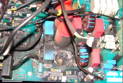

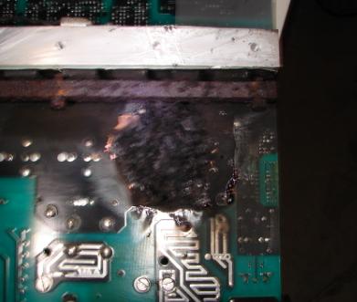

GWatPE
Joined: 01/09/2006
Posts: 2127
Posted: 11:39am 24 Jul 2009
I had the opportunity to photograph the result of a a spectacular failure of a grid inverter. Here are some photos.
The PCB crumbled away under where the PVinput bypass cap was.
Manufacturers need to pay more attention to providing units with a decent service life.
Gordon.
