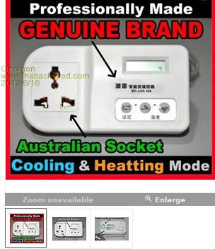

Noticed on E-Bay thermostat:
240V, 2000W
temp. range (-)9 to (+) 38 Deg C
The Thermostat has a Waterproof Probe with 2.3 Meters cable
Picture copy from E-Bay
Quite inexpensive alternative to turn on and off fan pushing warm air
and 2000W capacity could serve quite a few fans if needed.Edited by Georgen 2012-06-17
