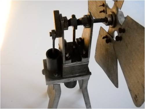

Well, think twice before using steam as a motive force. Lots of lubrication problems, as you've found. IMO Sterling-cycle is not an option unless you're in a very cold climate. A Sterling-cycle engine is basically an atmospheric "sucker" engine. The motive force depends on the difference between how hot and how cold you can get the trapped slug of air inside the thing. As things heat up, things slow down, at least that's the way my Sterling works:
. . . . . Mac

I know what you mean about the Stirling engine I restored one and it must of weighed a ton but only made 1 horsepower, but it was great to light a fire under it and a couple of minuets later see it chugging away.
