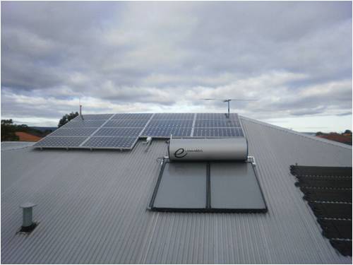

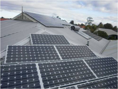

Array 1 with array 2 in the background
Peaked at over full rated output of the panels (1850W) at 1925W to the grid.

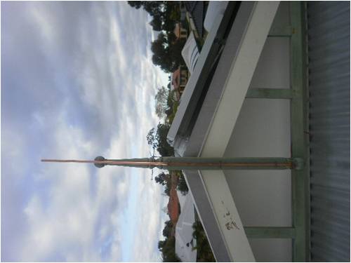

Lightning rod

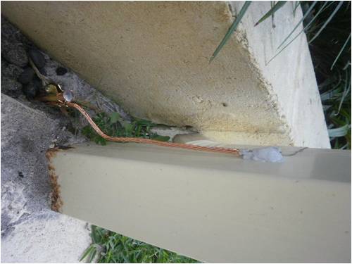

Additional earth stake (i know I know should have run a cable but didnt have one big/long enough hence through the roof sheets at 0.001Ohms to ground)

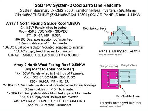

Schematic for next owner / anyone who has to work on it
