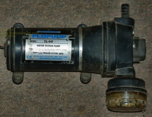

My Lorentz ceased up when it was about 2 years old, on taking out of the bore and separating the "screw" from the motor found the motor was hard to turn. My supplier checked it and told me that a batch were sent out that had bushes(bearings) that grew tighter with age. My pump was one of that batch and Lorentz repaired it free of charge.
The diaphragm pumps I am talking about are the 12 or 24volt DC variety, that are used frequently by farmers up my way to spray weed control from usually 4 wheelers with a small tank mounted on back.. They have no solenoid just an eccentric driven bearing on the shaft of a normal brushed motor. Similar to a wobble plate, usually having 4 diaphragms. The expensive ones are stamped Made in USA (Shurflow etc), but I suspect they are in fact made in the same place as the Ebay ones, China. I wrap 1/2" copper around the motor and feed the discharge through this,for cooling, they then will run continuous.

David,
Feel they`d probably handle the hot water, the diaphragm`s appear to be made of a silicon like substance rather then rubber. They have inbuilt thermal protection in the motor, some have fan cooling(although the ebay ones I`ve purchased so far haven`t). They have proven to be fairly bulletproof.
