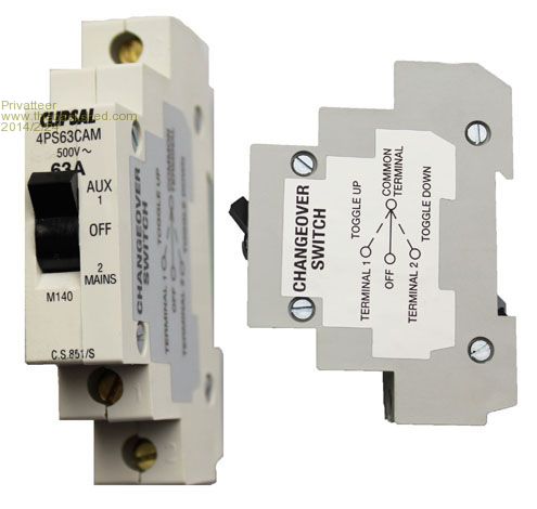

Any electrical wholesaler. Not brought one for a while but think about $60.
Edit: Make sure he/you puts a warning on switchboard about dual supply. RED label.Edited by Privatteer 2014-02-25

  Privatteer said   Any electrical wholesaler. Not brought one for a while but think about $60.
Thanks Privatteer....exactly what I was looking for.
Do these components have a "common" name in the industry, ie. what to search for.
Yes, I have the full set of labels on hand ready to use. He may be expensive but he is bloody good.

Posted: 09:39am 24 Feb 2014
Damn it...its written on the side as a Changeover Switch, sorry.
Searched Changeover Switch on Evilbay and found it.

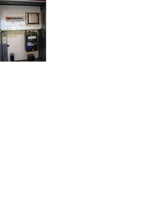

fernbrae55
Joined: 12/02/2014
Posts: 3
Posted: 11:55am 28 Feb 2014
This is a picture of the switch installed
