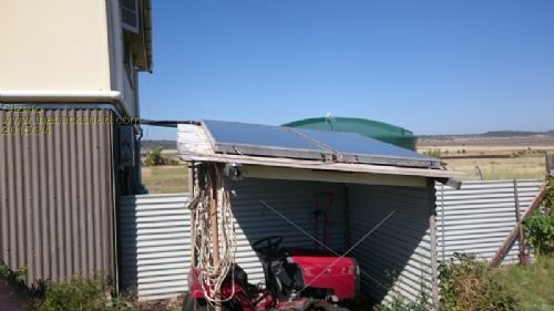

Just a couple of photos of my solar water heater based on a Micromite.
The system consists of a couple of solar panels and a 300 liter hot water tank, all second hand, totaling about $300 from memory. The controller is based on a Micromite, has 3 outputs and reads from 4 temp sensors.

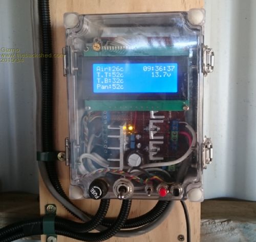

The controlled is aware of the time, and uses one output to switch on a night light ( 12v fluro under the house ). It also uses the time to trigger certain events, for example, the heating cycle only happens between 7 am and 5pm.
The heating cycle runs the pump for a couple of seconds every 2 minutes, just to push a little hot water past the panel temperature sensor. It then compares the panel temperature against the tank temperatures ( Tank Top and Tank Bottom ). If more than 10c above tank temperature, the pump runs for 20 seconds, which will force all hot water from the panel into the tank. Once the tank temperature is hot ( 60c at top, 40c at bottom ), the heating cycle stops for the day. Generally the tank is hot by 10am on a clear day, and 300 liters of hot water will last 3 to 4 days if its overcast. After that, I have a on demand gas hot water system I can turn on, I dont like cold showers!
It also has a defrost cycle. If the air temperature drops below 4c, it turns on some heaters in the panels to protect them. If the temp drops below 1c, it will start cycling warm water into the panel.
The only problem at this stage is a drift in the time, which was a problem with the early Micromites. It gains about 3 minutes a day, but at the moment I can live with that, I just reset the time once a week.
The LCD displays the 4 temperatures, supply voltage, time, and other status infomation. Two buttons give me access to a menu system where I can set time, temperatures, pump duration, etc.

WOW.. Nice "working" project Giz..!
Now, is that the hot water tank behind the panel in green..? Man... Now that's what I call a hot water tank..! Looks like an awesome design and seems to be working out well for you... I do love it when one can actually finish a project..! I seem to have several NOT currently there yet... I like the "see-through" box you got... It has the water tight ring seal I think.. Anyway, I was wondering if you used thermo probes, (like type "J") and what type of "front-end" interface circuits you used..? I have tried several different kinds... (just wondering)...

Nah thats a 22,000 liter rain water tank. The hot water tank is under the house, next to the controller. I didn't upload a picture as its covered in insulation and a ugly looking monstrosity.
I used LS18B20 probes. Bought a pack of 5 off eBay for about $10, water proof. They interface well with the Micromite, and give a reading in degrees celsius, so there is no need to calibrate or convert the figures. The previous controller was a much simpler device, used a PicAxe chip and 3 thermocouples, it worked, but was a bugger to set up. For me the big feature of this new controller is I can see just how warm the tank is without putting my hand on a uninsulated outlet pipe.

If the time error is fairly constant then perhaps you can code in a routine to correct the time daily.
Eg*.
Option explicit
Dim flag
Dim timetext$
Dim oldtt$
Time$ = "00:00:00"
timetext$ = Time$
If timetext$ <> oldtt$ Then Print timetext$
oldtt$ = timetext$
If flag = 0 And Timetext$ = "00:00:10" Then
Time$ = "00:00:00"
flag = 1 : Print "flag 1"
If flag = 1 And Timetext$ = "00:00:11" Then
flag = 0 : Print "flag 0"
If timetext$ = "00:00:15" Then Time$ = "23:59:55":Print "Jump"
* Example Code Only. May not be fit for your purpose.
