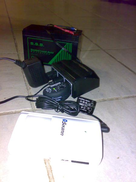

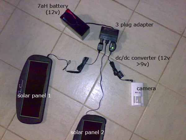

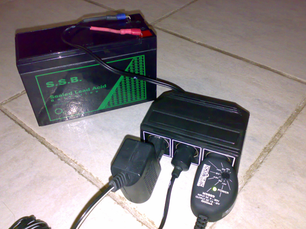

Please take a look at the attached photos of my rig so far. I have the camera powered by a 7aH battery that is charged by 2 x solar panels (100mA each).
I understand that these panels are probably under powered for the drain of the camera, but at this stage i am unable to get my hands on anything bigger before my next visit.
Given that the 7aH battery is at full capacity, and the solar panels are receiving maximum sunlight each day, how long could i expect this camera to still function before draining the battery dead? I need it to go for at least 2 weeks!!! (am i wasting my time?)
There is no regulator to prevent over charging/discharging apart from the built in diode in the solar panels.
Have i wired this up correctly? if not could someone give me the right way of setting this up..
Cheers,
Ashton

I think 1.5W will be way too small, even if you get 12 hours of usable sunshine (you won't) thats less than 0.7 watts to play with over a 24 hour period (including battery losses)

Having done a rough calculation I would guess that the battery would run the camera for about 12 days and the solar cells would extend this by about an equal amount for every hour of full sunshine per day so this should run for about two weeks.
