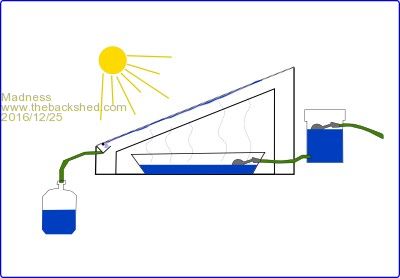

  Madness said  Another option is a solar still as shown below, water is condensed on the glass lid and runs into a plastic trough.
Yeah,
Solar Still's have always held an interest.
Did spend some time browsing thru a few videos on YouTube; some have come up with some pretty cool designs.
Metal free, efficient & relatively low maintenance.
Also found this good bit of info.
Phil
Madness
Joined: 08/10/2011
Posts: 2498
Posted: 05:57pm 02 Jan 2017
I have decided to go with an electric element in the pressure cooker and a glass condenser. Mainly because it is easier and quicker to build than a solar still. Also there are plenty of times that I have plenty of energy to spare anyway so powering it is no issue.
I found an electric kettle element at the local tip shop that was very easy to fit to the Aluminium pressure cooker that came from the same place. I just hammered a flat section on one side and cut a hole, the Aluminium is close to the same thickness of the plastic kettle so it fits very well and seals perfectly.

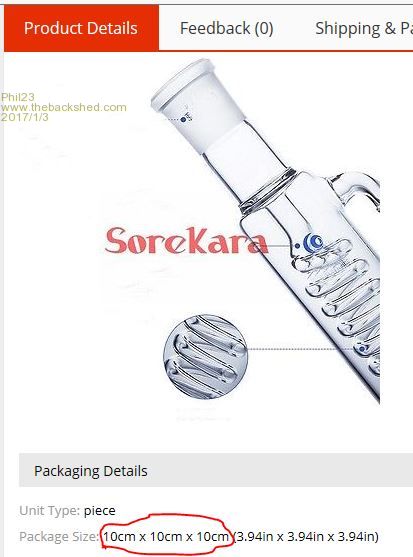

Phil23
Joined: 27/03/2016
Posts: 1667
Posted: 12:39am 03 Jan 2017
  Madness said
The condenser and an adapter were under $55 AUD with delivery.
Lol,
I hope that's an error in their "Packaging Size". Would hate to hear your 600mm condenser actually did arrive in a 4" square box.
Madness
Joined: 08/10/2011
Posts: 2498
Posted: 12:46am 03 Jan 2017
Maybe they roll it up to fit in the box.
Just realised my mental arithmetic failed, actually cost $43.81 AUDEdited by Madness 2017-01-04
