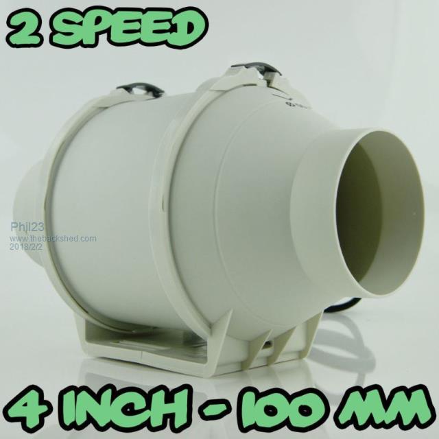

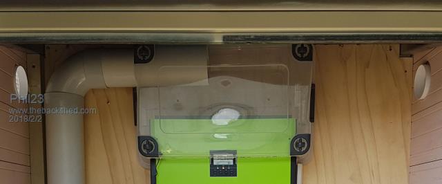

  George65 said  Atm I have a tube fan sitting on the top of the thing blowing down.
This is what I have ATM.
A cut up shallow storage tub to sit over the top of the inverter, it's not sealed, has about a 1/2" gap ATM.
Some 4" sewer pipe, 4" inline fan and some 4" foil flexible duct that ducks under the house where the air is much cooler.
The fan consumes 26W on high, 23W on low.
198m³/h & 165m³ respectively.
Some they of thermostat is on the to do list
Cheers.

Clever arrangement Phil.
Is your green inverter there one of those Axpert/voltronic/infiniti/giant/other brand, inverters that have the fans pulling the heat downwards?
Ralph
That's simple and impressive ingenuity!

  Ralph2k6 said   Clever arrangement Phil.
Yep that's the type.
The box (Bunnings under bed storage tub), clears the inverter by about 15mm.
Cut it to fit with the angle grinder (cut/melt).
Also cut the lid out so it can screw to the ply & make the other bit easily removable.
Re Computer fans, I find they have very low air flow once there's any restriction.
The transfer fan doesn't suffer that.
During our hottest days, the ambient air on the N/E side of the house, (shaded) was 36°C, while the air pulled from 2 feet under the house near the floor joists was just on 32°. Well worth the effort of the 3 feet of flex.
Phil.
