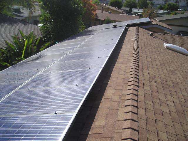

Hi Guys Its Been A Long Time sense Iv Been Here.
I just install 10k solar system and its on a smart meter And I didn't Permit It.
So between 9am to 1pm I give away Approx 2 to 3000 watts to the electric company.
My real question is there a smart charger / inverter that can see when Im over powering My Electric uses and use that power to charge batteries and then when I need the power after sun down it inverts the batteries to My grid/house, the inverter would need to shut off if there is a power outage.

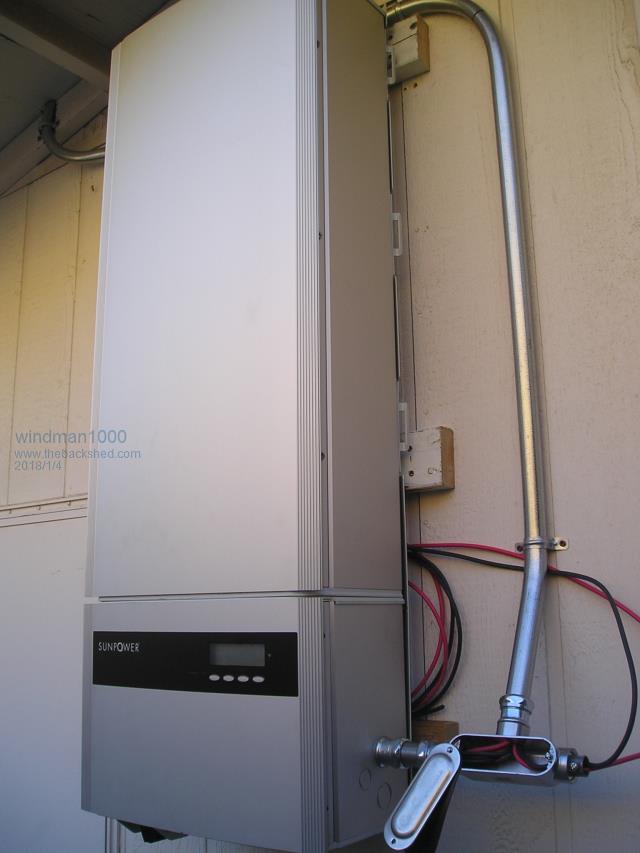

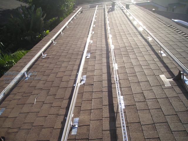

I Ran into a good deal on this 10k system ( 40 New panels 250 watt 75.00 each 3.000 total)
And found my 10k sunpower grid tie inverter for 1200.00 off of ebay, aluminum Uni-Rak for my rails 400.
I have about 5500.00 total in this 10k system, And I put It In to code but didnt permit it , So im trying to get the most out of it.
