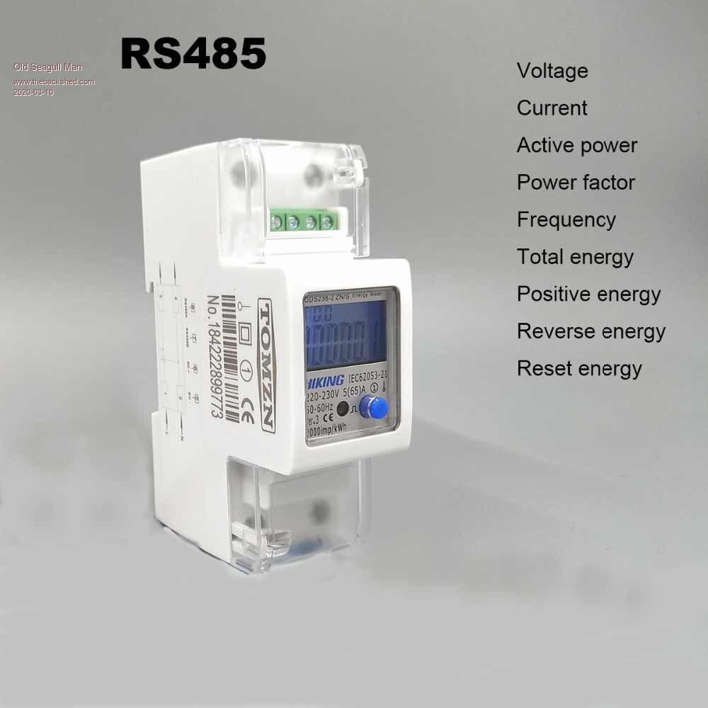

Havent used the Eastrons but have 4 Hiking modbus 65amp meters doing s good job.
One has an external ct clamp, connected to the single phase mains, feed in.
It measures total energy input and export from the house.
The other three are direct connect type, and measure up to 65 amps these are connected to the outputs of our three solar inverters. these are all connected to a raspberry Pi
that monitors, there outputs. As well as the houses energy consumption.

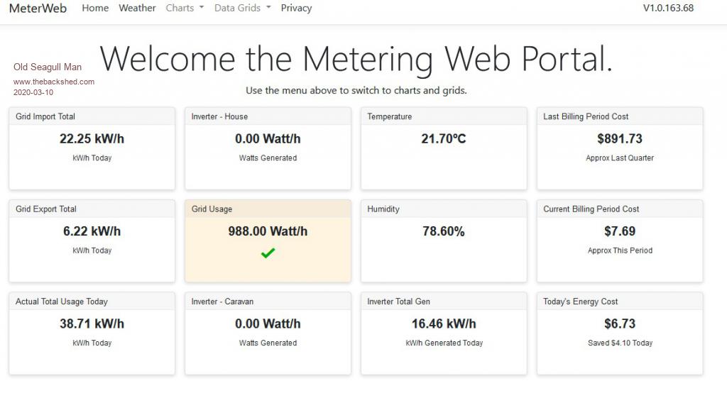

Our son wrote all the software, and designed he web porthole, and monitoring.
It produces daily, weekly, and monthly reports. Plus uploads to PV Output org.

Screen Cap
This is just the front Info Page See around the house. All inverters are on the inverters page.But from this we can see export, or import, and control inverters, or turn on or off air-con, etc.
