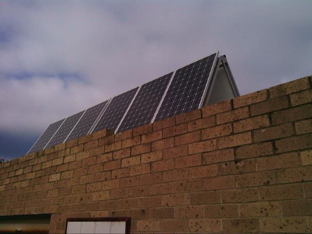

I have a system like that, 1.2Kw east plus 1.2Kw west, connected in parallel.
Both looking 60 degrees above the horizon, and it works very well.

Here in Melbourne, the sun rises and sets well south of due east-west during the summer months, so that even though the days are long, my north facing panels are quite slow to get going in the mornings and quit fairly early in the afternoons.
The east west virtual tracker really makes a big difference the first and last hour and a half.
At mid winter the sun is mostly in the north, and I expected pretty poor performance from the east west facing array. But in total cloud it works just as well as the north facing panels, taking into consideration their smaller total area.
So all things considered it has made a very worthwhile addition, and I am very pleased with the result.

  Warpspeed said   [quote]
Why such a steep angle?
Is this for space reasons?
Seems others like myself are finding the very shallow angles are working better for them so be interested to know why you have gone so steep?

Posted: 02:24am 25 Jan 2018
Sixty degrees is the optimum angle for a virtual tracker because it gives almost a constant flat power curve over the whole day.
