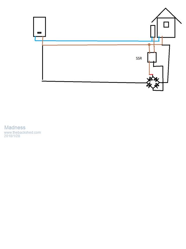

How about just having a rectifier connected to both ends of the AC active cable from the inverter that is further away from the house wiring. This will rectify the difference if it is more than 3V it will turn on the SSR.
oztules
Joined: 26/07/2007
Posts: 1686
Posted: 01:06am 28 Jan 2018
Very simple and elegant, but will not take advantage of generation below 3v ( as an example).
Also not sure how the SSR copes with the iffy part of the led almost getting going. My experience is that they are not too good with controlling power linearly, but respond well to pwm.
.......oztules
