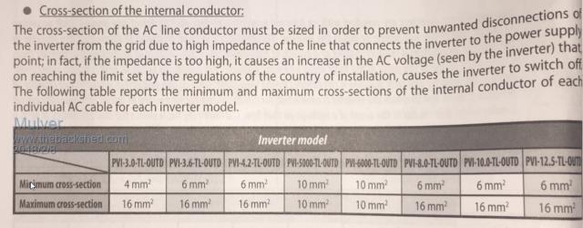

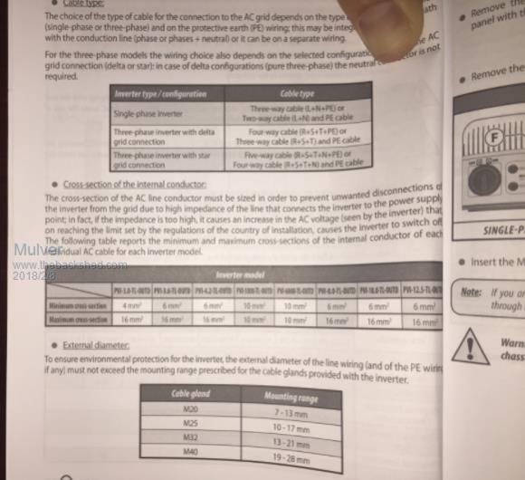

In one of my inverter manuals it states minimum cable cross sections. This is to avoid disconnections caused by high impedance etc etc.
3kw. 4mm2 cable
3,6 to 4.2kw. 6mm2 cable.
5 to 6kw 10mm2 cable.
I've taken a photo I'll load it up tomorrow.

Mulver
Joined: 27/02/2017
Posts: 160
Posted: 11:06pm 07 Feb 2018
Sorry its a bit blurry!
Regardless you cant punch 5kw up a 2.5mm2 cable.
I suggest a nice big fat cable from your switch board to maybe an inverter sub board in your shed.
The most id sneek on a 2.5mm2 supply 25m away would be a 1.5kw inverter.
For example I have a 2.5mm2 supplying my rain water tank pump 20 m away and id like to sneek a few pannels on top of the big tank.
