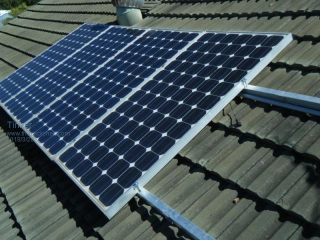

I had 2 strings of 6 panels each to install on my roof. As the panels were cheap second hand ($25.-ea) I did not want to spend top dollar on the mounting hardware. Also, I wanted to do the installing work myself (1 person), not exactly easy on a sloping tile roof.
So this is what I came up with, its perhaps useful for other DIY's.

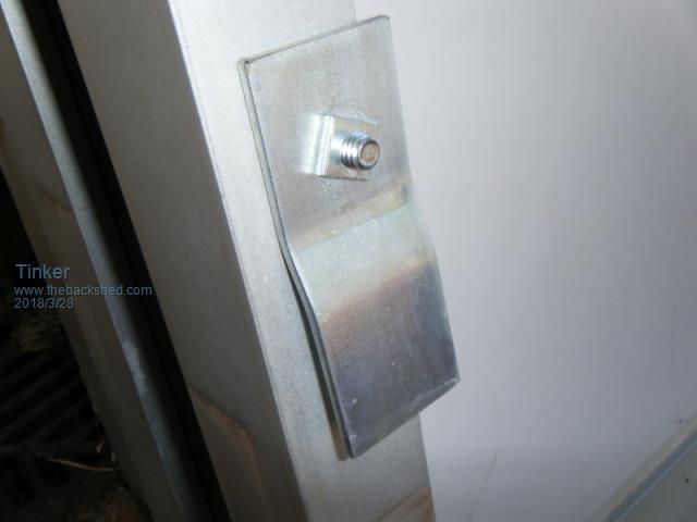

First, special 'catch brackets' were bolted to each lower side of the panels.
These catch in the up-roof facing lip of the galvanised angle iron rails.
Its easy for one person to lay the panel a little higher up on the rails and let it slide down until the 'catch' brackets engage. They hold the panel securely on the rails while the connectors were engaged and then the panel can be slid sideways to its correct location. Then tightening the lock down bolts fixed the panel in place.

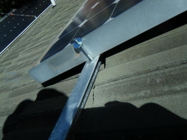

A close up of the 'catch', hidden in the shade under the rail lip.
Its nice not having to worry about the panel sliding off when climbing down the ladder to fetch a forgotten bolt or something.

Q. From the angle of the U channel it looks like water will get into it easily. Is that going to cause an issues in the future?

What U channel? Its galvanised angle iron or L channel. I see no place for water to get in and remain there.

Ok, I thought it looked like Unistrut mounted on it's side.

Question . Where did you buy those bent brackets in the first photo or did you bend them in your vice?

Thanks Bruce, These brackets are home made from 40x3mm flat steel bar. I bent them on my press by placing a 3mm offcut on top one side and under it other side with about 6mm separation. A few tons of pressure and I had a bracket. These were electro zinc plated. Later I knocked a bigger angle to the 'stick out' side so they engaged easier.

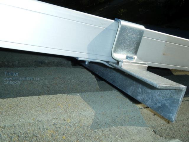

Here is another close up of the end panel:
With regard to the gavanised steel/ anodised aluminium contact, I had two panels up there on a shorter, identical, angle rail and there was no corrosion problem visible after 2 years.
My place is about 3km from the beach, behind a hill, so salt water mist is less of a problem here.
I'll keep an eye on the end brackets, pictured above, it is there that any corrosion would first occur IMO.
