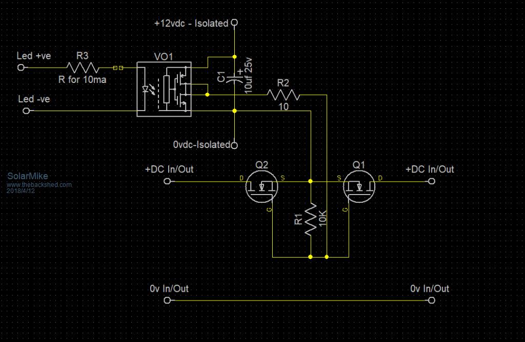

Here is a simple circuit I just drew up that could be used as the basis for a high voltage isolated switch; uses two mosfets back to back so to be bidirectional as to in and out. Requires an isolated low power DC rail to supply the FOD3180 opto driver chip. Note I haven't drawn in any circuit protective devices or bypass caps. Shouldn't be too difficult to locate suitable 500-600Vdc mosfets with a low on resistance.
The above circuit can switch at high speed 50Khz or so, you haven't mentioned intended usage, personally I would use an evacuated relay if just slow on/of switching was required see these US$60 each. High Volage Relay

Thanks for taking the time and effort with that Mike. I have some mosfets but will have to check what they are.

The mosfet switch is efficient but susceptible to voltage spikes etc, shorting out the mosfet, especially if any inductive loads are in the circuit.

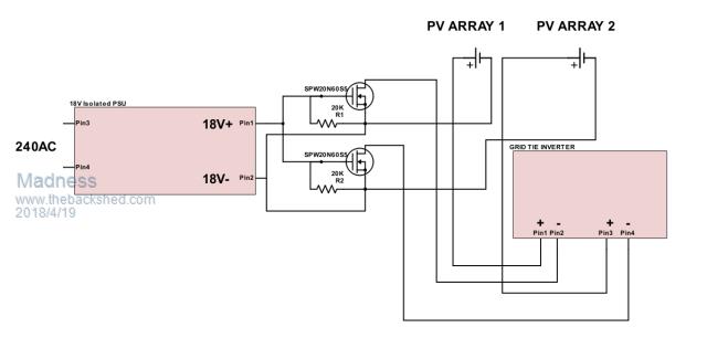

I have MOSFETS switching tens of thousands of times a day to regulate my solar array connected to my GTI which then charges my batteries via the off-grid inverter. It would not take much to setup something similar for what you are doing, Mine is operating 2 arrays at close to 500VDC and 10A.

Not taking much to you is a lot different to what it would take for me but none the less, I'd be very interested and appreciative if you would advise on how you suggest to do it and hopefully I can follow and put it into practice.

You need these MOSFETs one of these Isolated powers supplies. 2 20K 0.5W resistors silicone insulator pads for the MOSFETS and a heat sink. It is very important that the MOSFETs are electrically isolated from the heatsink and keep in mind you are dealing with high voltage DC. You can get the data sheet for the MOSFETs here so you will know which pin goes where.
Turn on the AC power and it will conduct, turn it off the PV power stops.

That is interesting Gary, thanks for posting.
In other words, an alternative 'bang, bang' switching method, this time switching the DC side of the inverter.
While my AC side switching (fooling the GTI there is a mains outage) works fine for me I am wondering about long term effects on the GTI, having the mains drop out every day.
Switching the panels on or off simulates the day/night cycle to the GTI.
I shall try that DC switching when my work bench looks for another project .
I would only require 1 array switching (10A max) and, from that Mosfet spec sheet, a relatively small heat sink, capable of dissipating 10W or so.

Klaus you could take it one step further and use it as a PWM regulator based on your battery voltage.

Here is a PDF of the circuit that will be easier to read.
2018-04-19_213607_schemeit-project.pdf

Thank You very much. I did some reading up on Mosfets and this looks like a great solution. Amazing such small devices can handle so much power!
I have ordered the parts, now just need to find the silicone sheets.
This is a nice simple solution to what otherwise seems like a very difficult problem.
