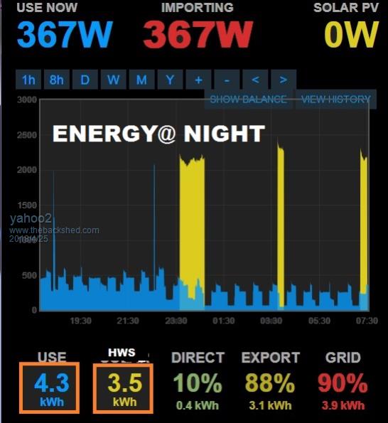

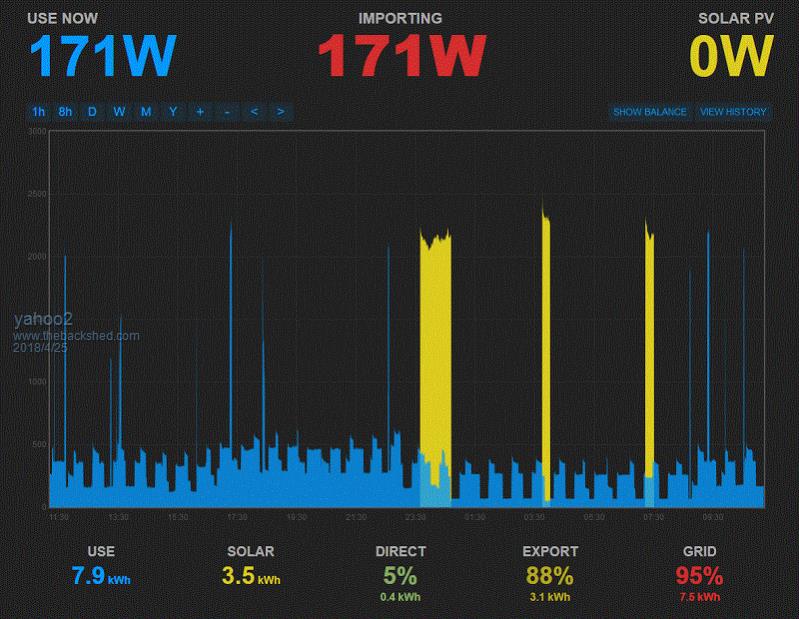

I am a big fan of logging power use for a week or a month before making any changes to a system, just to see what is what.
So just looking at one 24 hour period we can tell a lot.
the yellow bars are not actually solar, I have hijacked that sensor to measure the electric HWS seperately.
the first thing we can tell is there are very few load periods that are over 2500 watts. interesting!!

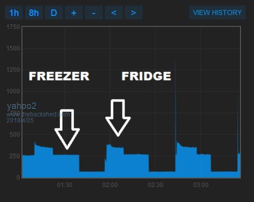

second is the freezer runs for well more than 50% of the time and chews a lot of power. The fridge is the little wedge shaped pimple on top, they seem to run together a lot.
that needs to be fixed.
Third the water heater is poorly insulated and is leaking a lot of heat (those two reheat spikes should not be there, no hot water was used after midnight). so there are two solutions, adjust the timer to come on later and only do one heat of the water tank at night. Or redo the insulation I think it is just pipework that is the problem.
Four, if we ignore the HWS load there is under 5 kwh used from sunset till sunrise so if we add a margin or find out if the weekend loads are vastly different there is the potential to power this house overnight from 7-10 kwh of storage.
Five, the spikes we can see are boiling the kettle 6 times and running an induction cooktop a few times.
