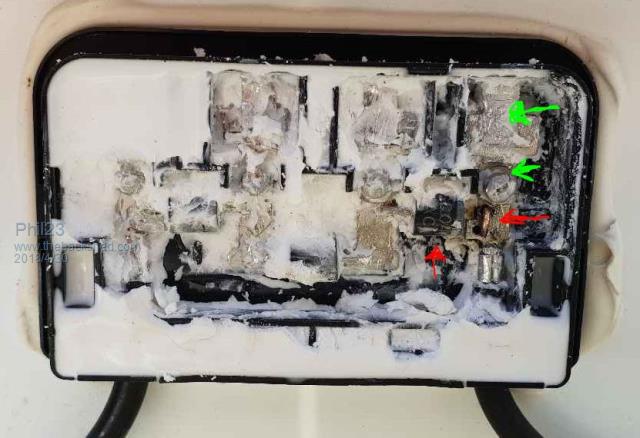

Opened up the terminal block; potted in silicone.
Figured the 3rd diode must be SC, so cut it's leg.
Notice how the lead fell free.
I could measure 12V across each string, but once the diode was out I got 0V from the panel.
I can get full Voc at the top green mark, but nothing at the screw below it.
It should be present there I think?
Seems the diode may have been ok, just poorly terminated, hence the heat signs, but the real problem may have been lack of continuity between the two bits marked in green.
Will wait for the silicone solvent to work a bit & then have a better look.
Phil.

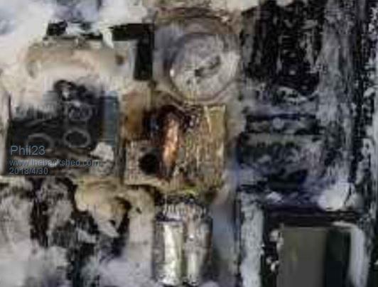

Edit, Closer view.
Edited by Phil23 2018-05-01

  yahoo2 said   a third of your panel is not in circuit, it sounds like it has been wired incorrectly somehow.
Actually I think I am wrong, you should get full voltage and restricted amps with a wiring fault. so if you have a terminal with full voltage perhaps you have a high resistance connection somewhere.
Actually I think I am wrong....
Nope,
Your were on the mark. The last 1/3 was out of circuit due to a very poor connection at the top green mark when the strip from the cells comes thru the slot in the terminal.
Output from the other 2 was getting there via the 3rd diode, despite the fact that it's spot weld had failed.
Phil.

Fault was exactly as shown here...
