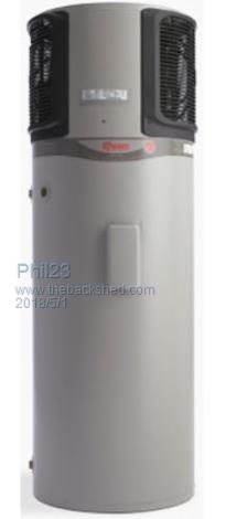

I've got 2 Rheem's here; both recovered as scrap.
What I've done is recovered the Heat pump unit off the top & converted it to a Spa water heater.
There's quite a few points of failure.
The Tank Temp sensor, is a strip PCB with resistors & thermistors, that green flexible ribbon type, runs the full height of the tank from top to bottom & measures temp at about 6 locations.
It get moisture in it & fails. It's actually got 2 separate circuits; as in a spare, but on the one I stripped out, bonded under the expanded foam, the spare side was almost as corroded as the one is service.
Their circulation pump is prone to clogging up & failing, causing the compressor to draw maximum current & eventually blow the Mosfet's on the control board.
Basically, the only good part is the compressor/heat exchanger unit. It's quite good.
Replace all their control electronics with my home grown stuff & it's an efficient Spa heater in conjunction with the solar water panels.

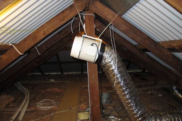

  yahoo2 said   it has crossed my mind that pv solar panels shed quite a bit of heat and it could be possible to enclose the back of them to use as a solar collector. Just a thought for the budding experimenter.
I have had this same thought.
There would be a LOT of heat available but putting it into practical application would be another matter.
One would have to enclose and mount the panels in such a way there was airflow within the enclosed space, prefrably as even as possible. One then has to get the warmed air into the living space.
To do this aesthetically, in a structurally sound manner ( water leaks etc) and also safely ( fire regs) would be another matter.
Either a penetration through the roof or the eaves would be needed to bring the air in.
This would require either metal or soft ducting. Neither seem ideal.
Looking at my own home, this would be difficult to do without detracting from the look of the place and basically de valuing it.
It may be possible in the right circumstances to have something seasonal that just sat in the yard on a mobile ground mount type arrangement and ducted the air in via a window with a suitable covering in the open area to attach the ducting to.
One of the panels could power a DC blower as heat would be the main objective or the air could be pulled through from the house side. which may be better.
I find a lot of things like this. The ideas are workable and efficient in themselves, applying them in a practical method is different.
My last house was old and looks werent a big part of the value although the layout and position on the land which although large, was not practical for a lot of things I would have like to have done.
Here in a very upmarket area, you really don't want the place looking like the house that Jack built.
That said, I am also looking at doing a verandah out of panels on one end of the house. If I keep the ducting in mind at the design stage, it would be far simpler to incorporate the idea than to try and add it to anything existing. I am currently trying to do a deal on 40x 250W panels to use as the roof covering. I could put any leftovers up on the west side of the house roof and sell some of the smaller ones I have presently. Could get my money back on them pretty easily and can't see me needing 30Kw worth of panels.
The main idea for this verandah was to create shade in summer along that wall which is a terrible heat soak in summer and result in much lower inside temps if it could be shaded. If heat could be drawn in winter, double bonus along with the extra solar power.
I have worked out that used panels at $100 kw would be about double the cost of Colourbond for the same coverage but of course the Colourbond does not give you any savings or return so at the end of a year ( or less) the panels would be cheaper and pay well after the initial 12 months or less.
Ducting the heated air in under the eaves would be possible although dampers would need to be installed probably for fire/ insurance reasons and to stop the entry of hot air in summer. If a reversible or 2nd fan was installed, the roof space could also be cooled in summer by taking air out of there.
I was thinking of putting a duct with a fan to the peak of the roof with a filter on the end and sucking the warmed air back down into the home from there. Was just goi9ng to make up andother temporary manhole cover for testing and if it worked as I believe it would, then I could just either tap the air into the existing AC ducts or install a seperate AC type outlet. I already bought a double thermostat that would monitor house and roof temp so the thing only kicked in when the roof temp was say 5o warmer than the house temp and if all the warm air got used, it would switch off and wait for it to become warm again.
Someone told me they thought this was a less than brilliant idea as they believed the air quality with dust and the vapors given off by insulation materials etc was not good.
The suggestion was to install an air to water or air to air heat exchanger.
Takes the concept from a No/low cost idea to one that would have to be weighed up carefully on the merits of cost Vs Return.
I wonder if there would be a way to measure air quality in a specific roof space to see if the air was ok or best avoided? Perhaps ducting and refreshing the air may be enough with dust filtering for it to be OK? Wonder if there are affordable Charcoal or similar type filters for air like one can get for tap water?
Ducting the warm roof space air would certainly be a cheap and easy enough thing to do and I believe would be effective as well. Never been in a cool roof space even in the middle of a downpour at night looking for leaks ! :0)
