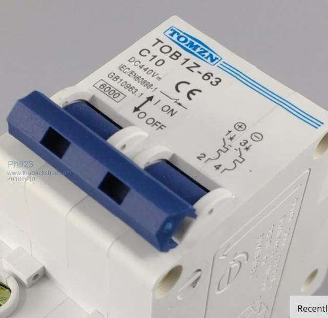

Someone mentioned to me that DC breakers have a line & load side so that any arcing is extinguished correctly.
Have a couple of these, but at 10A I feel they may be a bit light.
Can anyone shed light on which is load & supply side.

Hi Phil, read this and you will have it sussed.
DC Breaker Wiring
Posted: 07:24am 10 May 2018
They have made it easy. the big arrows on the side shows the direction of flow. so if you wire it PV on the top as they direct it is PV +ve to pin 1.
if you cant do that then follow mikes directions to make it work correctly.
Posted: 10:00pm 10 May 2018
If you go to Ali exp site and read the description it also tells you to feed from the top.
The problem I see is there is no standard way they are manufactured.
Yahoo2, would you put both polarities through the breaker or just positive?
Also if using just one side does that mean it is(in this case) 10A per side, or 10A total for the breaker?
Which leads to another question, IF just connecting positive, could you then use both sides to make a 20A breaker for the pos line?
Posted: 10:14pm 10 May 2018
No you cannot parallel the internal connections as the magnetic's inside will be compromised, so you cannot make it a 20a breaker, it is 10a two conductor, if you require single conductor breakers then they also sell them also in various current ranges.

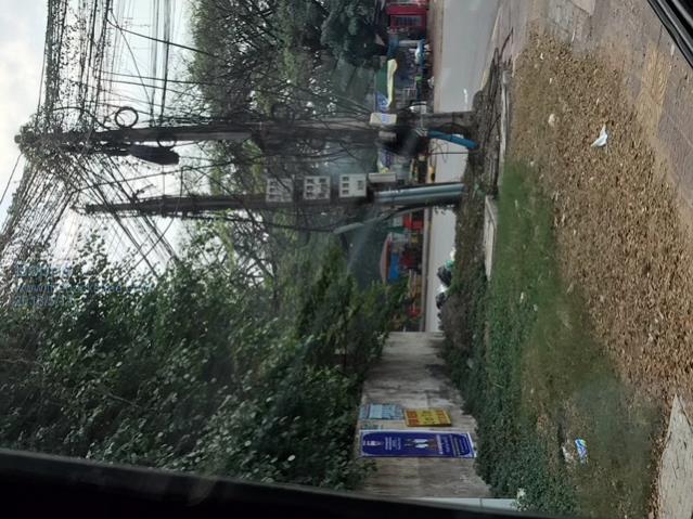

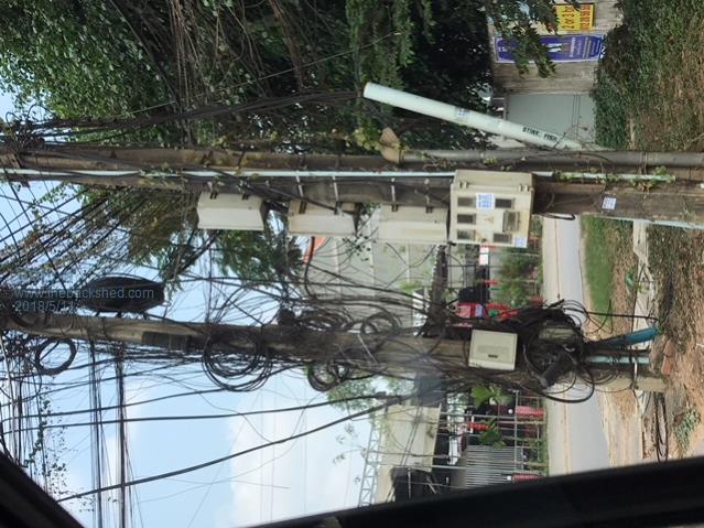

My mum and sister went overseas and stayed in Cambodia for a week, sis sent me these photos of the wiring in the street....
O....K.....
Anyone up for a bit of troubleshooting on THAT ratsnest???
(Sorry you'll have to lay down sideways to view them)Edited by Boppa 2018-05-12
Posted: 08:15am 11 May 2018
Are they are Asian photos. (some will get the joke)
Seems to standard be practice over there to do that, I think most of them would be phone lines.
I have seen a guy climb a steel ladder wearing thongs (on his feet) working a live power line with live wires waving around in the breeze, I had to turn away.Edited by Madness 2018-05-12
