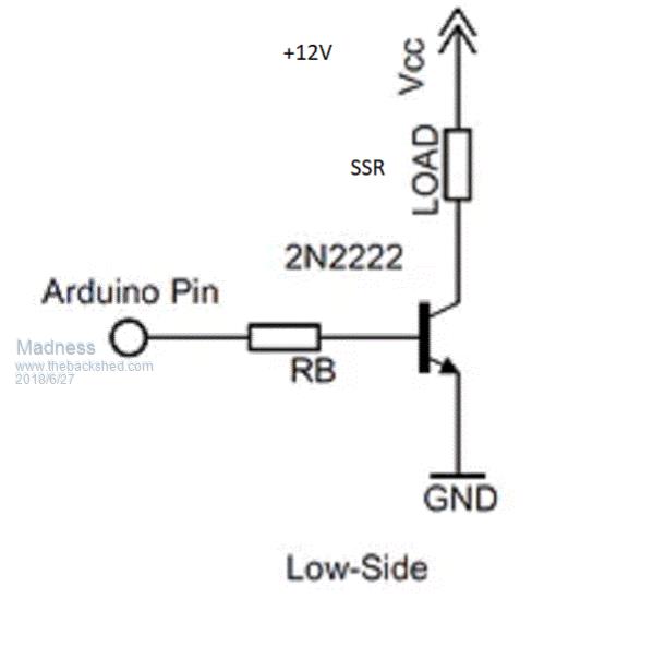

Phil you can drop back the power consumed by the 3.6KW element by putting a motor run capacitor in series with the AC L connection. You will have to play around with values.
The following Arduino code works well with my regulator to divert excess power across to the HWS. The resulting PWM output needs to be stepped up to 12V which can easily be done with a 2n2222 transistor on the low side to drive a 25A AC SSR.
if (vin > (Setpoint - 0.2))
hwval = (hwval + 4);
if (vin < (Setpoint - 0.4))
hwval = (hwval - 14);
hwval = constrain(hwval, 0, 255);
analogWrite (PWMHW, hwval);
