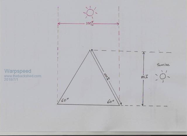

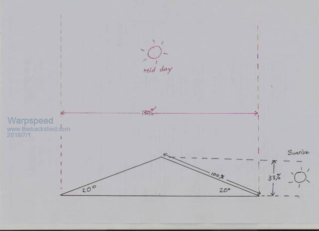

Posted: 09:03am 01 Jul 2018
  renewableMark said
So basically when the summer sun is directly above and each East/West side collects at the same time, but not at optimum angle just as a rough guide how much do you de rate them?
Warp, I've seen your panel angle, they are waaaaay steeper than mine.
Yes way steeper, but its the optimum angle for getting a very flat power output throughout the whole day.
This diagram is a bit Mickey Mouse, but with sixty degree elevated panels, the sun never "sees" less than about 85% of the full area of one panel. Output is pretty constant once the sun is above the horizon.
Twenty degree elevated panels are going to look more like this.
There will be a massive mid day power peak, tapering off fairly quickly as the sun angle reduces.
This is all as rough as guts, but a quick and dirty sketch can tell you a lot.

You forgot to put a smiley face on the sun Tony.
Jeez, when you actually put it on paper at look at it side on you can really see the difference.

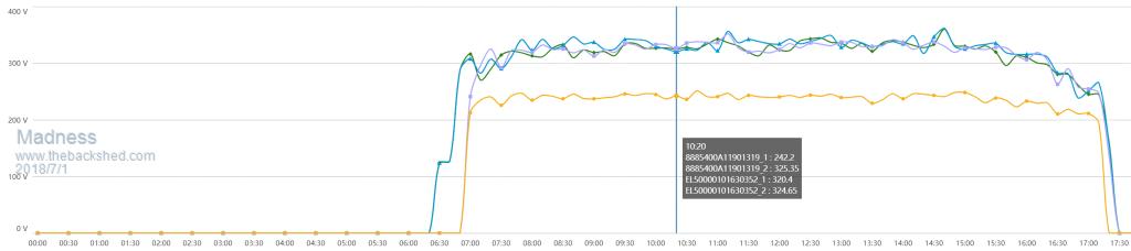

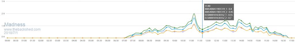

Posted: 10:44am 01 Jul 2018
The angle of the sun on the panels makes little difference to the voltage. Here is the voltages for today from my 2 GTI's, it was cloudy and the regulator has not had any effect on this. The blue and green are identical arrays, the mauve is the same panels and number also but in a different position and the yellow is different panels. The voltage changed very little all day from before dawn to after sunset. It was overcast all day but some periods the cloud was much thinner than others.
This the current, the MPPT keeps the voltage fairly stable and the amps vary.

Fascinating stuff Mad, looks like doing proper research and checking your system really is critical for peak performance.

This is an excellent demonstration of why a very simple constant voltage controller can give almost the same results as a fancy software perturb and observe MPPT controller.

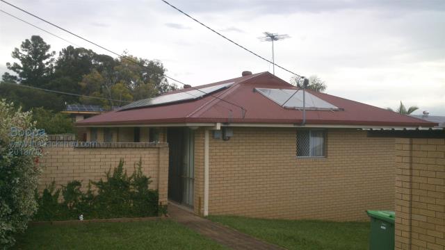

With an east/west split, you really need either two separate controllers, or a dual mppt controller
We have a east west split, I was very dubious to begin with, but it is surprisingly effecient, in fact I compared it to a neighbours system, which is identical except all north facing, same number of panels, same brand controller, ours starts generating much earlier in the morning than his (thanks to the east facing panels, develops slightly less (about 0.8kw at midday), but develops much later after his has dropped right off.
In fact, by switching to the daily generated kwhrs menu on both, as noted same number/brand of panels, same gti inverter, about three houses apart, the east/west split actually develops more kw/hrs a day than the pure north facer, even though its midday peak is slightly less

Boppa what angle the panels at and what is latitude roughly? With dual MPPT GTI you can use that method and increase the number of panels as each channel usually has a rating greater than 50% of the Inverters total capacity. However I am not talking about doubling the number of panels as was suggested somewhere.

Joined: 08/11/2016
Posts: 816
Posted: 04:54am 02 Jul 2018
Brisbane, fairly shallow- maybe about 20 deg?- I did have a pic of them on a thread here somewhere...
(I'm in nsw atm, so cant take another pic until I get home at the end of the week)
