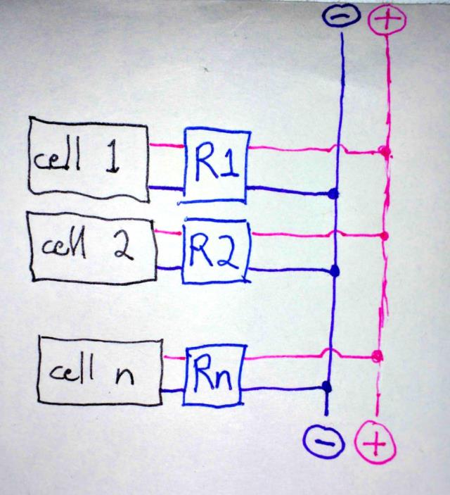

john61ct
Joined: 07/02/2019
Posts: 27
Posted: 04:41am 09 Feb 2019
Probably not a schematic, but shows the wiring layout well enough?
john61ct
Joined: 07/02/2019
Posts: 27
Posted: 05:47am 09 Feb 2019
Description of possible states
"Relay open" means cell isolated, relay closed means cell connected to charge buss.
Voltage sensed on both cell side and buss. No voltage or delay numbers are hard-coded, profile customizable by user.
0. If no power to regulator or regulator fails: relay opens, aka relay is NO, normally open.
Below states, regulator is powered and functioning
1. Relay open or closed, if cell voltage not between 2.95 and 3.48V, OR charge buss / circuit voltage not between 2.95 and 3.55V: relay opens (remains open).
2. Relay open, charge buss voltage between 2.95 and 3.55V, and cell voltage between 2.95 and 3.49: relay closes for a minimum of 3min.
3. Relay closed, remains closed as long as circuit voltage is between 2.95 and 3.48V.
4. Relay closed, opens isolating cell for a minimum of 3min if circuit voltage reaches 3.49V.
5. Relay open, if cell voltage drops to 3.40, then relay closes and charging resumes for a minimum of 3min
Repeat 3-5 loop, until cell remains at rest at or above 3.41V

The schematic you drew is good work in the positive direction - now we need to add:
i. a blackbox or two that controls the relays. So the relays have atleast 3 inputs: the ground, the main bus voltage and the coil activation signal. you want to draw some blackboxes that manage the coil activation signal. Mention the threshold voltages on those boxes
ii. what happens if the blackbox fails to do what it should do? could that damage the batteries? think of a way to handle that situation and update the schematic
john61ct
Joined: 07/02/2019
Posts: 27
Posted: 10:36pm 12 Feb 2019
I literally stumbled over that chip randomly googling around! I have nothing invested in following one path over another
So my answer is Yes, no either / or, just yes
the guiding factor should be how to accomplish the objectives I've laid out, although learning for its own sake is always good too, need limiting scope to work toward specific goals.
So Yes to learning / playing, as long as it is in line with the goals and doesn't cost too much of the budget
Can you explain why the ESP32 would be "overly complicated"? Do you mean compared to another Arduino platform? or just compared to only cell-level controls?
I always thought a centralized top-down controller would be needed, whether rPi, Arduino, PLC or whatever, only sensors and relay at the cell-level.
Remember the setpoints, both voltage targets & delay timers, need to be user-adjustable from one session to the next, I can only see that being relatively easy if centralized.
> i. a blackbox or two that controls the relays. So the relays have at least 3 inputs: the ground, the main bus voltage and the coil activation signal. you want to draw some blackboxes that manage the coil activation signal. Mention the threshold voltages on those boxes
I thought the central controller (Arduino?) sends out the signals to open / close the relays based on the voltage sensing?
Sorry I just do not know what missing or added functionality requires these "black boxes".
And wouldn't the "threshold voltage" be determined by the cell-level relays? So finding / choosing those would be an immediate priority I would think, and perhaps a pretty big challenge.
I mentioned "normally open" above, which means cell are fully isolated at rest. Not sure if that also means failure mode is open, I've heard of contactors getting "welded" closed? Correct me if I'm wrong, but I'd think it's a per-cell cost factor, the rated "under load" ampacity and cycle lifetime of the relay, cost / benefit as opposed to a (hopefully rare) cell replacement?
Assuming small cell sizes like 20-30Ah and gentle C rate like .5C, we'd need contactors designed to open / close with say 10-20A currents per cell.
I think that type of relay failure event would be detected as over-voltage at the cell?
Handling it could be addressed in the "optional or Level 2 stage" design, when the logic for shutting down the upstream whole-bank charge source is addressed.
Now that I think of it, current control could be a major issue, and not just the limitation of the relays, but for longevity, not stressing cells like EV service levels.
The upstream power supply can be "offering" a certain overall current level, say 200A for 16 cells. But as each cell hits the target relay-open voltage,
fewer cells being online means each can accept a higher current rate, with a third open, C rate will increase by 50%, under half left online we'd be getting over 1C current rates!
Have to think about that. . .

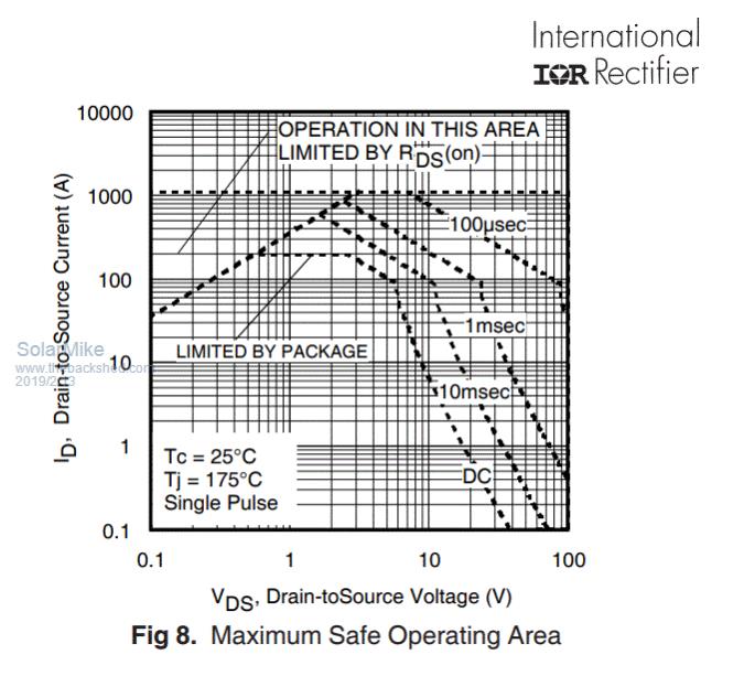

Hi, I will make a couple of design comments here to guide you a little, if you are adding Lifepo4 batteries to be charged in an ad-hoc manner across the common charge bus and they have dis-similar states of charge, then the flattest battery will attempt to consume ALL the current you can throw at it.
So each battery must have its own current limiter to meet your spec, 0.5C is quite high, unless there is a very good reason to charge at that level I would reduce this to 0.2C to prevent undue heating of the cell.
So each "black box" circuit would contain a current limiter, and output a cell voltage for measurement by a master CPU, that in turn would scan all batteries as they were connected to your charge bus and instruct the "Black Box" to isolate its battery when state of charge spec set points reached.
As individual charge currents are not too high you could get away with using a heat-sinked current limiting power mosfet or transistor operating in linear mode, this will simplify your design a little.
Mike
Exactly Mike. My current concerns with the project is the following:
1. We are both inexperienced with MOSFETs. I understand operating MOSFETs in the linear region but the Chinese HY4008 are really not meant to be operated in the linear region from what I can see. Neither are any of the power FETs that are designed to be operated in the saturated/active region. I see both of us blowing a few power FETs, but I don't know what to start with. I am conflicted between IRF510 and IRF640 because they are built better than HY4008. I think
2. I can envision a very simple design with TL431 and comparators. No uC needed
3. However, ESP32 is really cool and since the OP does not have practical electronics experience, debugging code could be easier than debugging analog electronics
I am giving this a few thoughts between classes and look forward to all your opinion on this.
My next step would be to design a higher level diagram (HLD) with the OP. He knows what needs to be done next and I will help him along the way.
Solar Mike
Joined: 08/02/2015
Posts: 1255
Posted: 10:18am 13 Feb 2019
Look at the data sheet specs for the Max Safe Operating Area graph, there will be a DC load line, if you limit the voltage across the device to a few volts then currents can be very high, just make sure the voltages and current remain below the line, see example below for an IRPF4468, that I use in my inverters.
