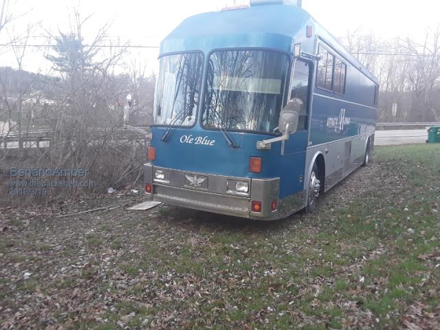

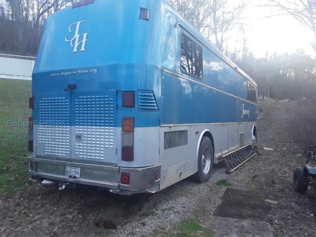

We are putting as many solar panels as we can fit on top
this is the reason why we're building a inverter
Neither one of us has ever installed solar panels on a bus before or anywhere else

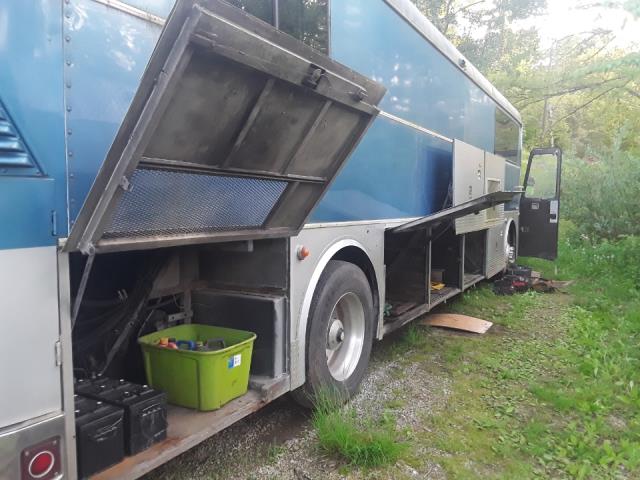

we are currently in the process of taking all four roof-top heat and air units off
more room for solar
the whole top of the bus will be used for solar if anyone close to my location needs them give me a p.m. have all the paperwork for them
would really appreciate any adviceEdited by BenandAmber 2019-03-20

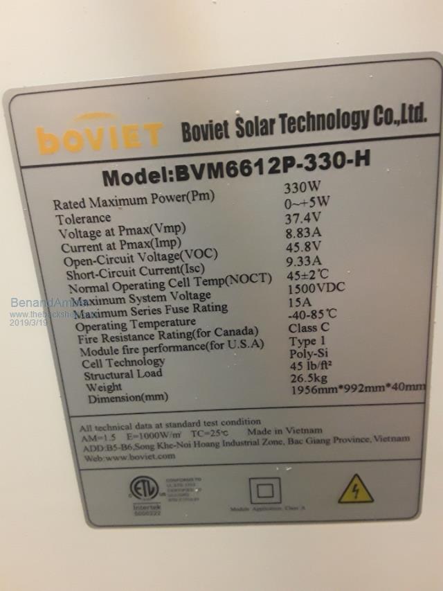

My solar panels are 77 inch Long that is 6 foot 5 inches and 39 inches that is 3 ft 3 inch wide
330 Watt
vmp 37.4
voc 45.8
9.33 amp
maximum system voltage
1500 vdc
cell technology poly-Si

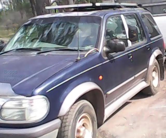

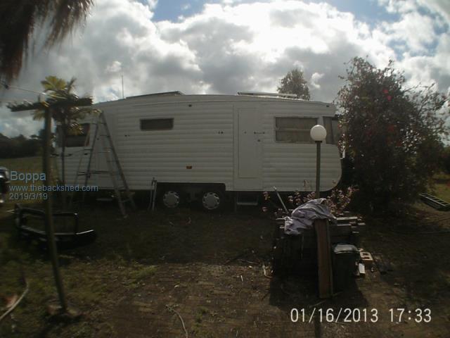

I had panels on the old Explorer on the roofracks, and on the caravan (nearly 2.5kw total, 500 on the exploder and the rest on the van)
They were mounted on ezystruts (having used it extensively in the mining game) with four rails in total down the length, and two cross struts under each set of panels lined up with the mounting holes in the panel frame, all mounted to the structural roof supports on the frame of the caravan (ezystrut is marvelous for this kind of thing- its a grownups mechano set lol, literally hundreds of brackets etc to make anything you want quickly and easily)
The four long rails (actually in hindsight it was massively overengineered and I could have used two) were spaced about 4 inches above the roof of the van, this gave the added advantage of having an airspace under the panels to keep them cool, and also dropped the interior temperature in the van markedly (it was originally only so I could open the roof ventilation hatches)
One thing I found with both the van and the exploders panels was to put a sloping 'wind deflector' between the panel and the roof if not mounted directly to the bodywork- unless they are flat or slightly nose down on the panels (to the direction of travel) the wind will get under them and they will try to 'take off'- acting like a planes wing, the deflector will stop this
The exploder panels actually bent the edges of the panel where the 1" washers were due to this, the panels will handle the wind pressing them down onto the cross struts with no issues, but lifting up, all the force was concentrated on the factory four mounting holes and bent the frame (due to the back of the exploder sitting tail down when heavily loaded and wind blast from a semi going the other way, with both of us doing 100)

This was before the semi incident, afterwards it had a 45 degree checkerplate panel fitted to that front edge between the roof and the leading edge of the panel

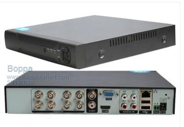

If you want to use multiple cameras split screen you need a multiplexer, or an alternative is to buy a multichannel home security video system (which has the advantage of you can use it as a security system when you are away from the RV!)
Many are 12vdc powered and can be set up to display one, some or all to a video outlet, and even have motion sensing and email alerts if you have a mobile cellular dongle on board the RV
Say you use one like this (this is the actual model I have in the house)
and have the reverse cameras on 1 plus 2, and 'security' cameras on 3-8 (say one on each corner looking down each side and one on the entry door to the rv). You would output the composite video out of the DVR to your stereos video in, and could easily have just one camera, two, 4 or all 8 appear on its screen and/or use a seperate monitor and use the HDMI output to it- or both at the same time... You could also hook one output to your tv in the RV and see who is knocking on the door just by using the tv remote to switch to the camera lol, I have this set up as well- as a video 'peephole' with a small reversing camera monitor, which can be viewed from the shed or the front door
Leave ch1 and ch2 up on the dvr screen and whenever your stereo selects the 'reverse camera' position (usually done by a wire from the stereo to the reverse light circuit) it will bring the 1 + 2 camera view up on the stereos display
Bonus, you now have all round security cameras monitoring the RV for breakins/ vandalism which on most models can be set up for selectable area motion sensing (basically you have a 'grid' on each camera view that you can select it to trigger or ignore any movement/changes in that specific part of the grid, and it doesnt have to be on the display screen to be active either) and use it to trigger an alarm siren, external lights or take a 'photo' and either store it locally on a thumb drive (helpful hint- dont leave the thumbdrive directly in the back of the DVR, put it on an extension cable and have it away from the DVR (mines in the roof LOL), that way if a crook looks for and steals the DVR to hide their identity, they will unplug all the cables and take the DVR, leaving behind the thumbdrive with their pictures on it LOL) or email it to an account every time it is triggered and you have cell phone access
Rather than buying a 'house security package' I would for an RV just buy the dvr (under a hundred) and use the typical 'illuminated reverse cameras', they are much cheaper than home security cameras and do just as good a job imho (do get high res ones though, as in both home security and reverse cameras there are a range of resolutions available, and cost isn't always a guarantee of high resolution)

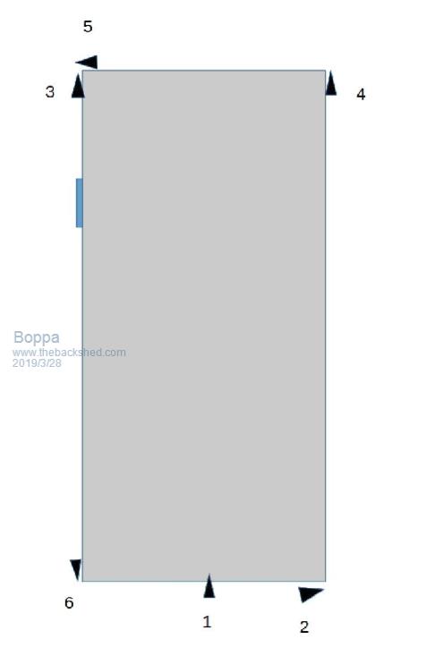

Boppa
Joined: 08/11/2016
Posts: 816
Posted: 03:30am 28 Mar 2019
As an example
With the camera at the 'point of the triangle and looking towards the base (this would be for an Australian RV with the entry door in blue on the left and the front up the top, reverse left to right for US)
ch1 is reversing
ch2 is overtaking
ch3 is lane monitor farside, door monitor
ch4 is lane monitor nearside
ch5 is windscreen breakin/ security
ch6 is security
leaving two spares for extra monitoring, either more externals or internals
This gives 360 degree external coverage on the RV plus a reversing camera, all selectable viewing as either one or more on the monitor(s)
Actually I personally would put 7 as a mirror of 6 and 8 as a mirror of 5
