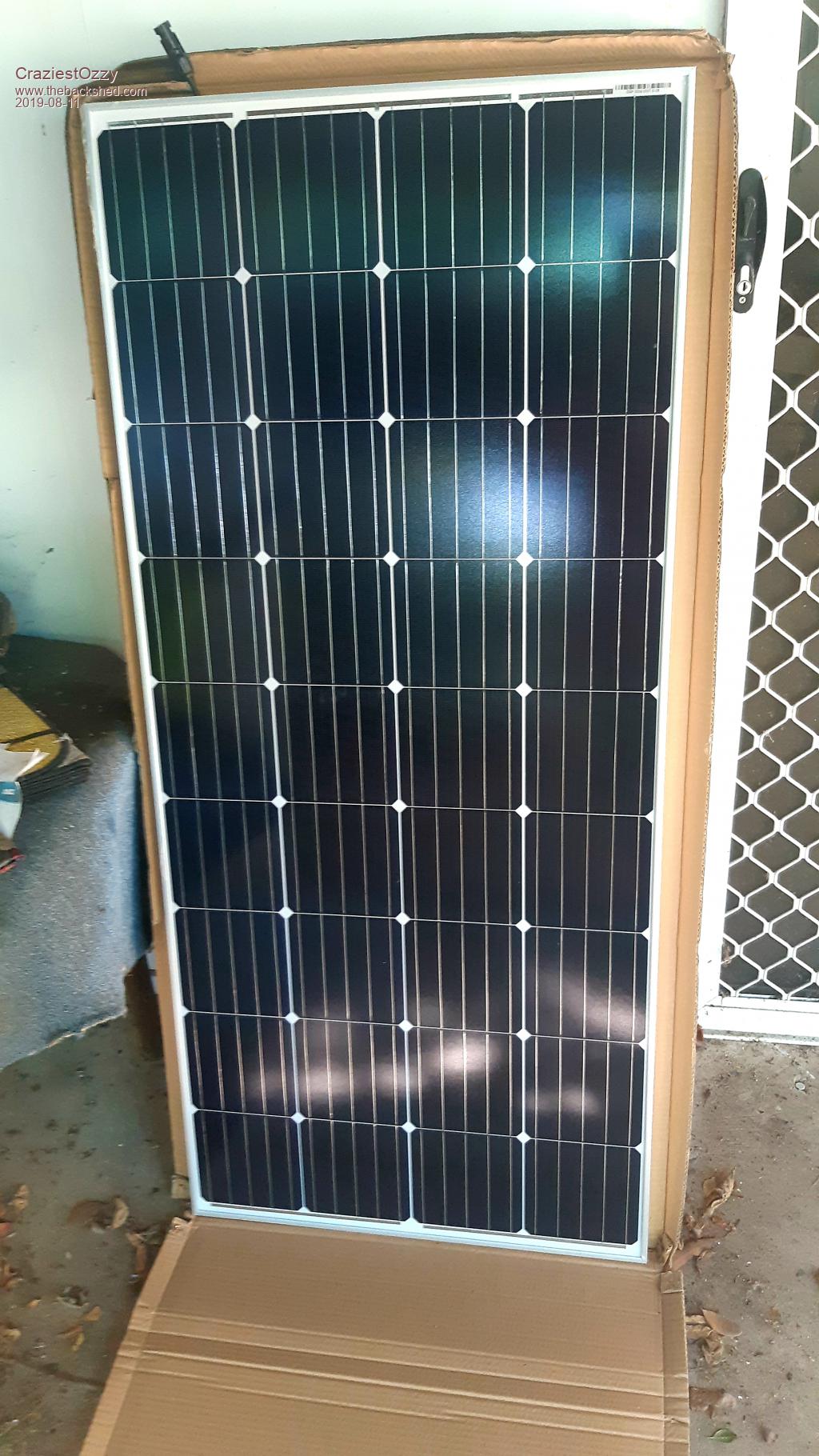

I measured the canopy of my ute and had a rough idea how wide and long, my solar panels had to be.
I also had a rough idea, that a 1000w was an ideal figure for the amount of juice I wanted to produce.
Basic stuff, but a good way to start.
I also wanted 12v DC panels, cheaper to get stuff that runs on 12v and a lot more variety that runs on 12v.
I had from the outset, an idea of avoiding a 240v AC inverter...yet to see if it's possible.
I was very aware, of the issue of using 12v and the super fat and expensive cables I might need later down the track, as amperage production icreases.
So armed with the total dimensional area I had to work with, the total power output I wanted and voltage output, I got looking.
Make a long story short, I sourced four 12v DC panels.
Actual testing produces 200w per panel (advertised at 250w), fairly happy with at least 800w on my car roof with panels tested under a Winter sun.
Have four of these mono panels, to somehow fit on my ute's canopy.

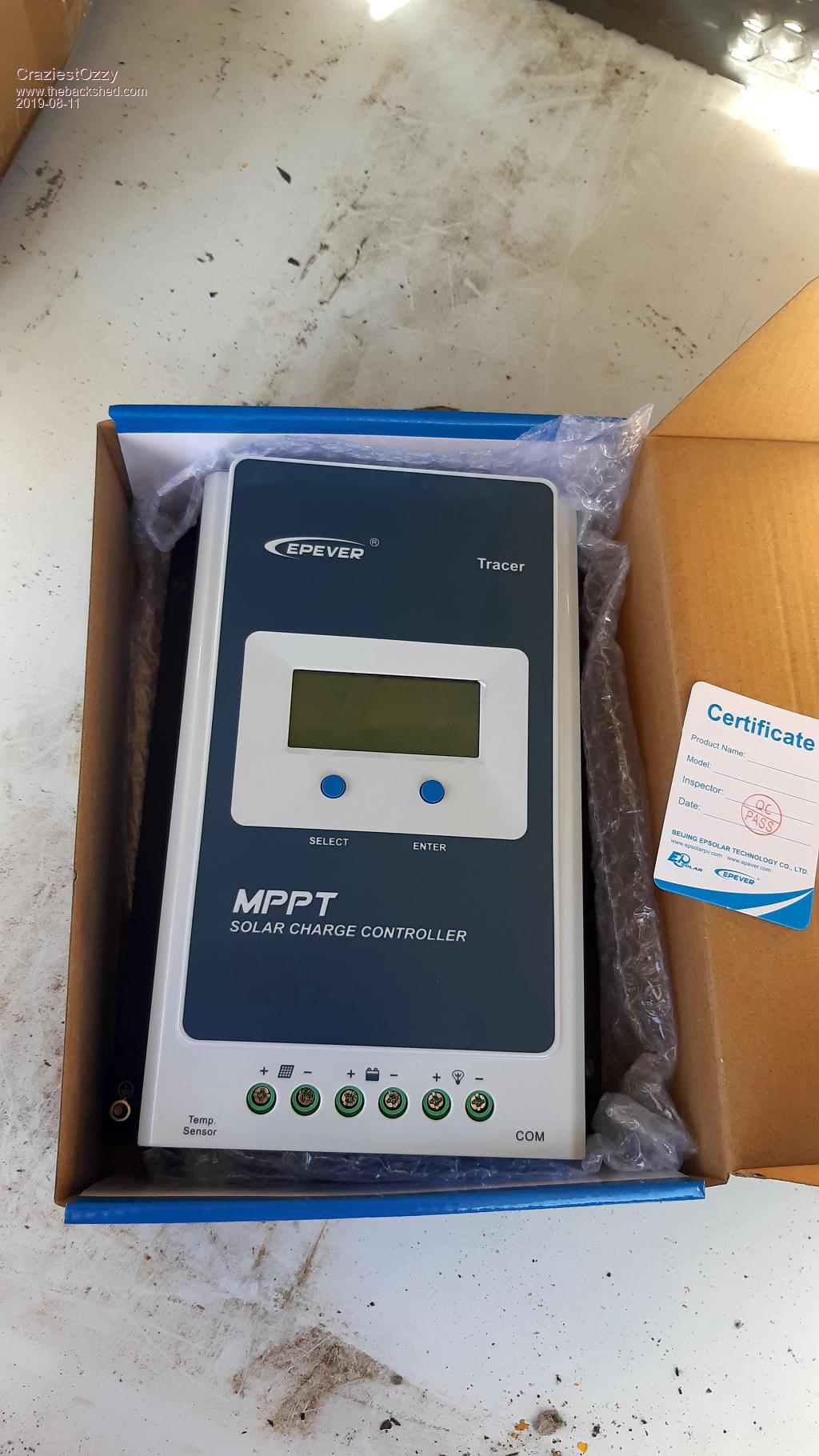

Having decided on and brought the panels, there was a choice of using PWM or MPPT to get power from the panels, safely into the batteries.
MPPT in my view, did a better job...and a few U-Tube vids "educated" me in their efficiency and relative low loss.
Crikies, these MPPT's are expensive.
ChinaBay and free postage helps me again.
Rather than get one large and super expensive MPPT controller,
capable of handling a lot of amperage (60 amps with no safety margin) being fed by four solar panels
and super fat expensive wires...decided on getting one MPPT for each panel.
Now that was even more expensive!
Each panel was rated around 15amps and so I doubled the current rating to 30amps required for an MPPT controller.
Like to have a safety margin as a buffer against overly fudged product specifications and some leg room for the controller not to get overworked.
Likely not as efficient using four MPPT's versus the one MPPT...but reckon loss will be a minimum and will be unnoticed by me.
My reasoning in getting four MPPT's, I don't like relying on one device to do a critical job.
Don't like spending a lot of money either, on one device that could fail.
If that one device stuffs up, I am stuffed too with no back-up for when I am out the Black Stump.
Another reason for getting four MPPT's...
I can get away with using two panels connected in parallel to one MPPT.
I dont think these panels are capable of spitting out anymore than 10amps.
I will have to check panels again in Summer, for when Sun is directly over head.
So thats 20a combined into a 30a MPPT.
After some research and looking at reviews everwhere on the WWW,
I decided on getting four Epever Tracer MPPT controllers.
Be aware there are Chinese fakes and copies of Chinese products...do some research and look at reviews left on the WWW.
Do your homework on a China made product and ensure you get the most recent uptodate product.

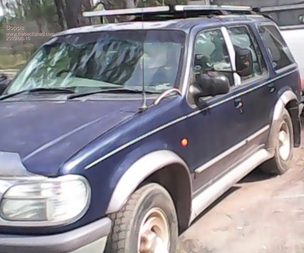

I had two 270w panels on the old exploder, and I was surprised that flat mounting them didn't lose as much as I thought I would (originally they were designed to be easily tilted, in practice, it turned out that the gain wasn't worth the bother- and in overcast the flat mount actually works better anyway)
They easily made 35A into 12v in summer, kept the fridge running, let me boil the kettle or run the microwave even (got a ridiculously oversized 8kw 12v inverter- I originally went for a 3600w, but it failed and the importer didn't have any more, so gave me this one as a replacement- I ended up getting it for about $200 under what it was worth, because I wanted a replacement lol)
These days they just live in the back of the Hilux, as I simply don't trust the fiberglass canopy to take the strain, the steel roof on the exploder had visible deformation around the front support posts from windblast from semi's adnd until I get me welder out of the storage shed (typically- it's almost right at the back...) I cant weld up a frame for them

Thats one hell of an inverter lol
Cool reading your issue with windblast.
Seen horror stories of people losing panels on their roof from it.

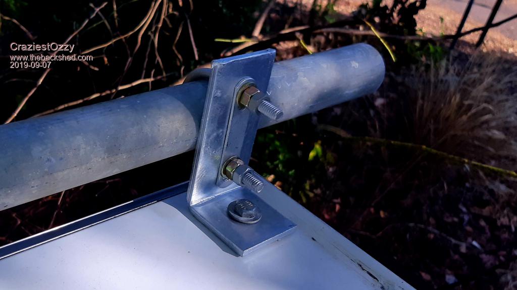

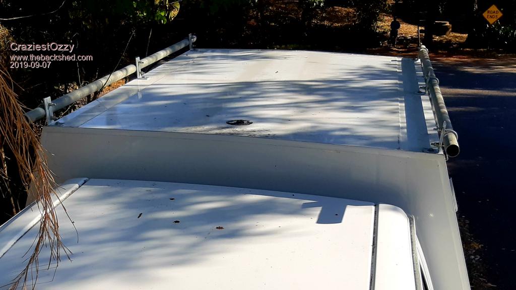

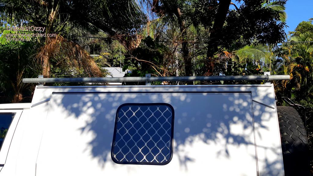

Getting there with the main base supporting frame.
Took awhile as I figured the best way to do it with parts freely available.
Six "L" brackets, holding 32mm x 2400mm lengths of galvanised steel tube
that is normally used for mesh fencing.
Three brackets either side of roof, for mounting security and strength.
Pictures show how it is all done.
Not seen are the 40mm reinforcing plate washers,
inside the cabin underneath each "L" bracket.
Keeping it simple and cheap, allowing for a weld free
and a strong construction with room for future mods to frame.
I used high tensile stainless steel bolts/nuts,
with an additional nut to each bolt acting as a lock nut rather than use a spring washer.
Next step is to add the front and back steel tube to the frame,
held at the joins by typical fence pole clamps.

I didn't have many issues, it was just two pieces of angle running from front to back and bolted to the panels, at the front 'posts' above the front seats was hinged and bolted to the two roofracks (they had a thumb screw system of attaching to to the roof rails so easily unscrewed and tilted) but in practice, there was so little gained that I rarely actually tilted them after he first few months...
One mod I did after that photo was taken was added a 'skirt' from the front of the panel at 45deg down to the roof so that windblast couldn't get under the panels and lift them
Didn't have any rubber mounts or anything, did over 100000km with them on over about 4 years with lots of offroad from gravel tracks (corrugations) to LOTS of beach driving (you can see the etching above the windscreen from sand) I likes me beach fishing LOL
The panels are actually tougher than many give them credit for
