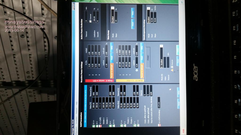

Thought I would put this up for anyone wanting to modify there 3 - 5 kw aurora inverter setting.. warning, as the program will tell you, you can mess with important settings,  so be careful.... or don't touch it.

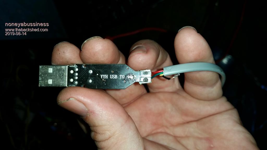

Anyhoo, first step is adapter,  i have had issues with the internal usb connection,  finicky at best, with windows 7 and 10. So my suggestion is purchase a cheap rs485 to usb adapter from Ebay ( bout 6 odd bucks) to start and connect as pic ..

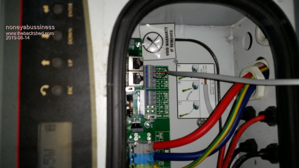

Then to machine, i personally prefer the ground connection as well for safety of your devices connected,  but are not needed as i discovered this arvo... D+ to D+ on machine,  D- to you guessed it D- on machine. ..

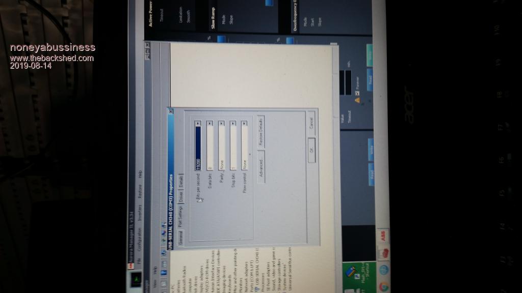

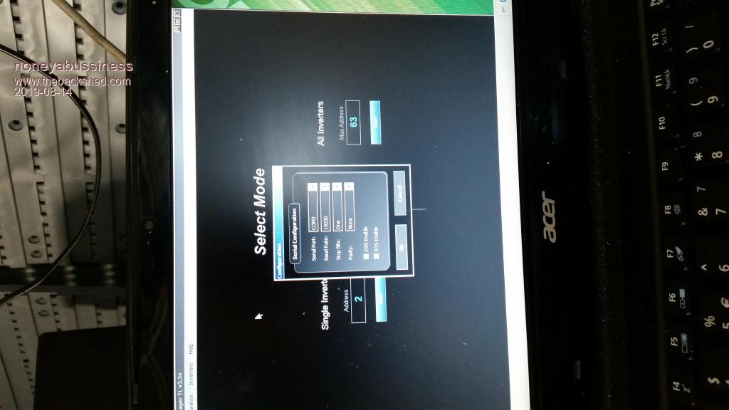

Then go into Aurora Manager TL ( freely download from website or pm me with email address and ill forward to you).. you will be prompted with " login " info and once you passed that setup both driver and application with settings as per pic. Most important is speed at 19200kb
Once you have done that you will be presented with the setup screen, every change needs to be " written " to the inverter.  And just for davo, ive set mine to 280v max and seems to be happy,  let me know how you go..
Not sure what most of the settings are ( didn't someone say don't touch ) but mins and maxs are there and one i personally like is time to reconnect to grid after fault.. mine is set to 5 secs, it does take a little bit longer but heaps quicker than 30 odd seconds  originally. ...

What cable did you use to connect the USB adaptor to the inverter or does it come with it?
Thanks for tips mate!

I cut up an old 4 core telephone cable... but any 2 core wire will do, rs485 is a pretty robust protocol and we aren't doing lightning speeds..
