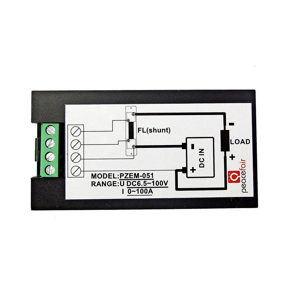

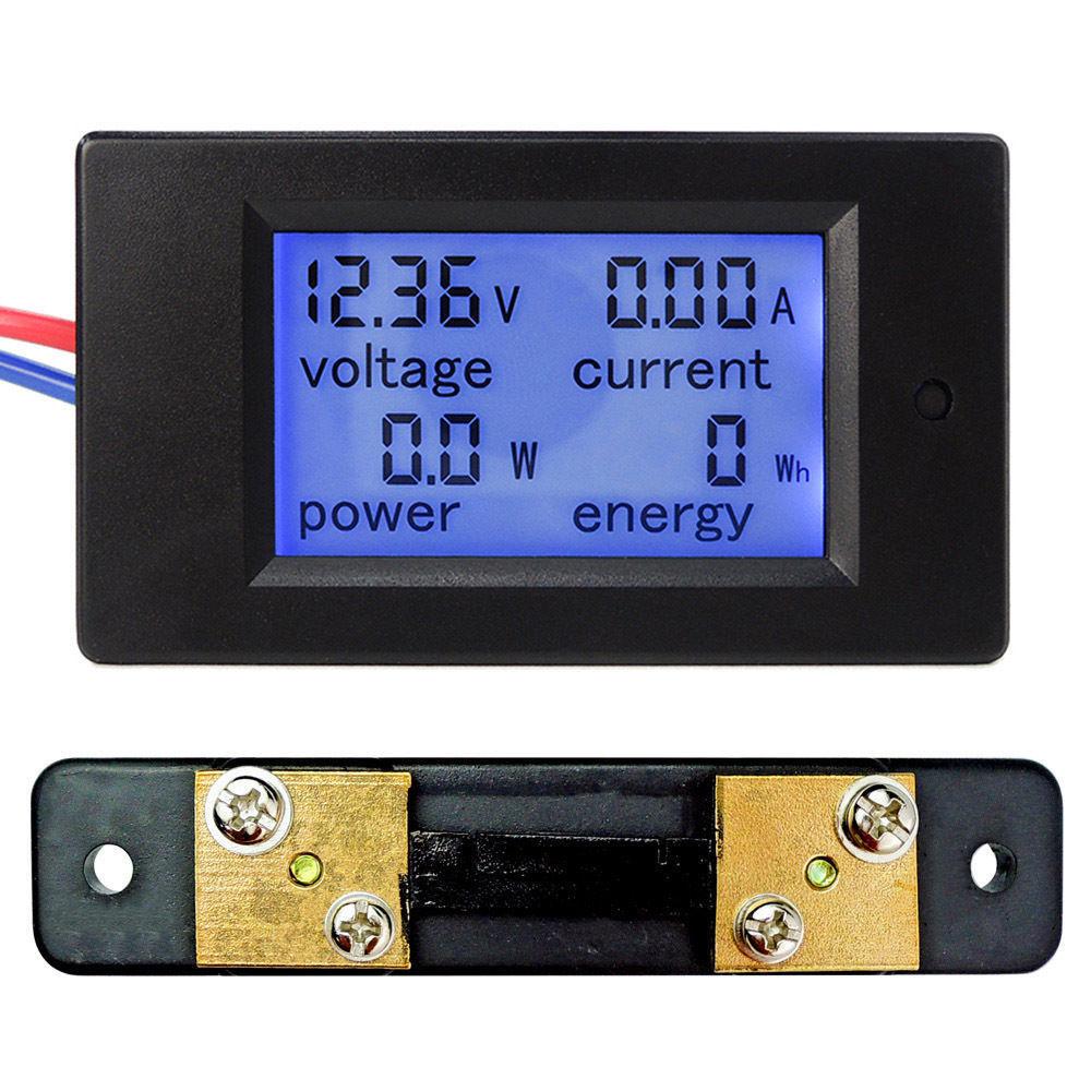

I want to connect to my off-grid PV setup, two of the cheap little 'watt meters' offered by multiple vendors on eBay.
The system is 12V 500W. The 50A watt meters on sale come with a shunt. The diagram on the watt meter shows how to connect it between the battery and the load -- the shunt sits in between on the negative line. So that's one watt meter set up ok, to read power consumption.
The second watt meter I want to read power production. I believe that it should go between the solar charge controller and the battery (but tell me if I'm wrong). So, in this case, where would the shunt go, if anywhere? I'm guessing it also connects into the negative line, between controller and battery? Is that right?

One watt meter goes between the solar charge controller and the battery.
That will tell you what is going INTO the battery.
The other watt meter goes between the battery and the load.
That will tell you what is coming OUT of the battery.

Thanks, Tony. That confirms that the 'production/input' meter does indeed go between charge controller and battery (rather than between the panels and the controller).
The next thing is, since these particular 50A watt meters come with a shunt, will I use the shunt on the negative side between the charge controller and the battery?

The shunt can go either side, and negative side shunt is much more common.
You can use a pair of identical power meters for making both measurements.

I have had a few of those meters for several years both in the AC and DC version.
Haven't failed me yet and I have had one of them on my solar setup for 2 years now.
I find them quite good and nice and easy to read, set/ reset etc.
