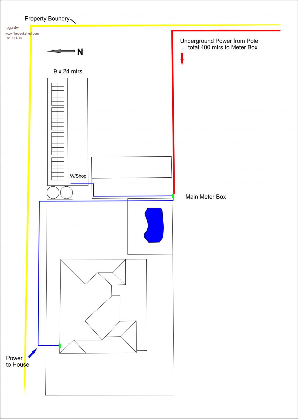

Hi guys,
I found this forum only a few weeks ago while investigating how to get the best value from solar.
After reading lots, I’ve decided I want to build an inverter  …  and buy some used forklift batteries to use for my home. I’m happy to retain the mains as back-up.
As we have no existing solar installation, I have to decide where to start and what to aim for.
I did purchase a second hand 3kW system a couple years ago (still sitting in the shed!)  …  but understand we need a lot more.
On looking at the used market over here (in SAust)  …  I have almost reached the conclusion that I should buy a new, bare bones 6.6kW system  …  approx. $3,500 installed  …
That gets me 6.6kW of brand new panels … with associated rebate and warranty  …  installation  …  and a cheapie 5kW inverter.
…  but  …  how to design a complete system  …  and add in my inverter  ...  and the extra 3kW of panels?
I’ve included a layout of our property as there is some distance between where the panels can fit, the main fuse box and the house fuse box.
Any advice and suggestions would be most welcome. Thank you.
Cheers, Roger
Main Property Layout.pdf

  Quote   I have to decide where to start and what to aim for.
I suppose a  good starting point would be to first of all dig out as many old power bills as you can find, and arrive at some kind of monthly power usage estimate, especially through mid winter.
Next step might be to buy one or more of those low cost energy monitors, and do a complete power audit of every appliance you own. There are bound to be some real surprises, and its highly likely that by changing a few simple things, some very major power savings will be possible without changing any personal usage patterns or lifestyle.
Its always going to end up cheaper to spend a few dollars to reduce your power usage by some percentage, than installing a larger system to cope.
But the biggest advantage of doing all this, is to gain a much greater insight as to where all those kilowatt hours are going, and that helps to get the overall picture and size the individual components of the prospective system.
Cheers,  Tony.

One thing to keep in mind is a grid tied array will net way more power than an off grid array.
Grid tie is pumping at full power non stop.
Off grid only supplies enough to charge the battery in the morning and keep it at float. ALL the rest of the potential energy that could have been harvested is totally wasted.
So if you are allowed to connect a 6.6kw GT array, that will provide you with a hell of a lot of power.
Having that and your 3kw array would make a hefty dent in even winter power bills, summer that should be more than enough for 99% of families.
We use around 10kwh a day, when my system was 10kw of panels it coped just fine 98% of the time.
It got added to so it could still charge ok in cloudy spells.
But most of the time probably 50-80% of it's potential is not harnessed as the battery is at float.
The array is only oversized like that to allow for cloudy spells.(it's now 12kw)
Setting something up off grid you have to have a completely different mind set.
Poida came over one day and said he was astounded at the amount of spares I had, but that's all needed in case something goes wrong.
Setting up your pool on your off grid setup with an Auto transfer switch would be a good way to go.
When/if the off grid setup battery gets low the mains will then kick in and take over.
Cheers Caveman Mark

  renewableMark said  One thing to keep in mind is a grid tied array will net way more power than an off grid array.
Thanks Mark, that is very helpful.
In SA we are limited to 5kWh feed in and are allowed to oversize our arrays  ...  so a 6.6kW array is legit.
That is how I see it too. The part I am uncertain with  ...  is how to combine the two systems.
We could have a standard grid tie system with the 6.6kW of panels running the house.
Then the 3kW setup just running the pool pumps via Tony's suggested treadmill motor idea. Though I doubt that 3kW would be enough to consistently run the two pool pumps without having to switch back and forth to mains on overcast or rainy days.
If we had the 3kW (or more) of panels charging a forklift battery and using an OzInverter or similar to run parts of the property  ...  we'd need to have two separate 240v circuits  ...  which is not all that pratical.
Our night time use is not all that high  ...  so a reasonable size battery could possibly keep the whole place going overnight without having to rely on the mains  ...  but again, how do you combine the two circuits and control the switching over?
That is a very important point. That is where if you have a GT system  ...  that wasted power can be taken advantage of and fed back into the grid to earn you a credit.
I suppose that is what I am trying to get my head around  ...  taking advantage of the GT system with it's ability to absorb extra generated power along with its feed-in credit  ...  as well as have a battery system that largely takes care of the night time power requirements, plus any extra heavy loads during the day when there is still time for the battery to be replenished.
An AC charger off the GT system could also kick in and help top up the battery if need be  ...  and stop that power going back into the grid unnecessarily.
I know  ...  I want my cake and eat it as well!!!
Thanks for the input.
Cheers,  Roger

Warpspeed
Joined: 09/08/2007
Posts: 4406
Posted: 11:18pm 14 Nov 2019
Agree with everything above ^^^ one hundred percent.
I suppose there are two quite different approaches to going solar.
The first might be to reduce power bills as much as possible at the lowest overall cost. That certainly makes sense for retirees.
The motivation there being purely financial, but without an expensive battery that leaves you vulnerable to total loss of power in the event of grid blackout.
Just get a commercial grid tie system professionally installed and be done.
Going entirely off grid is going to be expensive any way you go about it, and never financially viable where grid power is available.
But it will give you complete independence and peace of mind. And it can also be fun and a great personal challenge, and that in itself can be very rewarding in a personal sense.
  Quote  From your experience Tony, what do you envision would be needed as far as number of panels/wattage to cover just the pump motors  ...  without any sort of electronics as you suggested? Thanks.
I have never done anything like this myself, I don't even have a pool, but this is how I would go about it.
Most of the larger treadmill motors are rated 2.5Hp at 180 volts dc, and typically ten amps at 4,500 rpm, all as listed on the rating sticker.
Just because it says 2.5Hp does not mean you have to load it up to that much.
The motor on the filter pump will also have a rating plate that might say 1.5Hp at 2800 rpm or thereabouts.
So my first guess for a pulley ratio would be to run both motors at their design speeds with a 1.6 pulley ratio, this may need to later be changed. Try to keep the pulley diameters reasonably large for best mechanical efficiency, and you can run a looser belt without fear of belt slip.
At 4,500 rpm and 180 volts the 2.5Hp motor is only going to be loaded with 1.5Hp, so the current will be less. Probably in the region of 1.5/2.5 x 10 amps perhaps six amps. If the max power voltage per solar panel is 30v then six panels in series would produce 180v and at only six amps loading 180 watt to 200 watt panels might be about right.
If the panels are larger say 250 watts you could probably get away with only five in series (150 volts) run the motor slower but at a higher load with a slightly lower pulley ratio.
When its all going, the trick will be to change the pulley ratio so that the solar panels are working near their peak power voltage.  The motor is plenty powerful enough to run either at a higher rpm with less current, or loaded down more at a higher current, as long as you don't try to exceed the ten amp motor rating.
Ten amps at 30v would imply three hundred watt panels. That would be possible, but smaller panels and a higher voltage (at less current) would be easier on the motor.
A bit of experimentation with the pulley ratio might be required, but in the end if you can get the original pump motor running at its rated shaft speed from solar, you have succeeded.
Centrifugal pump drive power rises cubed law with rpm, so even in cloudy weather the pump speed should not fall off in rpm as much as you might expect.
It seems your main goal is to save power bills. The SECOND you buy batteries, any batteries, you are going to INCREASE your Costs. You can use second hand panels, batteries inverters and other things but you WON'T over the life of the components, used or new, come out paying less per KWH with the power you get over buying it from the grid when the grid is available and connected.
By all means add solar to your grid connection, that can be a huge money saver but the second you go down the battery road at this time, you will average out at paying more for your power.
Batteries are like buying a $1000 Bucket that holds .25C worth of water.
  Quote   On looking at the used market over here (in SAust)  …  I have almost reached the conclusion that I should buy a new, bare bones 6.6kW system  …  approx. $3,500 installed  …
I think I was you whom on another thread didn't want to interfere with the mains on a DIY connection? If I have that right, then having a separate system and Inverter would mean another power system and that sounds like a HUGE pain in the arse to run.
You would be MUCH better off with a conventional system.
If you had a 6.6KW system you could expect to get 18-24KWh day out of it in winter and 30-36 Kwh day in summer. From what you are saying that would more than cover your needs and the summer excess would give you a little FIT to offset any winter costs.
Your consumption on the numbers you are giving is not high so a 6.6 System should be plenty for your needs.
  Quote   That gets me 6.6kW of brand new panels … with associated rebate and warranty  …  installation  …  and a cheapie 5kW inverter.
And if you are concerned with approval's and legalities, you are fine there AND, the system will be up and running in a couple of days and you won't be stuffing round getting tired and frustrated and chasing problems. Your payback would be 3-4 Years and you'll be in front.
My suggestion with a lower cost system would be to get decent but not over the top panels but spend more on the inverter. IMHO, they are the weak link.
  Quote   …  but  …  how to design a complete system  …  and add in my inverter  ...  and the extra 3kW of panels?
Get the retail system and all the metering etc set up.  When it's all approved/ inspected. Put the panels of your 3 Kw system up, wire the inverter into a power circuit and you are done. The used inverter will feed power back into the circuits behind the meter and be used by the home. any which isn't will register a credit on the smartarse meter.
The only thing you may want to look at is getting APPROVAL for a 10 KW system if you can. This way if at some time you feed 7.5KW back into the grid they won't get suspect. In reality I doubt they would anyway unless you have a Huge FIT but if you could do it that way you'd be laughing.   That is exactly what I hope to do when they take away my spinny meters.  Get approval for a 10 Kw system, get the smallest legit system I can and then hook up everything I have now back into it. I -may- be even better off than I am now if I got a fit.  I think the rule to be in front is feed back 3-4 times what you use and I'm pretty sure I could do that without much trouble.... Especially if I put up another 5KW on the north side of the roof where I have left space purposefully. I have Pulled over 80kwh a day now, another 5kw would easily give me over 100kwh. Might take some explaining how a 10 Kwh system managed that but anyway.... :0)
  Quote   I’ve included a layout of our property as there is some distance between where the panels can fit, the main fuse box and the house fuse box.
Going to be extra connection fees there for sure but it may be worth crunching the numbers and seeing what sort of Yield an east/ west system on the building where the meter box is would give you. It's probably not going to be much less than the north face over all.
Then install your 3 KW system on the north roof and just plug that into to the building it's on.  Single phase should be ok, If you have 3 phase to the shed you are laughing. You can always overclock the 3 KW system with more panels as well.
Most of mine are double panels to inverter rating and I have had no trouble at all.
They come on early, produce max power for many hours a day not just at midday and then finish late still producing good power till just before sunset.
Thanks for those figures, it helps a lot to understand what is possible
Yep, very good argument.
Nah  ...  couldn't do that.    Besides, we are limited to 5kWh feed-in to the grid. That's why a seperate system looks a bit more attractive to me.
I certainly wouldn't be against putting up additional panels on top of the 6.6 and 3kW  ...  we do have several kW of underfloor heating I could tackle over winter. Putting up a heap of panels as a once off  ...  and building a couple of Tony's simple HWS controllers would run rings around collecting, sawing, stacking wood for our combustion heater  ...  as lovely as it is  ...  and even though we get the wood for free.
We could use the rear of the other shed roof (east)  ...  but the west side is largely taken up by the pool solar collector  ...  and the rest shaded by some big palm trees  ...  which would affect both sides pretty well.
We are on single phase too.
Thanks for all your input and ideas  ...  the more I thrash this out, the sooner I can make some decisions and make it happen.
Cheers,  Roger

Now if I was Davo,    I could install one of those with my forklift batteries  ...  and once it was all commissioned  ...  add my extra panels to make sure it kept up. Probably use one of Madness's charge regulators to limit the additional panels  ...  and let the hybrid inverter maintain the batteries.
Thanks for the info on the ATS  ...  that certainly helps with my understanding.
In fact I spent an hour earlier drawing out a more elaborate ATS/Interlock system that could handle two seperate AC circuits (House and W/Shop)  ...  plus running either one or both off a battery inverter or switching back to the mains  ...  and all being failsafe so there was no way the battery inverter output could feed back into the mains.
As mentioned above, because the workshop, pool pumps, pressure pump wiring all branch off from the main fuse box at the sheds  ...  separating it into two circuits should not be all that difficult for a sparky to do. May still be worth investigating some more.
Thanks again for the suggestions and reminders Mark.
