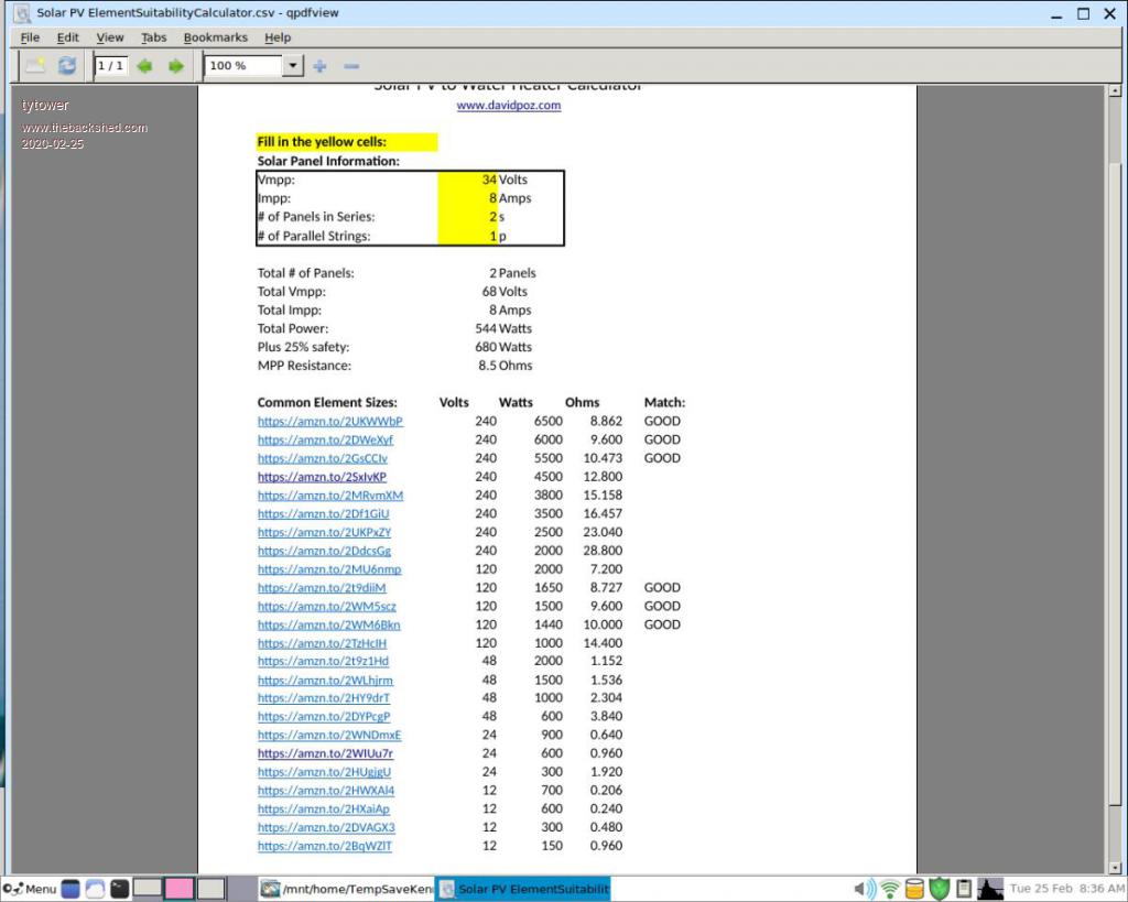

I have used and Modified  The Poz calculator and while it is helpful, I have seen that direct connecting panels  is HIGHLY inefficient up till the point where you have the same wattage PRODUCED by the panels ( not just Nameplate rating) as the element you are driving.
I was playing with this last week and the best I could get by Ohm matching was about 50% of the panels rating. When I connected the same panels back to a grid tie inverter, I got much closer to 90% rating. I would expect the same sort of inefficiency even with a low Voltage element.

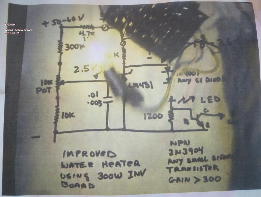

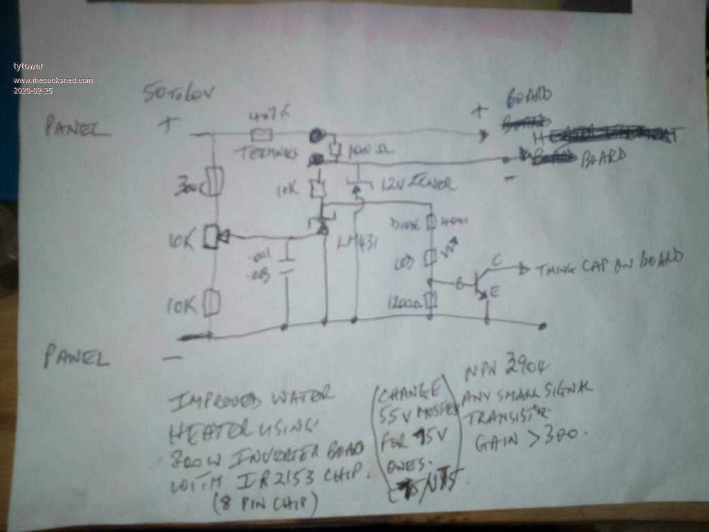

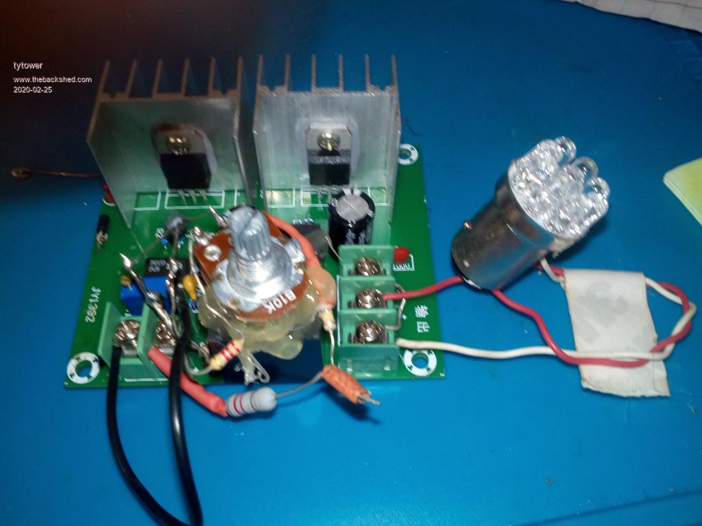

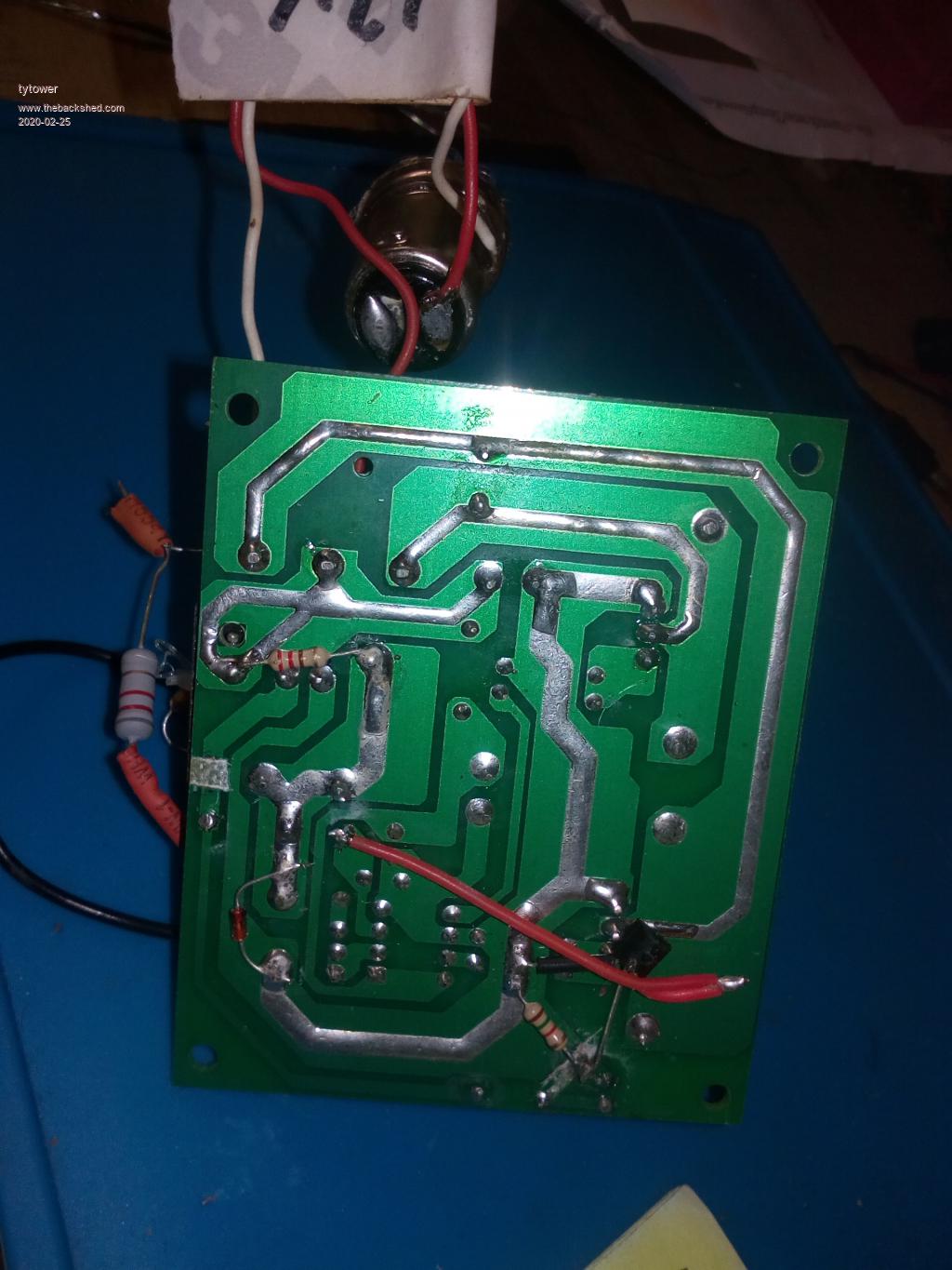

I have the controller based on his Chinese inverter board built and turning the LED on and off and with it the timing capacitor giving a voltage out . He claims to be getting 4 amps out and also another 4 amps from the supercaps . If so 8 amps at 48 Volt or so will do the job admirably.
I have a 48 volt water heater element and I've got 22 unused panels sitting aside the shed waiting for a use . I have another 12 panels feeding the grid and two more running a 100Ah 48 volt Lithium LiFePo4 alloy prismatic bank driving a 2000 watt inverter . (All panels 34Volts and 250 watts so 8 amps available with two in series.)
My batteries are full in a couple of hours each day so I'm looking at putting that excess capacity to work. That's what I was hoping to do here but as you say it seems designed to be confusing because each word he utters is carefully correct but blowed if you can read the circuit diagrams or his pics of the wiring . Here's my circuit I have built .
The LM431 device is easy enough to work out and that is just setting a point at which the timing capacitor on the board will be disengaged. That's his set point . When the battery bank goes below that point the inverter board shuts down and panel voltage goes to the solar controller to feed the batteries.From there though I'm stumped atm .
Where do the supercaps attach . I have the panel attachment points sorted. The caps probably just go across the joined up output but with a 12 Volt zener in there I am only gonna get 12 Volts out I think and that won't run the 48 Volt element. I need 60 to 70 volts coming out.
Anyway let me get the circuit and pics up here and maybe you can comment . I appreciate the effort you have put in to that answer.
Don't know if that is just a description or a misunderstanding but as far as I know they are just regular Capacitors, not super caps which are a different thing.
8 amps at 48V is less than 400W.  How much water you want to heat? It might warm a regular 250L Tank a few degrees but that's about it. To heat 250L of water from 20oC to 60oC in 6 hours you are going to need 2.5Kw input.
Lets say you don't have a cold tank and start at 50oC, that's going to give you a heating power requirement of about a Kw.
As I said, 400W is basicaly useless. I doubt that would even make up the difference between your winter and summer water mains temp difference.
  Quote  two more running a 100Ah 48 volt Lithium LiFePo4 alloy prismatic bank driving a 2000 watt inverter . (All panels 34Volts and 250 watts so 8 amps available with two in series.)My batteries are full in a couple of hours each day so I'm looking at putting that excess capacity to work.
This being the case, what are you actually trying to do here?
Are you trying to heat water or are you trying to build a water heater?
My approach in your position would be to use what you have.
Add more panels to the charger on the inverter. This will ensure that you will have more power longer in the day. As long as the panels are in parallel and not over volting the inverter you can add what you like. The inverter will take what it needs and the rest is irrelevant. If you over clock the charger ( all my GTI's have at least double the panel capacity as the inverter is rated for) it will mean there is more power earlier in the day, the charger/ inverter runs flat out much longer, it will run till later in the day and you will get better power when you need it most on the sh*tty days.
As you have the 2 KW inverter which is going to be a lot more efficient than any cobbled up design the likes of you and I could come up with, use that.
Put the 240V element back in the heater and use a cheap PWM controller to limit the power going in to say- 1500W depending what else you are driving, off the inverter.
You can turn the heater down, off or give it what the inverter is capable of. OR get another inverter/charger and run the heater exclusively off that.
Again, If you have enough panels, load them onto the inverter and use the batterys as a ballast only.
I have done exactly this and it works fine. In my case I was driving a refrigerator and an Urn or Kettle. If you have enough panels, The battery's effectively become ballast and the power is in effect coming direct from the panels when the sun is out.
To automate it, I would use a Voltage sensitive relay Pretty much what I am using. They are on ebay, $10.  Use a Voltage divider and set it up for the 48V battery you are running. Once the voltage drops below what the charger is set at meaning the battery's are being drained, it switches off.
This way you can use a decent amount of power and get a useful amount of power into decent amount of water.
I just wouldn't be bothering with the 48V element. I'm thinking of a couple of ways you could use that but keep coming back to low efficiency and going the inverter/ PWM mode being cheaper, simpler and more efficient.
Now, IF your object is to build a water heater, then I can't really help you with anything in that vid. I couldn't get my head round any of it either and the circuit I was kindly given here and what I came up with myself to me is infinitely easier and will be far more effective. What I was given here was no strings attached and done out of pure good will.
Unfortunately, I think you have already pissed off the people here that could help you with your previous arrogant replies on the design you are working on.
  Quote   That's what I was hoping to do here but as you say it seems designed to be confusing because each word he utters is carefully correct but blowed if you can read the circuit diagrams or his pics of the wiring .
As I said, I believe what he really wants is people asking for his help so he can be passive aggressive and belligerent and make out he is superior.
That is about the limit of my pathetic knowledge on this. I used some snippets of what he is doing and found my own way because that was easier than trying to understand WTF he was doing and describing.

  Davo99 said  Don't know if that is just a description or a misunderstanding but as far as I know they are just regular Capacitors, not super caps which are a different thing.
Well caps are caps .He is using Ultra caps I think . I have some chinese made supercaps and want to use those . I've made up a bank of them same as he uses.
Yeh realise this . It will run in a system that pumps water through a half inch black plastic coil on the roof . The power is for the element but also for the small circulation pump.The other consideration is that putting a transformer on the inverter board output as its meant to be used with pulses out either side of a center tapped transformer would produce 240 Volts and I'm toying with the idea of trying that on a 240 v heater element simply to reduce losses through doing the same via my battery bank and inverter set up . Not much cost to get a transformer for 400Watts.?
  Quote  This being the case, what are you actually trying to do here?
I wondered what you were referring to ,my circuit or another?
  Quote  Unfortunately, I think you have already pissed off the people here that could help you with your previous arrogant replies on the design you are working on.
Yes maybe, but I wasn't getting anywhere until you came in . Incredibly frustrating when you seek answers from smart people and get ramblings from others . No matter how you express yourself someone is always going to dislike it . I have learned to just tell them to piss off and usually their contribution is worthless anyway. Its always pleasantly surprising when someone who actually knows what they are talking about replies.If you think I am arrogant why? Because I tell them to piss off ? Is that arrogance? I think not. The internet is plagued with them ,they age,stop doing things themselves,sit in a chair  and start telling others what to do . Not discussing stuff but telling them what to do . It is a way of communicating for them even though they are sedentiary. Just a waste of talent really . If the admin said "look just confine your posts to something that contributes to the thread , that could all change .
That is about the limit of my pathetic knowledge on this. I used some snippets of what he is doing and found my own way because that was easier than trying to understand WTF he was doing and describing. You are belittling yourself and it does not suit you.nor does it fit with what you post.You are trying t help ...I think.So what parts of his production are you using ?
