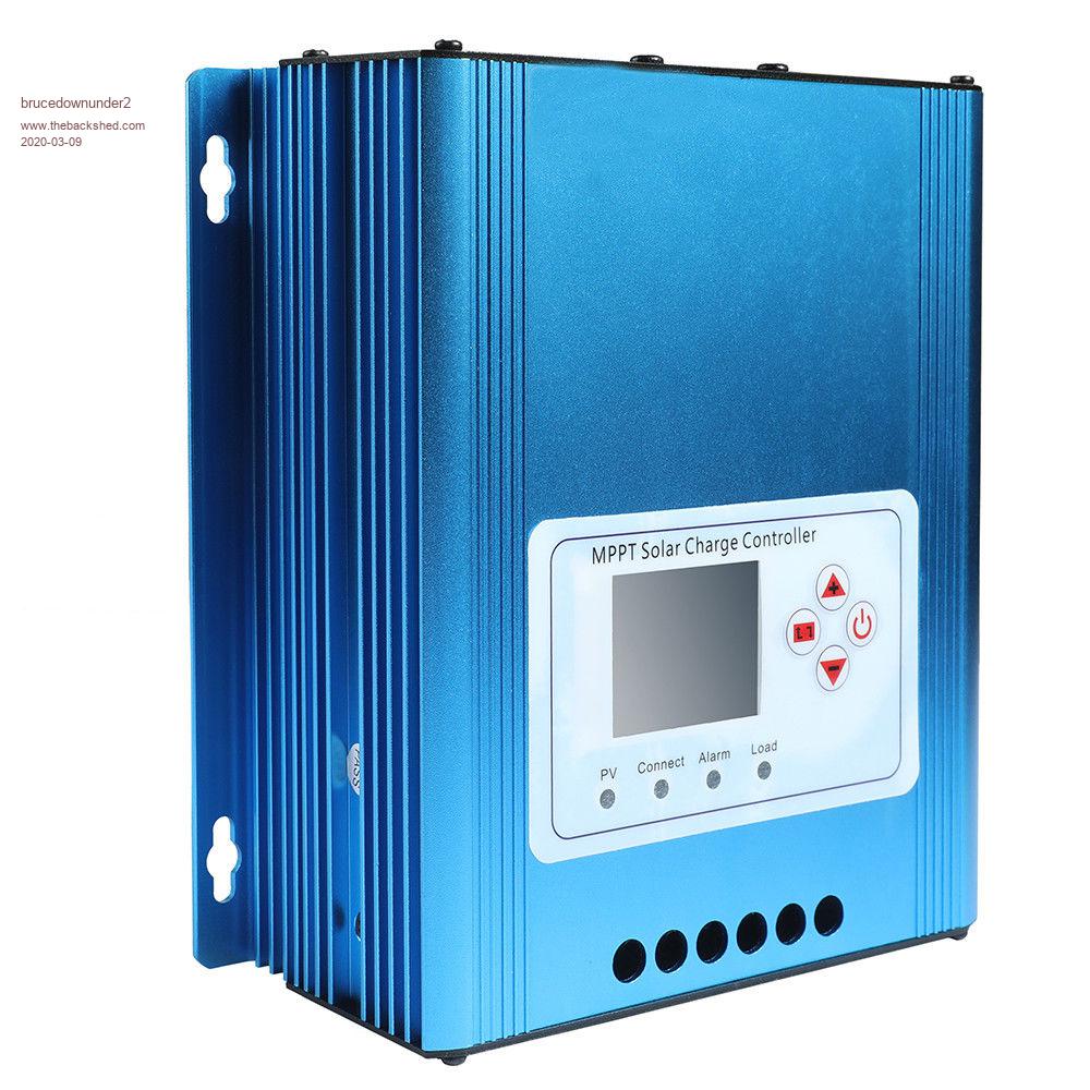

brucedownunder2
Joined: 14/09/2005
Posts: 1548
Posted: 02:07am 09 Mar 2020
This is the "Blue" one .
Bruce

The Blue one as above,Blue one
CPE series controller. not sue if a Wifi dongle is available for it.
Seems to be strong looking unit.

I bought a 100v 30 amp Make Sky Blue controller as a backup to my own controller after seeing Marks dead unit.
Mark was dead unlucky, his crapped out after only two days. There is a very small transformer and a switching power supply that generates multiple isolated dc supply voltages. One of the 12v supplies that supplies isolated gate drive power had failed.
The transformer was dipped in transformer varnish and baked into a solid lump. Impossible to dismantle or repair its so tiny. So the whole thing was unrepairable.
That transformer and the microcontroller are the only two very special parts that cannot be obtained or replaced with a substitute part.  Just about anything else could be repaired somehow, unless the whole thing turns into a total charred mess.
Anyhow, I bought one and it works fine, and is still working very well. The whole thing is built inside a very light gauge aluminum box, and even at low power the internal cooling fan was always going full blast. That is its only real limitation, at full grunt its going to get really hot and probably fail fairly soon because there is nowhere for the heat to go.
So what I did was bolt the whole aluminium box onto a massive "Inspire" heatsink and hang it on the wall. The heatsink sucks the heat right out and now the fan never comes on, and it runs cool to the touch even when running flat out.
After a bit of help in the heatsink department, these work very well, and I would certainly buy another if I ever get around to installing more panels..
