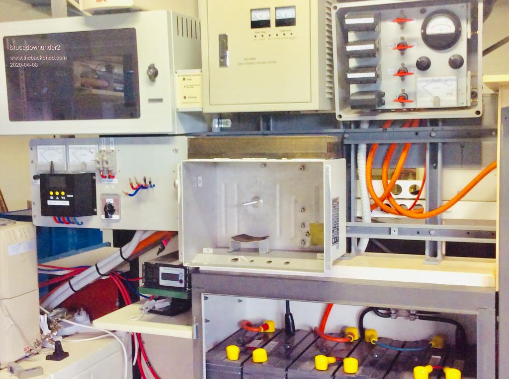

Years ago I dismantled an INSPIRE inverter to rewind the Toridial transformer .
The case is now going to be home to my latest project,a back shed home built inverter.
Aaron ,our mate from this forum ,is the brains ,I,m the metal basher,come roustabout.
The case is solid,stainless and lovely finish. So ,I,m working on positioning a fan hole and a couple other stagetic positions for input,output cables.
The cover ,I might put on hinges, and fix a couple of meters ,switches,breakers, etc.

With those cases, they are a bugger to cut fan holes on, jigsaw blades get destroyed pretty quick and it takes forever.
The easiest way I found was to cut a stop sign shape (octagon) with a fine disc on a angle grinder, just make it a tad smaller than the fan.

Back to the cutting holes,, I agree with you ,that stainless really blunts the old hole saws ,and they are not cheap.
I thought of cutting three ,say, 30mm holes within a circle ,but leave ,say, a 5mm between them for a bit of strength .
Cover them with expanded Al mesh and bolt the fan unit under that.
I'd put a temp and rpm adjuster on the front cover to set it at the best temp and rpm. for noise,Etc.
