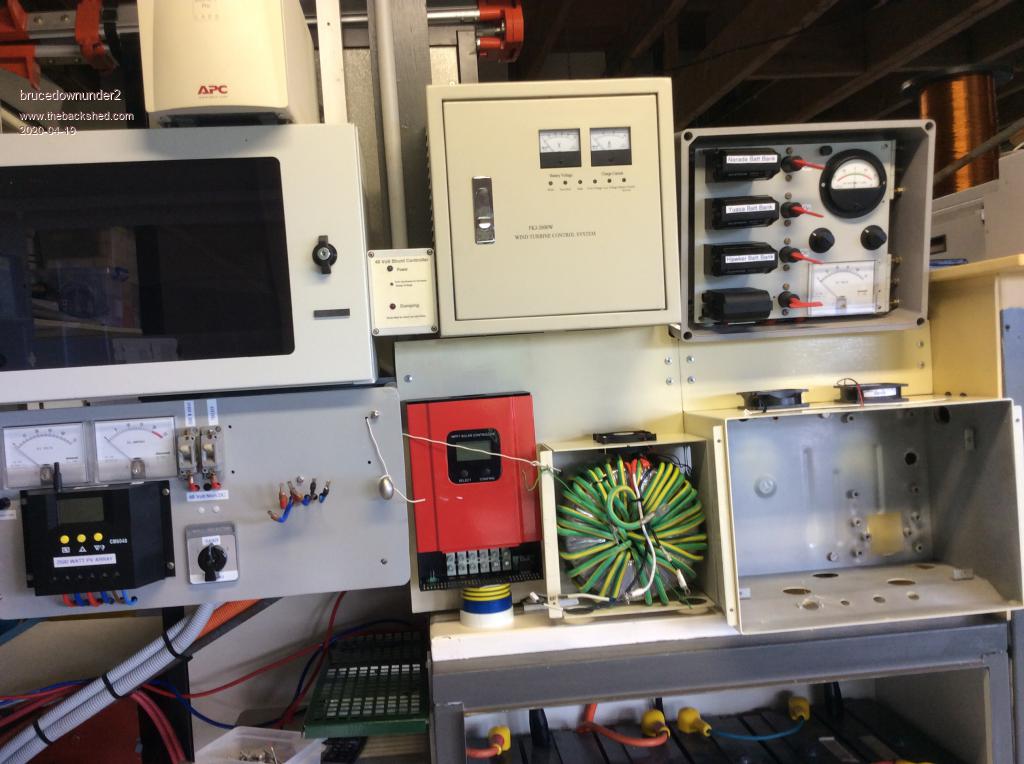

I gutted a "Inspire" grid-tied unit, brand new, years ago to rewind the Torodial transformer in it for my power-hungry "Powerstar W7 " inverter.
Well, it worked fine , until a lightning surge of power blew up the boards-I think?? , never could buy replacement ones..
 Ok, back to this on-going project.
I cut and made use of the case plus another case to hold the big Torodial..  She'll be a tight fit anyhow, so I hope all fits eventually..
Plenty of fans and bottom holes ,covered in mozzie mesh stuff to keep out the critters..
I burnt out two hole saws in the cutting of the stainless steel, tough as hell ,but my hole saws were 20 years old from my rack building days ,so not bad. Bye the way ,before you all start screaming at me ,no lubricant works .Trust me , I've cut ,maybe a thousand holes ,the old asbestos stuff was fairly good ,but most us died using that stuff.
So, I just flood the saw, cut a bit , rest, let it cool , cut some more. Simple as that.

That looks like a very neat setup, plenty of air circulation by the looks of.
The Charge controller looks good, is that where it will be staying?
The connection order for most charge controllers that I'm aware of is, battery connection/power is FIRST ON AND LAST OFF, I think that's the best way to remember it, Unless someone has a better suggestion.

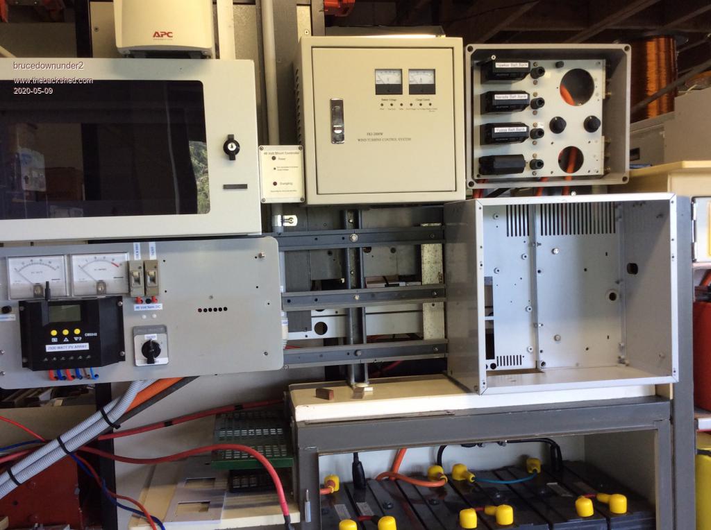

Have progressed to gutting an old Telstra battery charger recently ,it's a bit bigger than the Inspire case ,so maybe can l eave the Torodial coil in it's case opposed to a seperate case...
 Got some goodies from the Telstra case that will come in use further down the track..
 So, I might be able to progress ,with the help of Aaron,who is busy doing the boards.  Hope to discuss the best way to position the boards and other necessary gear ,within the case.
