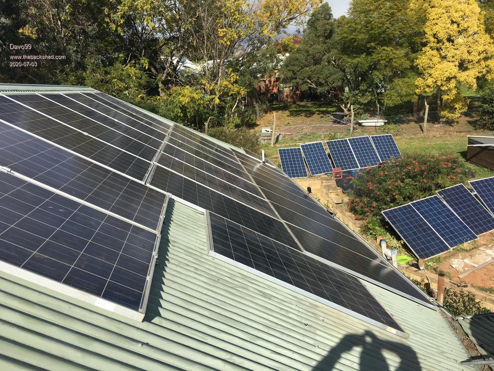

This was the array I put up last week and got my roof legs and tactics worked out.
24 x 250W panels.  Still enough room from the end the picture was taken to add another 12 panels so I might extend the strings from 8 to 12 to end up with one less.
That will be 3 Kw on a 2 Kw tracker so should be OK given I'm really chasing winter yield. Ground test array in background (That's been there a year!) will be finally going up on the roof to make way for outdoor bathroom and landscaped spa area to go in when Tractor finally arrives from stealership.

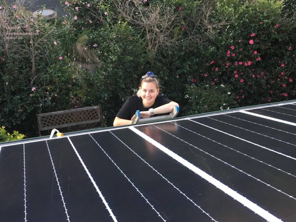

My unhired help. Princess of Princesses is a good worker and very practical when she wants to be. Even on a ladder, still has a damn phone in her hand though. Can't complain, she was a great help and worked really hard and didn't whinge.
Made me very proud when at one stage she asked if I wanted the positive or negative lead. So many people even sparkies I have heard call poles Plus and Minus and that drives me nuts. So pleased she got the terminology right without even being coached.

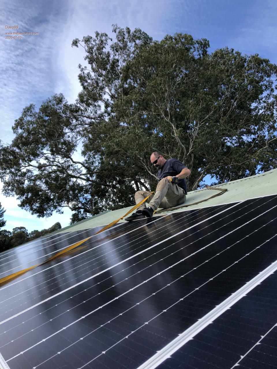

Crash test Dummy overcoming fear of heights and installing panels.  Note full safety equipment, PPE and observation of all OH&S procedures and practices.  May be a bit hard to see in the pic but they are all there in place and was approved by a safety inspector before and during the time the work was carried out.
Really!  :0)

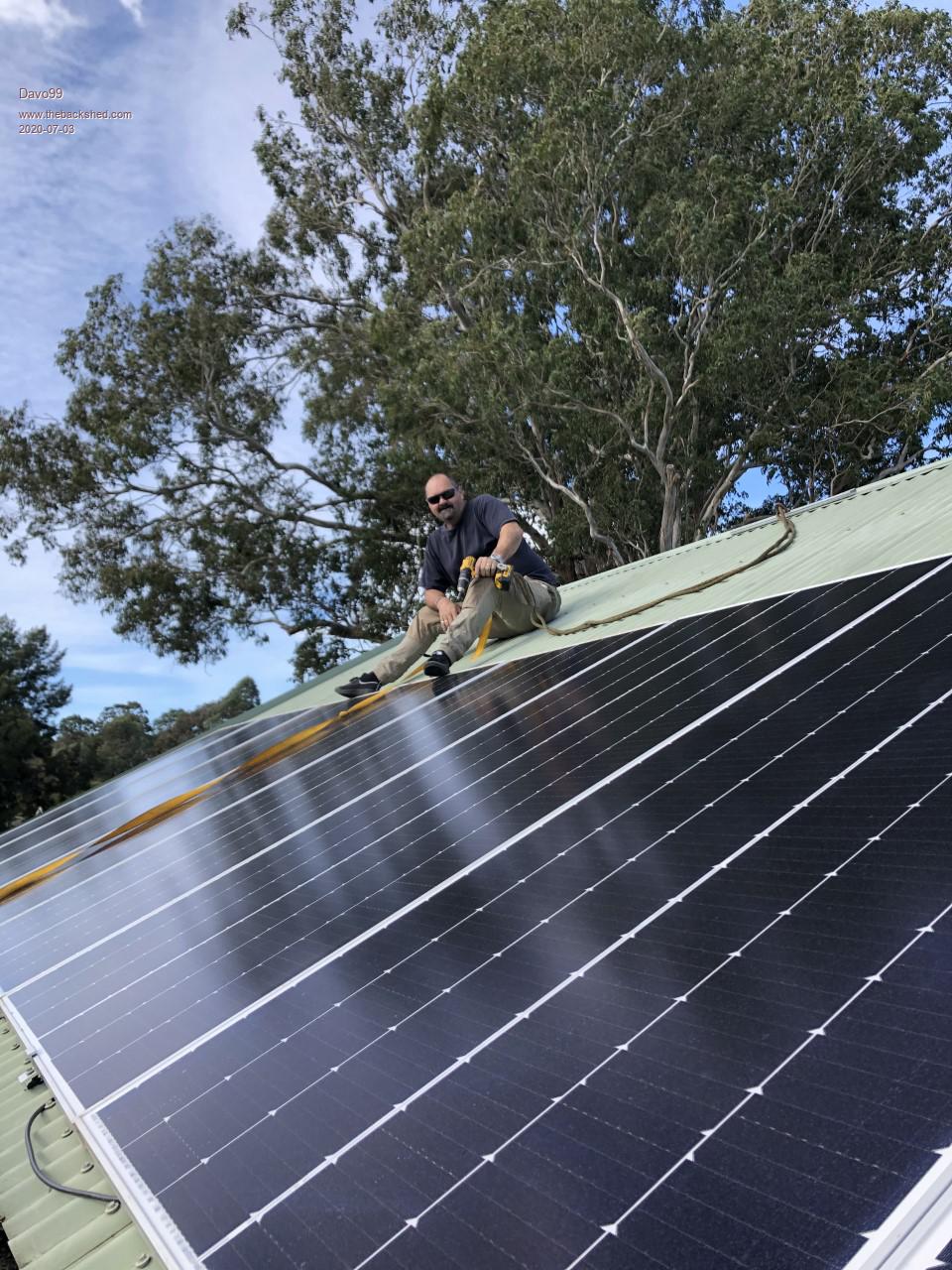

I was a little concerned about nosy interfering neighbours across the road seeing me though. Typical Busy bodies that report everyone for anything and call the cops for nothing but of course break more rules and regs than anyone else around.
Luckily they must have been working and I didn't have anyone show up.  No question I would have had they seen me up there.
Demonstration once again of proper working at heights safety procedures and equipment. I think the unhired help was just trying to get a shot of our 400 Yo tree and someone got in the way but anyhow. Cables were tidied up and all put under the panels before work was finished. When I complained of unhired helps dodgy workmansh*t, she replied no one could see them from the ground so what was the difference? I asked if she was a licenced installer because she sure had the work ethic of one!

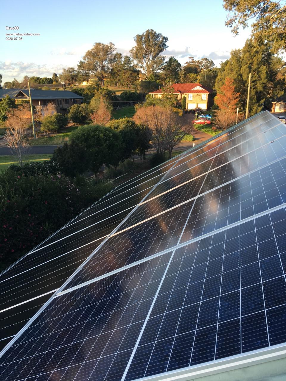

The finished array. These new panels look pretty good I reckon. About 95% of that roof area is covered bar a couple of angles at the back end. I put extra clamps on the end panels as we get scary strong winds here and the end panels are the ones that cop it the most. There is a small overlap on the top ridge of the roof of about 100MM which isn't Kosher these days although the neighbours panels have a lot more overhang and they were installed by someone " Licenced". Quite a few things with that setup I wouldn't do myself and think are dodgy but anyway.
The great thing about not being solar certified is everything you do is automatically against regs so no need to worry about complying from then on! :0)
No roof Isolators on this setup and I'd never entertain the idea of having them anyway. 100 times more problem than they are worth. Another benefit of not having to comply with often stupid regs.
I'm more than  satisfied no panels are going anywhere less the Colourbond and the roof trusses go with them.  Also satisfied that the roof is now less likely  to ever leak than it was before.

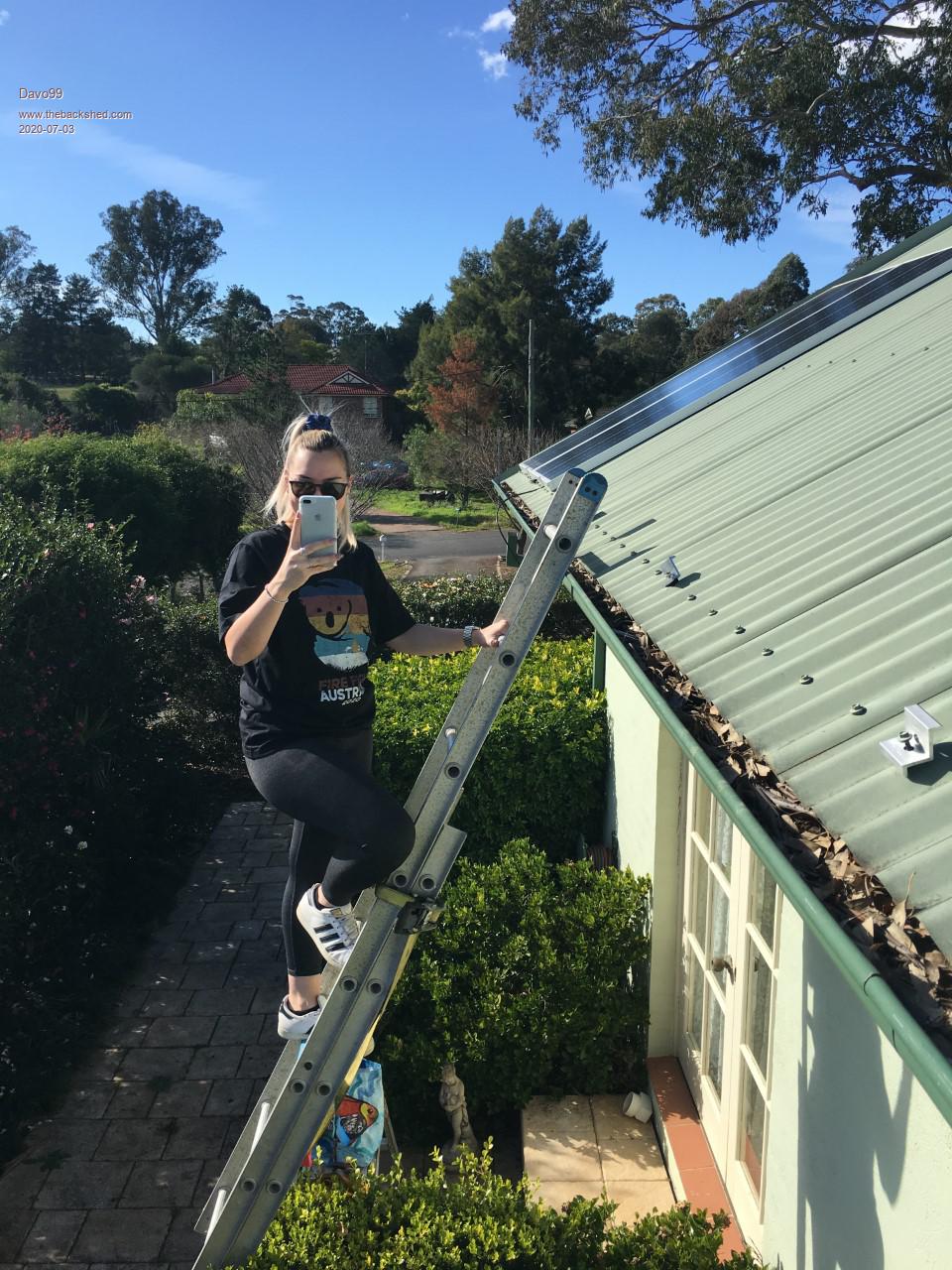

Unhired help relieved it's all done and wanted a shot for Instafacetwitchat.

When I put up this last array around 6 weeks ago, I was a little disappointed when the best I could get out of it was a fraction over 4 KW.  Not it maxes out the 5 KW inverter for many hours of the day which is a big gain in itself.
That 6.2KW array made 30.6 Kwh on it's own yesterday which is more than I thought was possible this time of year. That's a 5x output with I think is going well. It is at " ideal" winter tilt and only 10o off dead north orientation so it does have plenty going for it.
It's interesting to see how the different arrays work. The west arrays are late starters but really catch up later where the north array fades off.  The fairly flat north array on the shed lags behind quite a bit in winter, I have re- configured it before I did the last house array so be interesting to see how it goes this summer.
I am limited on the wiring with it though. I was going to run 6mm up there but hardly any point now.
The big achievement has been that I can now basically support our High winter demands in our all electric house. I did not think that was viable but seems it is.... and I'm not done yet. Still have probably another 4Kw I can out on the house but That will be taking some off I have now so not sure what it will work out at but something round there.  I also want to add to some of the last west strings and change them from 8 panels to 10 just so I can get more power per tracker on the inverters.
Something I have also noticed is that the generation and I surmise our useage patterns change through the year. I find I get way ahead on one phase and fall behind on the other. Gets a bit annoying re wiring the phases the inverters are on so I found a DIN rail type Change over switch like a Circuit breaker I have ordered.
I think I'll leave the 4 Kw inverters as is and then just change the 5 Kw as needed.
I have been told about using a 3 Phase transformer for the balancing but I'm not sure how that would work and I'm wary of something that will handle 20Kw or so of power.
Cost and packaging could be a problem.  For $30 I think the change over switch will serve my needs.  Not like I have to worry daily, takes a couple of months for things to really get out of balance.
