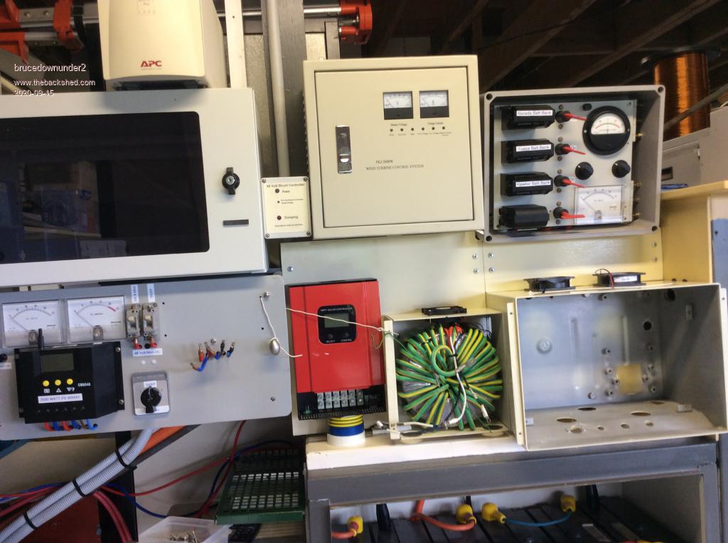

 I'm attaching a photo of what I'm trying to describe.
 I've two of those black coloured controllers fitted , both 48 volts/ 60 amps .
Just trying to electrically match them ,so either will be able to supply a light load from existing panels., - without interferring with each other.
The red unit is MPPT and will be for a seperate solar array.
The battery bank will be for primary supply -thats another story.
Bruce
