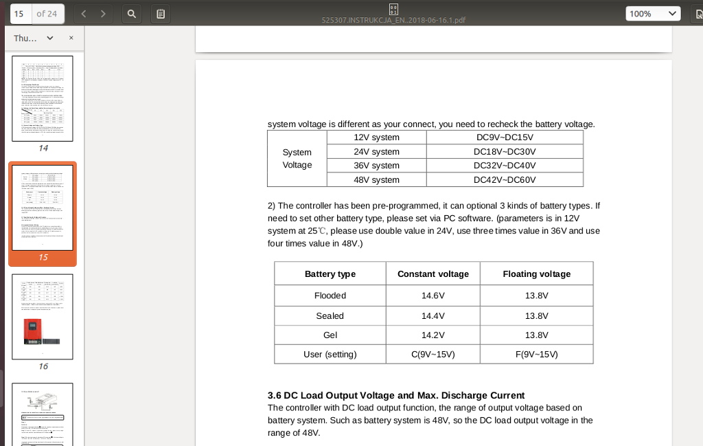

It could be on the constant voltage stage  CV. 14.6 X 4 is 58.4v
You could try "user setting" and set it to what you want.
Take a photo of it working, perhaps we can see what is happening.

Thanks Aaron,just read your manual ,same as mine ,but mine does not mention a brand name at  all,just Mppt.
Also mine displays STANDBY in the lCD display , but not one word about this function in the manual.

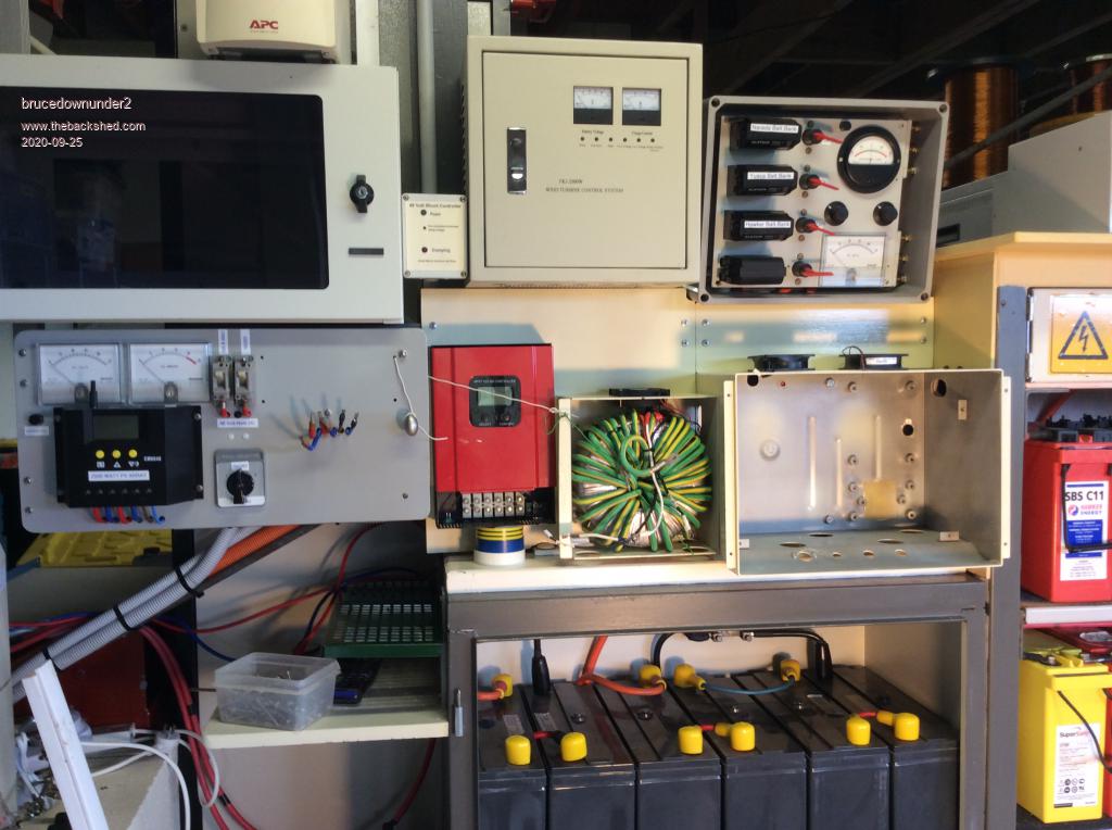

This is a pic of the red/black MPPT controller .  Aaron has suggested that a previous owner may have had it set for a higher voltage (his type of batteries) . -but I'm sort of thinking I've bought someone else's problem ??.
I'm waiting for full sun and I will try to re-configure the menu for my lower voltage batteries. I'v read the instructions ,but @ 76 I'm not smart in that dept. anymore.lol.

If the voltage in and out is the same, and the controller Doesn't indicate any charging, it seems like its just going strait through.
So perhaps a shorted fet, or not switching and not doing its MPPT thing.
Gizmo posted this link http://skagmo.com/page.php?p=documents%2F04_esmart3_review earlier and there is a schematic as well.
