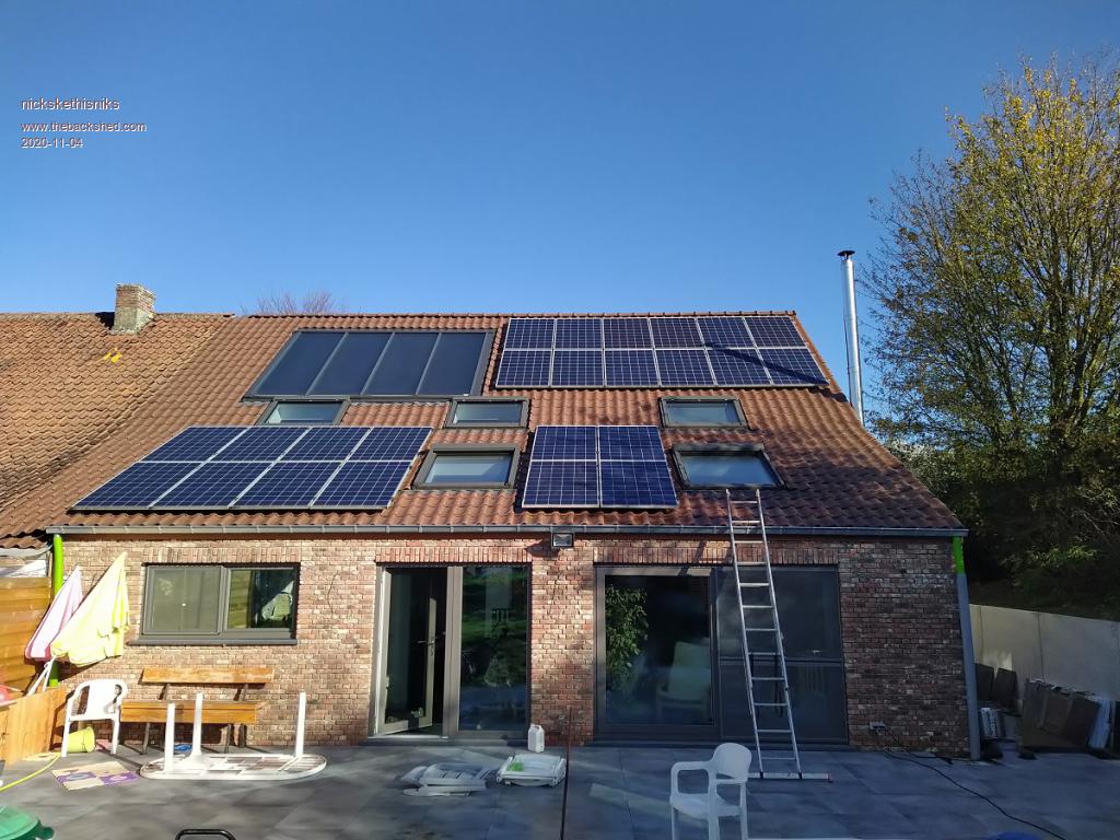

I've got mixed feelings about my system, we paid 12000€ for the solar flat panels, placed by professonals 800l tank, controller,.. . We thought we would have some subsidiary (+-3000€). Not...long story...bummer..
We have a big system were the floor heating and woodstove is also connected to the system. So it's also complicated to let everything interact with eachother on a good way.
A normal solar water heating system (domestic household 5persons?) for sanitary water would cost about 5000€ and after subsidiary about 2-2500€.
Mixed feelings with our system because when there is sun we have a lot of power, to much power, so it contribute to the floor heating.
And it's working like it should be. Some days it just heats the house on its own. We can expect 7 months/ year 100% without additional heating of the buffertank. I think the other months are roughly 50%.
However in clouded weather the panels are only maybe 30-40°C wich is not enough for sanitary water. Maybe for floor heating but that would make the system more complex and not worth the money and effort. Those days I would be more  with regular photovoltaic panels. I could've placed 8 panels more on the same surface and for the money spent on the system....
If I would redo the system, I would have place photovoltaic... I'm also off-grid..., but 3years ago I wasn't convinced I could stay off grid... once my kid(s)are becoming teenagers I think I need to get a grid connection.

A practical example today @ 11.30:
Pump is running at 5l/min, and in/out is 30/40°C. That's about 3.4kW output.
Outside it is 9°C, clearsky, sun is far from 100% on the panels, you can see at the shading.
A solar panel 280W on the same angle without shading is giving 31V 5A01 --> 155W, 8 panels on the same area would bring me about 1240W.
So you see, the thermal panels are a lot more efficiënt in clear sky, the actual usefull thermal area is 11.1m˛ (Tisun Fi3/4), roof area is 3.01*4.01m.
Offtopic, the group of 4 panels I did yesterday, it took me more than a day to get those installed... Ones my aluminium bars were mounted, I discovered I had 40mm brackets instead of 35mm... So I had to adjust (file,saw,grinding...) them, it took me more than 2h for just that....
Installing solar panels on a roof like ours is a real pain...

I didn't come to a new real measurement... I think the max difference was 15°C with 5.5l/min. My solar array on this roof was not doing more then 4000W (6720Wp). One thing I noticed was that the sun is lower when it's pointed straight to the panels. So there is actually not much gain after 12h.
Those 4 extra panels are really adding some kw's in this weather. So the washing machine was on all the time, even the dishwasher and dryer were joining for some time.
