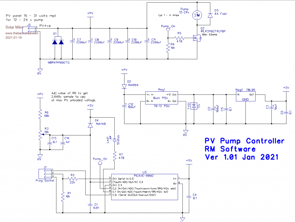

I need something to startup our solar powered water pumps in the mornings as the sun come out.
The long life magnetic drive pumps will be direct connected to a PV panel approx 50 - 180W and run continuously as long as the sun is shining, some run off 24v and others 12v dc; each voltage type has its own panel.
Problem is at low light levels the panel cannot supply the starting current to get them running and will sit for some time in a stalled state drawing current in one winding rather than being shared, so its not good for the pump.
There are a number of simple solutions out there on the net, using a comparator and a bank of electro's, the higher current devices are expensive and dont have any timing features, or the range of voltages, so its easier for me to just quickly throw something together and send off the gerbers along with a bunch of other boards.
Here is the schema for a simple design using a Picaxe 08M2 for pump control, basically the cpu looks at the capacitor voltage and when its above a set value turns on the mosfet; if the voltage due to the loading falls away below another set point, then the mosfet is turned off, there will be some delay prior to turning back on, as these pumps have multiphase controllers built into them that spin a magnet inside the impellor; so cannot be fast pwm controlled.
Will pickup any errors when the pcb is designed.

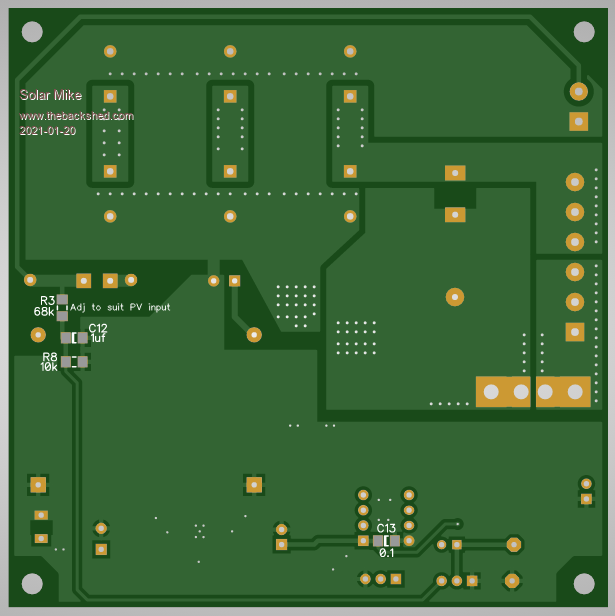

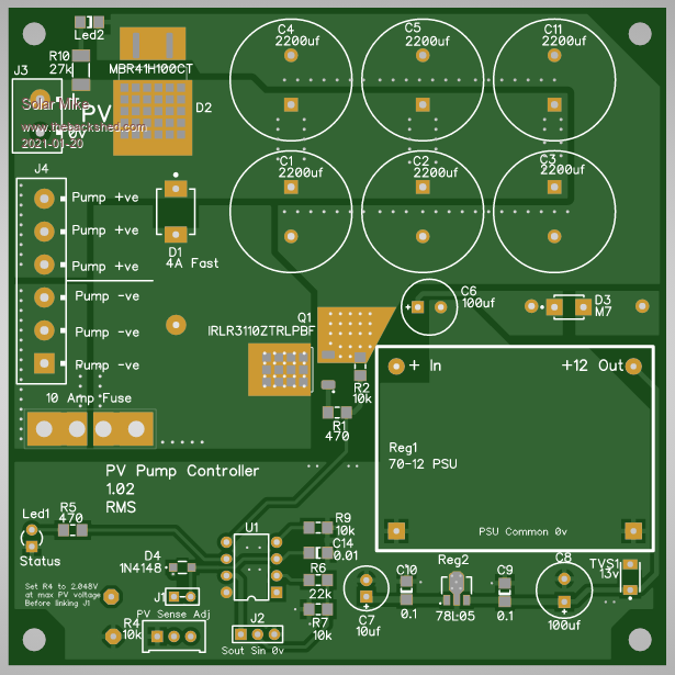

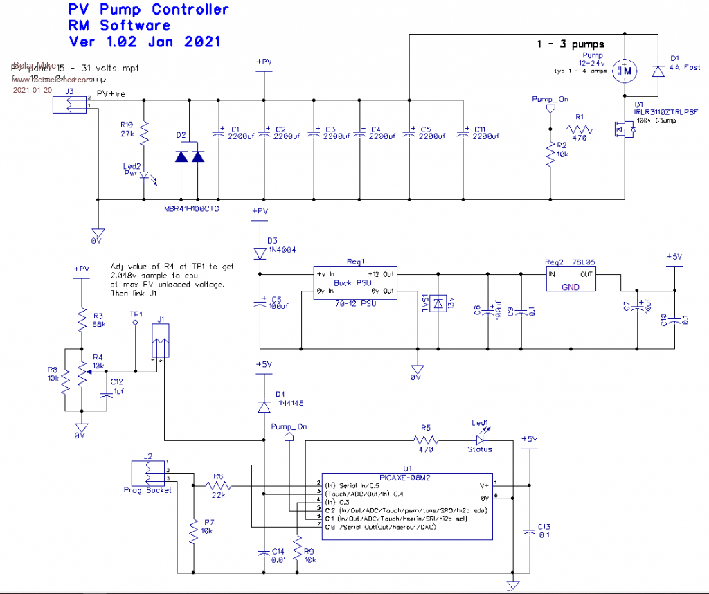

Completed PCB and latest schematic, pcb is 100 x 100mm.
Top:
Bottom:
Anyone wants the gerbers, send me a post and I will email them to you.
Mike

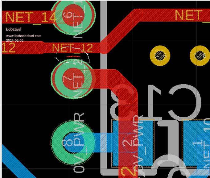

Looking at the board I got a few error reports as it came in so they could just be a setting  of sizes by me .  ,I'll work through those and find whats happening but a couple of clearance errors came up too that I'll mention just in case they are real on your board .
1/ Just to the left of   1 0V_PWR there is a forgotten bit I think.
2/Between pins 6 and 7 of C13 there is something in there just under the bar of NET_12 label.
Edited 2021-02-03 07:39 by bob.steel

Here is a screenshot of the C13 one with the clearance error . Does it not show like that in your exploded view?
Also I got sheet 2 of the .sch file but not sheet 1 . Is that how it should be?

  bob.steel said  I'm finding this very interesting .
There is only 1 one sheet in the schematic, should look like image few posts back; perhaps the export process doesnt exactly match your software.
Clearance is fine, no errors at this end; have finished pcb here, no issues looking at it.
