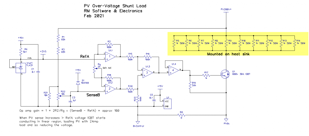

During testing of these controller designs on a common set of panels, these series strings can reach quite high voltages when unloaded, for instance I want to put up a 5s array where each panels unloaded voltage is 40v, but the mppt voltage is a lot lower 31.5V; this gives a working point of 155V which is ok, the controller can handle that. However during float or first connection the PV input voltage is around 200V, dangerously close to the input capacitor max ratings and the mosfets max voltage.
Rather than use higher voltage caps and higher spec'd mosfets (with higher on R) thought it may be simpler to place a device across the PV input that allowed a load be placed across the array when the voltage increased beyond a set value.
A voltage sensitive shunt load springs to mind, using an IGBT device running in linear mode, so the higher the voltage above a set point, the more it turns on, thus lowering the voltage. Couldn't find anything suitable on the net, so here's the result of a thought experiment.
IGBT devices are quite robust, their SOA curves have good operational area down to DC and they are cheap. The old style LM324 op amp can run single supply at quite high voltages, certainly high enough to drive the IGBT in its linear region. The PV voltage is compared to a 2.495 reference by a subtractor circuit, the difference multiplied by the gain of approx 100 is the linear drive.
I could use a bunch of 50W resistors or something like an old single bar heater as the load.

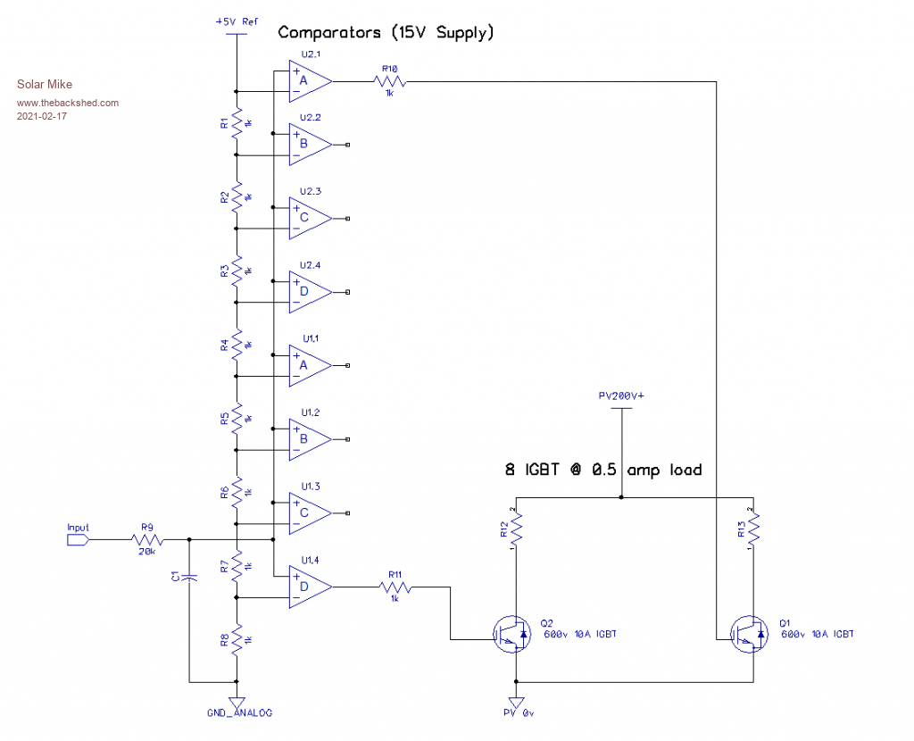

Use something like this, 8 comparators each connected to an IGBT\Load, connected in place of the IGBT in the original circuit.
Mike

That is basically what is inside an LM3914, but with a pair of discrete quad op amps, and a few 1k resistor packs, it should be able to work a whole lot better.
A bit of transient protection across the IGBTs might be a good idea.
