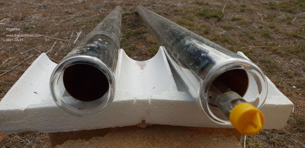

I'm still working on my Warpinverter but it is going to take a little while yet.
In the mean time I have been trying to work out if we can add a little extra heat to our home over winter and perhaps even burn less wood.
The idea has come about due to spotting some cheap evacuated tubes for sale on FB marketplace. I bought a box of 10 initially for $20 and was offered the remaining 100+ for $100.
Unfortunately the tubes come without the copper heat tubes that enable them to transfer the heat out into a manifold to heat water or air  ...  so it precludes using them to heat water without a lot of extra work or expense, and probably both!
After playing around with the first batch, I've been impressed with the amount of heat the tubes can collect  ...  so I've been toying with different ideas as to how I might make a practical device out of them.
One of my early experiments involved putting a plastic tube down the centre of an evacuated tube and blowing cold air down it with an air compressor. The ensuing air was far too hot to hold my hand in front of  ...  and despite it being late afternoon with minimal sun, it took 6 or 7 minutes before the temperature dropped to 30 degrees C. It had started at 70 degrees.
On warm days I've seen temperatures as high as 200 degrees C in the tubes, though of course they are not the days we want more heat in the house. On the other hand, I have seen temperatures still at 45 degrees even at 10 o'clock at night.
Again, that would drop pretty quickly if I tried to make use of it  ...  but any mildly sunny day during winter has to provide some warmth.

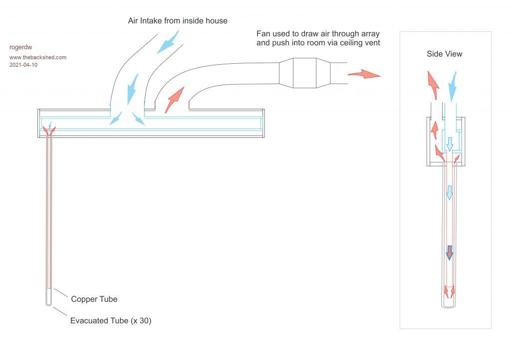

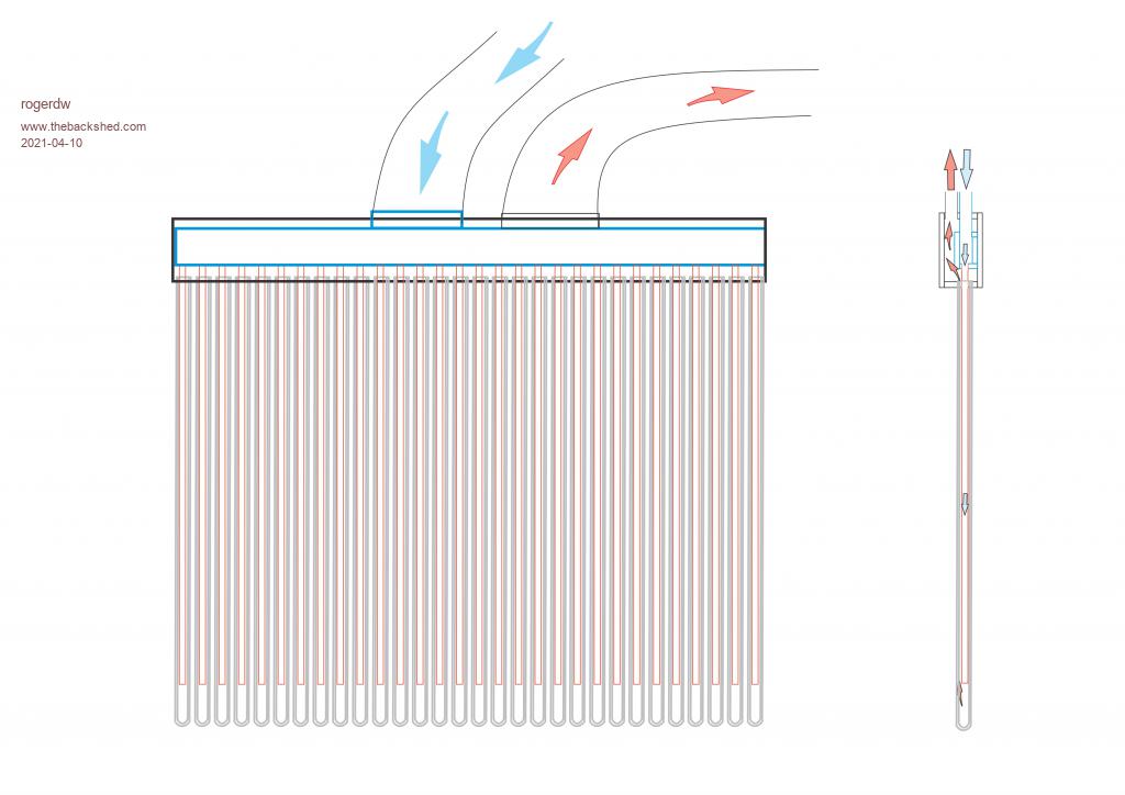

Hopefully the concept will be obvious.
The plan is to hang copper (or steel) tubes out of the bottom of a manifold  ...  into the evacuated tubes.
Then, using an inline fan in the outlet to draw air from inside the house into the heater  ...
...  where it travels down the centre of the copper tubes and flows back up between the outside of the copper and the inner glass tube  ...  gaining heat all the way through  ...
...  and expel it back into the home via a ceiling vent.
Edit: I forgot to mention that in this design I would hang them on a north facing wall and have the inlet and outlet open into the area above the eave.
Could also create a version to lay on the roof, though fitting ducting through the tiles becomes a bit problematic.
My first design was also to mount on the wall, but with horizontal tubes  ...  with the outlets designed to go through a partially open sliding window.

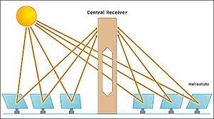

My first thought is that vertical and north facing will produce little heat in the early morning when its most valuable.
But you could probably overcome that with one or more fixed mirrored reflectors suitably aimed to catch the early morning sun, without losing anything during the rest of the day.
These commercial "power towers" usually actively track the sun throughout the entire day, but I see no reason why one or more fixed reflectors could not be arranged to boost output at a particular time of day.
A few mirrored tiles could easily double the heat output.
A large number of tiles, the heat increase could be quite dramatic.
Cheers,  Tony.

  Quote  But you could probably overcome that with one or more fixed mirrored reflectors suitably aimed to catch the early morning sun, without losing anything during the rest of the day.
We do have a spot on the wall on the side of the house that would suit, but unfortunately it is recessed about 50cm  ...  which brings in some shading at top and one side.
To solve that I'd like to move them right to the outer edge of the eave  ...  but after discussions with my wife I'm not sure she'll be happy with that  ...  she wants it up against the wall. Of course there's some plumbing in the way there!!!
I like your idea of mirrors to increase the output, that could perhaps more than make up for the loss caused by shade. They could even be active if there is room for it without it being cleaned up by a 7 year old on his scooter!

You are quite right in that they do normally harvest the heat from the tube with a "heat pipe"  ...  but my 'cheap' pipes don't have them fitted so my experiments revolved around just the bare tubes.
The heat I was obtaining still seemed very worthwhile even without them, so I was trying to avoid the expense and complication of buying or making them.
  Quote  This is a REALLY interesting concept and One I'll follow with great interest. If you could post some pics of the tubes particularly the ends that would be great as still not entirely sure I have them right in my head. I take it they are like a big test Tube?
That's a good description, they do look like giant long skinny test tubes  ...  though they have a second tube inside the outer one  ...  with a vacuum inbetween  ...  like a good old thermos flask. The inner one has a black coating that absorbs the suns energy  ...  which cannot escape due to the vacuum between the tubes.
The overall OD is ~60mm and ID is 44mm.

  Quote  If I can pipe in warm air whenever it's available, that must still help the overall temperature in the house.
If you could get some hot air into a thermal mass, that would serve as a heat battery. I don't think that would be hard, Blow the hot air though a Drum of Big rocks, Through a car intercooler in a drum of water.  Packaging and presentation is the trick here though.  I was going to get a screen to put round a Drum or drape it with a table cloth and stick some pictures or a vase on the top like a round table.
  Quote  You are quite right in that they do normally harvest the heat from the tube with a "heat pipe"  ...  but my 'cheap' pipes don't have them fitted so my experiments revolved around just the bare tubes.
OK, I wasn't sure and obviously don't know much about these things so at least my impressions weren't totally incorrect.   :0) I didn't realise that they were 2 part as it were.
  Quote  The overall OD is ~60mm and ID is 44mm
That seems much more workable than what I had in mind. Thinking the manifolding in and out does seem a bit complex though.  I Imagine one would want a air feet tube going near the bottom of the pipe and exhausting back up.  I'm thinking a large, 150mm pipe for the exhaust with the air feed running right though the center of that.
Bit like Tube in tube HE's I used to Build for Veg oil cars.
Sealing the tube to the larger duct seems like it could be a challenge.
I did notice seals for these things advertised on Fleabay.  If they could be obtained with an in out port,  Might be just as easy to run a pipe down the center and use water as the working medium.  Would be easy to use as I want to do an old electric water heater tank for storage. 400L tank will do about 27 Kwh which isn't bad.
Have you any ideas on the manifolding? It seems the trick of the exercise.
  Quote  The fan I used pushing air down the C-Section does the job ok though it's not super speed or volume
Yep, they will move air providing they don't have to work very hard to do it.
With this and the manifolding and pushing air down say 20MM Pipes, you are definately going to need something that generates some air pressure as well as  Volume.
I'm wondering it instead of pushing air down the tubes, you wouldn't be better trying to suck the hot air out?  That's usually how cooling fans work, Draw though but it would put importance on having air tight manifolding around the  tubes.
There are rubber Joiners/ Connectors used for joining pipes in boats etc. You might get one of appropriate size for the tubes. They are not that cheap especially in volume though.
Yeah, and there's actually a third part as well that's needed.
If you look at some of the images of evac tubes  ...  they also have a piece or two of folded or shaped copper sheet the full length of the tube  ...  shaped in such a way that it contacts the inner surface of the tube and transfers the heat to the heat tube. It also needs to locate the heat tube centrally or against the glass depending on which design it is.
I think this part was more a stumbling block for me than the heat tubes themselves.
  Quote  That seems much more workable than what I had in mind. Thinking the manifolding in and out does seem a bit complex though.  I Imagine one would want a air feet tube going near the bottom of the pipe and exhausting back up.  I'm thinking a large, 150mm pipe for the exhaust with the air feed running right though the center of that.
That's pretty much what my design shows  ...  a 25-30mm tube right down to the bottom of the evac tube.
Air is either blown in the cold air manifold and pushes to the bottom of the tube and can only escape by travelling up between the outside of said pipe and the hot centre glass tube  ...  taking it's heat with it  ...  or be sucked through by an inline fan on the hot air outlet.
  Quote  Sealing the tube to the larger duct seems like it could be a challenge. I did notice seals for these things advertised on Fleabay.
Nah, I'm a cheapskate  ...  I saw my answer on a youtube video where they were making tanks for the conventional evac tube heaters.
They fitted slightly smaller temporary tube stubs into the side of the tank where the glass tubes were to fit  ...  then sprayed expanding foam around them. Once set, removed the stubs and a perfect seal for the evac tubes to slide into.
Certainly good enough for air, maybe not water of course.
  Quote  Have you any ideas on the manifolding? It seems the trick of the exercise.
Pretty much what my diagram shows  ...  just a wooden box inside another wooden box.
Maybe I need to create a larger graphic with a bit more detail.
  Quote  Yep, they will move air providing they don't have to work very hard to do it.
I had a feeling I'd read that somewhere, so again that's what's in the diagram  ...  a fan that 'sucks' from the hot air end.
  Quote  There are rubber Joiners/ Connectors used for joining pipes in boats etc. You might get one of appropriate size for the tubes. They are not that cheap especially in volume though.
Yeah, I've seen lots of options but like you say not necessarily cheap  ...  but I'm sure the expanded foam method could be used in a multitude of ways.
