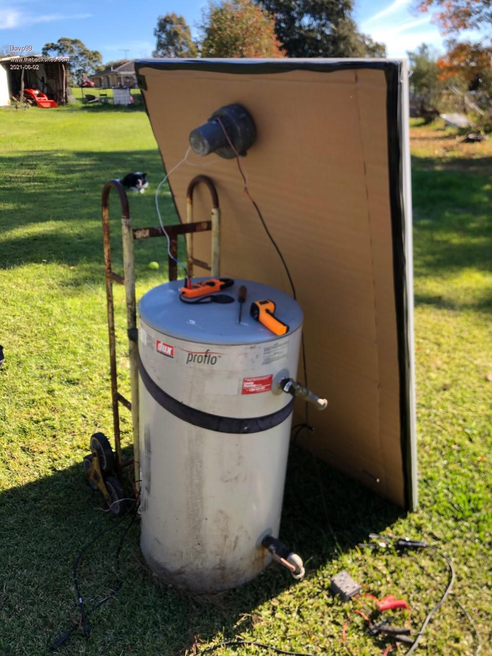

Inspired by Rogers Thread on heating with Evacuated tubes, I decided to give something a go that came up in the discussion, harvesting the heat from PV panels.
Seemed to me after all I learned from that thread that a and ordinary solar electric panel was just a big flat plate collector and it was shown they are also only around 20% efficient at making power so must be some good heat to be had.
I Pondered what to use for a backing which would not loose the heat from the panel and give accurate measurements of the heat generated. Being the exacting and scientific type that always like to do things to the highest standards possible, I spotted the cardboard box lying on the pile waiting for Council Clean up and thought Ripper, that's big enough so grabbed that.

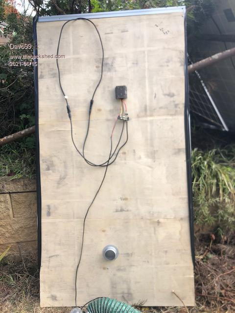

Cut it to size with a stanley knife and without any skill or dexterity what so ever, Duckt Taped ( Note precision spelling!) to the back of a new 270W panel that was handily within reach. With Infinite wisdom, For once, I remembered to cut a little hole and pull the leads through before I taped the thing down and had to work out which end and where they were.
I then cut 5 Slots near the cable end of about 1 Cm wide and 10 or so cm long as inlets.  I grabbed the also handy ( where I had been playing with it before and hadn't put away in 3 weeks) 12 V Bilge blower.
It's a TMC that is rated at 90 CFM or for metric Minded, about 2.5 Cubic meters a minute.

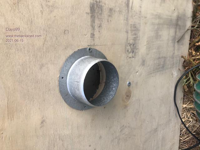

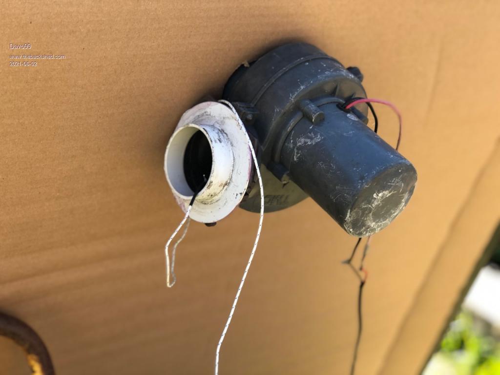

I managed much to my surprise to hack a neat hole  near the other end of the panel and  secured it with a good push fit being careful to leave  some space for the air to pull in.
Sorry for the crappy pic, that's what happens when you go all modern and use a phine instead of the proper tool for the job.
All I did was put some cardboard on the back of a panel with slots on the bottom and a bilge blower sucking through the top. The voltage converter can be seen in the lower left of the poor quality Pic.  The slots are in the shadow at the bottom of the pic. I carefully worked them out with great detail and precision using complicated formulas in eyeballing them then hacking them out with a half sharp box cutter knife.
given the temp I was getting and the fact it didn't fall off, I think they may have been pretty close to the mark by some dumb luck.
I stood the panel up on another experiment I had finished with and yet to put away and felt the panel which was dead cold from lying face down on the grass.  Didn't seem to be warming up real fast in the 2Pm fading sun so I though not going to see much out of this.

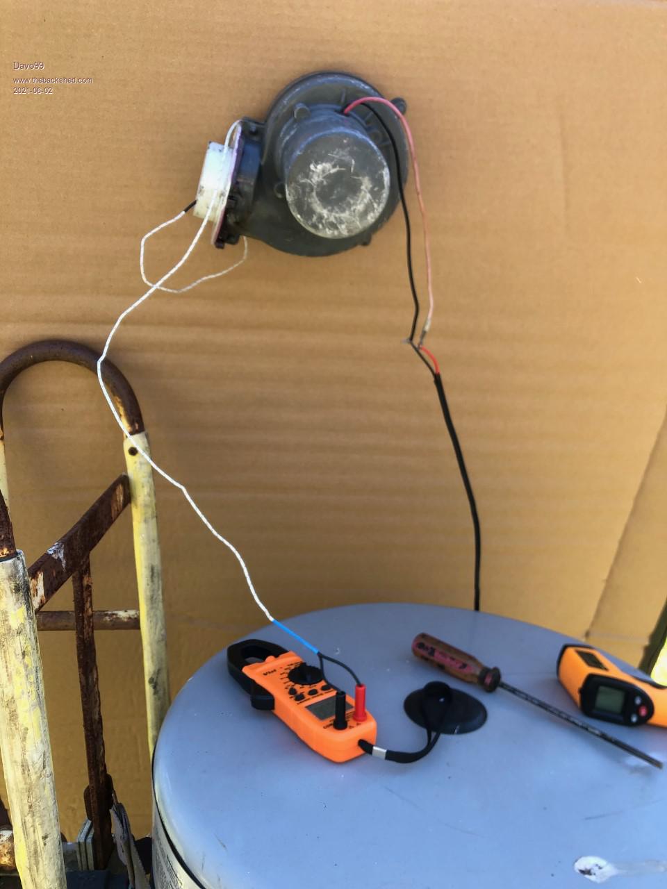

I jammed the wires from the blower into the panel leads and the thing ran like it was getting 30V so I disconnected it and went and got my little 20A 24>12V converter.
Took me 5 or so minutes to get some leads and a screwdriver etc and hook it all up.
By this time the panel had gained some surprising heat.  The temp gun said about 68oC.
I thought yeah, that's all good and well, that will soon cool off when the blower starts.
Fired it up and could tell straight away the heat coming out was significant.
I ran it a few minutes and the heat didn't seem to be dropping off so I ran off like an excited little girl and brought back my thermometer.
The ambient air temp in the shade was 19 oC. The air coming out of the blower was 34.
Confirmed this with the heat gun.
Ran the thing for a good 10 Min and it did not drop.  I measured the panel angle and found I had the thing standing at 76o and was off on the orientation to the sun a bit. I re aligned it and changed the angle to 62 o which I thought close enough and to my amazement, the temp went up to 38 C coming out the blower.
Got to say, I didn't see this happening! Right up till the time I started the blower I thought this is going to amount to nothing but, I have certainly changed my mind.
The panel face was sitting at around 67o and didn't really drop nor did the temp of the output. The cardboard backing was around 44O for some time but then fell to around 38 also.
After about 30 Min I went and got a 12V 55W Light bulb and put that across the converter output and it lit full bright without the fan speed dropping. I measured the Voltage and got 11.78 so I would say the fan was doing close to rated output.
I don't know the Precise CFM I was getting or how much energy that equated to but it was certainly enough for me to think that it was significant enough to do a proper build with this.  I would by guesstimate say the airflow was similar to that of a fan heater on high although the temp was obviously less.
By about 3 pm the big tree in the back yard was starting to cast shadows on the panel.  Thinking of my good friend Roger, I thought I'll watch this and see how this goes with the fall off in fan speed with the converter.  It audibly did fall off although the temp remained the same.  I thought I'll speed this up a bit and cover some of the panel.  It slowed the fan noticeably but to my surprise  yet again, the temp went up to 41. Considering the amount of panel I had shaded, even with the lower airflow I was not expecting that either.
This is the opposite of what I would have thought in the fan would over power the panel. Seems the efficiency of the panel ( and Tubes) to make heat is way ahead of a panel to make power. Maybe that should have been obvious given their relative efficiency's but when one is powering a 36W fan with a 270W panel.... I would have thought there was plenty of margin to push the equation the other way.  Seems not and I can see why Roger had much the same result with his tubes making heat before the fan kicked in.
I can say I am quite surprised by the results I got. Not what I would have thought at all.  As I said, No idea what the actual energy generation was but the result of my test left me feeling that it was certainly something worth while and that there was more energy to be had. There is still plenty of electrical energy that could be converted to heat if that is the primary goal or a lot of heat as a bonus for making power.

Measuring output temp.

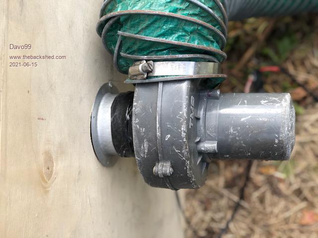

Blower I bought a few years back for $20.  90 CFM, 12V, 3A.
It's a flange mount but I glued the white spigot on a few weeks back to use for providing combustion air to an Oil burner.  The flanges are for std PVC pipe so could be used on the back of each panel and connected together with T pieces  and pipe and one fan ( although maybe larger) used.

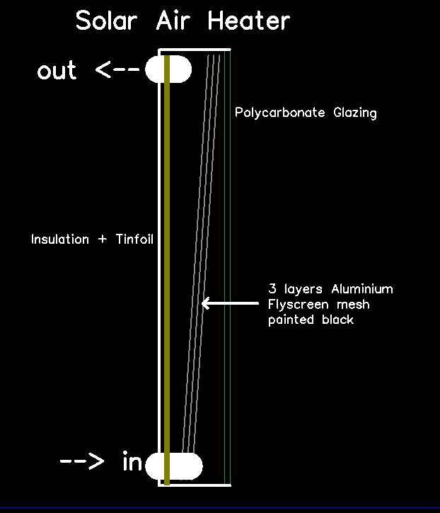

Hey Dave, placing some sort of sealed boxes behind your panels seems a lot of work.
The most efficient cheap solar air heater you can easily make is a timber box made out of rough sawn 6 x 1 fence palings approx 1m x 2.4m. - to fit the corflute size, recess the back with corflute siliconed in around the edges and tinfoil glued inside to that. Extra insulation on the sides doesn't make much difference.
Run 3 layers of open mesh aluminum flyscreen door material painted black spaced 15mm apart on a slant, glaze with 1 - 1.5mm clear polycarbonate, >90% light transmission. Black polypropylene garden shade cloth works almost as well here.
150mm air ducts in at the bottom extended near the glazing and out  at the top on the other side of the mesh, couple of 120mm computer muffin fans in the inlet driven off a small 12v PV panel.
This setup will be >70% efficiency, you will be surprised at the amount of heat that it generates, if the sun is shining.
Mike
Edited 2021-06-03 14:18 by Solar Mike
Davo99
Joined: 03/06/2019
Posts: 1586
Posted: 06:59am 03 Jun 2021
Interesting. I now get the use of the flyscreen, the air is drawn though it rather than over it. Clever. I was wondering why the design use screen instead of a solid collector?  You diagram cleared that up.
Mike you are obviously an expert on this, do you have any links to charts or input as to what the expected output of such a setup might be?
I calculate for the area of the collector using 400W as the Sydney winter insolation and the 70% efficiency you state, this should give about 672w of thermal energy. Dies that agree with your thoughts?

I'm no expert, just have built quite a few over the past 30 years.
Here is a link to construction and testing with graphs etc, they built and compared quite a few differing styles. Here
For glazing they used corrugated clear polycarbonate roofing, I have used it in the past and it gets very brittle over 10y period and will break as it is very thin.
Bunnings sell rolls of 1mm clear poly, that's what I use now, you could throw a brick at it and it wont break. There is also a more industrial version 1.5mm thickness this is sold by PSP here in NZ.
These work best if you stand them vertically against the wall of your house, picks up the low winter sun and rejects the mid summer when you don't need it.

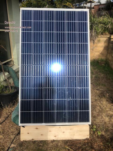

Sun is out again today so I have taken the panel heater setup out in front of the ensuite. Found some non insulated 6" Duct up the back I cobbled onto the blower in every sense of the word and set it up near the window. Almost 11 Am and it's still half shaded. I'm going out shooting shortly for a few hours so I wanted it in place to catch the best of the day.  Might get a few decent hours before the thing is shaded again.
The outside temp was 14 when I set it up and 14-15 in the ensuite, but feels a lot colder. There is already 17o air blowing in so it is an inprovement. The thing was blowing gently before there was any sun at all on the panel but as there was no difference between inside and outside temps, I wasn't worried.  Outside temp is still the same with a bit of wind which isn't helping.
I was going to leave the window open beside where the duct goes in to allow for airflow but though more cold might go in than hot come out. THere is an exhaust fan in the roof so that should pass the incoming air pressure. Probably the warmest air but this is about as rudimentry and flawed testing as one can get so if I see any improvement in temps when I get back, I will be happy.
Such a change from one day to the other.
The little diesel heater was put on at 3pm on Wednesday and I turned it off at 10 am this morning.  With a low of 3 here last night and the heater on level 2, the place was  warm enough this morning.  Only used about 2L of fuel from Midnight and well worth every bit.
Be interesting to see what the temps of the walls and fittings in the ensuite are when I get back.

Trying again today... with Mrs knowledge and lack of Complaint! Miracle!  Maybe she would welcome making in there warmer as well.
Initial Temp inside is 13o. Dressing room again the same so presents a reasonable control parameter.  Hard to say which one has the greater thermal mass. One has tiles and porcelain, the other is filled with clothes and furniture... containing more clothes.  Less density in the fabric but you have to appreciate how many clothes my Mrs has and how densely packed that 4 or so meters of Racking ( which I have literally had to brace  up from the floor in multiple places to stop the bolts tearing through the shelving above) which must weigh 300+ Kg all up.
Well shaded panel is pushing in 15 O air minutes after start up.
If the sun holds out today will be interesting to see what sort of temp rise this gives. Sealed the window pretty good and no wind so far so I think the input from outside air will be minimal as well sun falling on that wall which is absolutely Minimal this time of year.... which is why the damn area is so bloody cold... unlike the hotbox it becomes in summer.
Off to Bunnings to look at some suitable panel backing and a 4" to 6" flange to connect the blower to the ducting I have... and maybe some new ducting if it's cheap enough which last time I looked was anything but.

Came back about 3 Pm after a fruitless search for  Reducers at Bunnings and the local Legend Plumbing/ irrigation place. Went to walk in the front door and a guy comes to the warehouse man door and says Come in this way Mate, I have locked that door up.  I said oh, sorry, I won't annoy you if you are closed. He said no that's fine, come in. Told him what I wanted and seems they make everything bar 50 to 100MM and 100 to 150MM  reducers in DWV.  Didn't have both in pressure either.
Bugger!
Did get some copper fitting and pipe at a bargain price for the Diesel exhaust/ heat exchanger.  Nicest, friendliest, happiest best customer service guy ever. Last time I went there they were flat out and the older guy I spoke to was helpful and apologetic as could be as well.  Don't know why I have bothered with Bunnings, NEVER have what I want in any Plumbing fitting, relatively expensive despite what they advertise and never any fker around to help you when you need to ask something.
Didn't have any Duct I wanted either. be one thing if they didn't sell it but they do and again as always, No stock.
I can well see why online shops are giving places like that a hard time.
When I got home I went straight in the dressing room and shot some temps.  The change room had come up 2o on average. The en-suite had come up 5-6 o despite where I shot the temp. Funny enough, the tiles and sink were not where I got the lower readings.  It was on the outside facing wall where there was now a bit of sun.
I went to take the temp of the incoming air and found there was none but could hear the blower. Knew straight away the duct had come off.  Thought I had taped it on OK but also knew it was still very makeshift hence trying to find some better fittings or duct work.  I surmise it probably let go when the panel was outputting the highest temps of the day. Going outside confirmed this. The blower was running pretty good despite the panel being half shaded again.  Re connected the duct, went back inside and got 21o air coming out pretty quick.
Mostly everything inside was at 19 so there still was potential for temp rise  at that time and I fully believe could have got the room warmer still had the duct stayed on.
As soon as I walked in there from the dressing room I could feel it was warmer and far more pleasant.  Also warmer than what it is normally which is still an icebox at any time.  I can't think there was very many KW of heat that went in if even a single one BUT, it was enough to make a noticeable and pleasant difference.
Checking just now with the sun behind the trees and hill a good hour, the ensuite has lost 2o and the Dressing room is the same. It only has a small wall exposure with half of that of course being another big full height window.
The ensuite  is still cool at 17 But it does not give that immediate cold feeling it Normally has.
Today was a flat out perfect day. Bright sun, no clouds, no wind, about as good as a winters day is going to get. None the less, I am of the belief that 2 panels would make a big difference to that room and maybe put enough heat into it for it to retain some and be far more pleasant to be in.
The big trick will be the setup and the duct.
That wall is west facing so is shaded buy the house close in till 11 am I have room to move the panels out further but then I'll have a long length of duct laying round exposed to the elements, the dog who takes that path when I throw the ball over the house from back to front which is her favourite game  and the wind.
I have panels on the roof Immediately above which faces west so I am unsure how bad that would decline heat generation but I assume fairly significantly.  I could tilt a couple of panels but the degree required  to make a difference and how that would look lessens my enthusiasm for the idea.
I could use 90/100mm DWV pipe for the duct, it's cheap enough but what would the heat loss be ( could paint it black which may improve things) and insulating it would probably be more than I would want to spend on the exercise.
I also looked at Bunnings today for some sort of roll foam material for backing the panels and found nothing.  Sure I have seen some foil backed foam material that should have been suitable for the job before but saw nothing today. There was some tar impregnated material that looked excellent as collector material but  probably too flimsy as a backing on it's own. was REALLY cheap, I think they may have made a pricing mistake on that. Might go back and get some tomorrow.  If I do I'll never use it, If I don't, in a fortnight I'll be thinking it would have been perfect for the next hair brained Idea I come up with and the price will be 20X what they have it for now.
Might just have to look at some plywood, paint it for weather protection and maybe foil line it on the inside if that will help any?  Open to other suggestions for easy to obtain, economical materials suitable for the purpose.

Do you have any recommendation for a reasonably rigid material for use as a panel backing?
