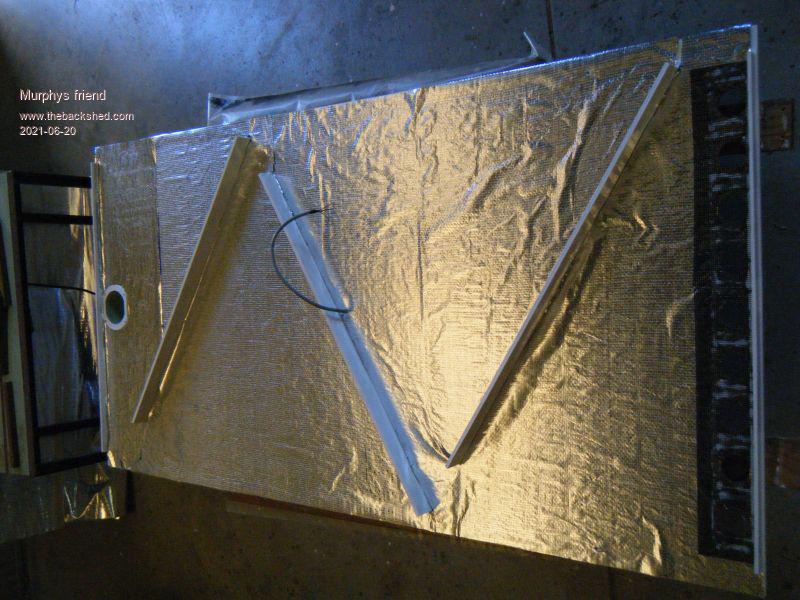

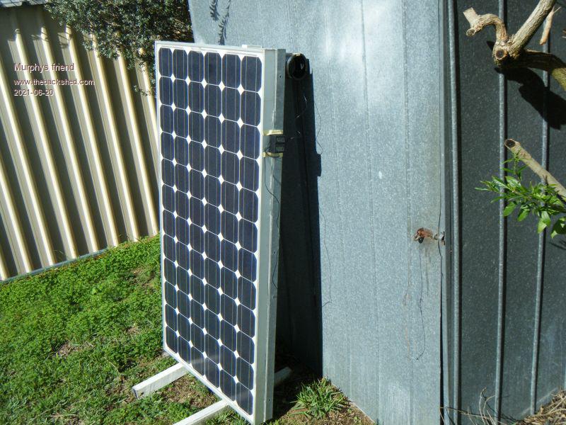

To get as much heat as possible from behind a 175W solar panel I made a alu foil lined Back panel that incorporated air deflectors to maximise the time the air travels from the inlet  to the blower's suction side.
The inlet holes on the left are covered with plastic mesh to keep those pesky spiders out.. These holes are on the panel's bottom back side when installed.
The blower (12V bilge blower) outlet is shown on the left side of the picture.

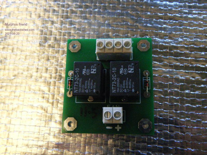

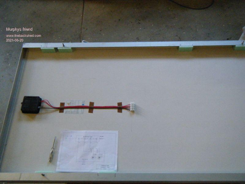

I separated the 3 strings of the nom. 24V panel and select panel output voltages to have the fan motor running at no more than 12V at any time.
The panel back wiring:
And the little relay box:
At this early stage of testing this method worked well, I just hope by the time the blower output is routed through the solar hot box this noise diminishes to a level the neighbor can hardly hear.

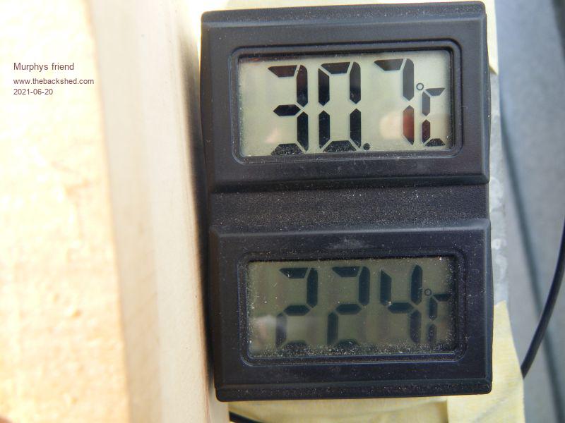

The panel was located in a sheltered, north facing, position on this winter day in Perth, there was near no wind but high cloud came across from time to time.
After the solar panel had warmed up (experiment started at 1PM) the max outlet temperature was around 8 degrees higher than the temperature at the panels back near the inlet holes.
So in full sun a worthwhile heat harvest but even in light cloud cover about 5 degrees more out than flowed into the panel's intake holes.

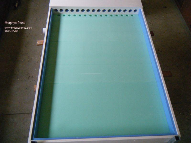

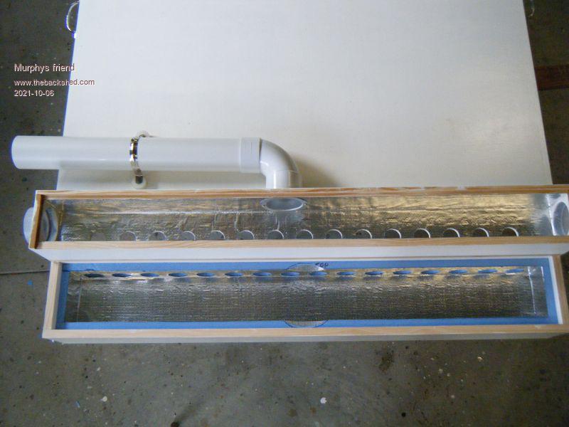

Here is a view of the intake (on top) and output (below) manifolds. The picture was taken from the top side of the heater box.

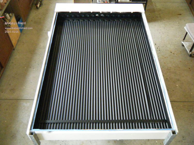

Next is the heater box lined with foam. 30mm at the back and 20 mm on the sides.

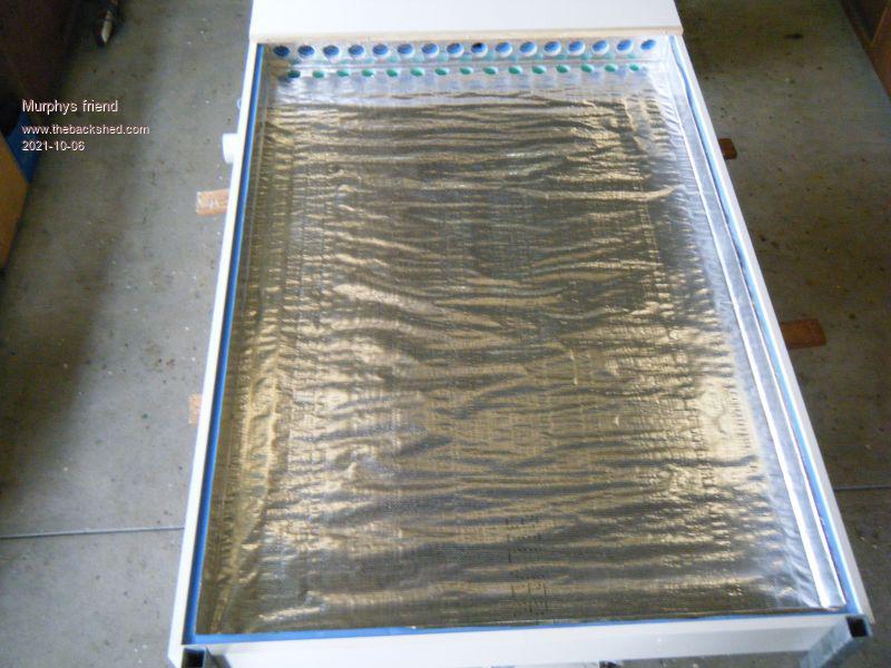

This was covered with sarking, silver side up.

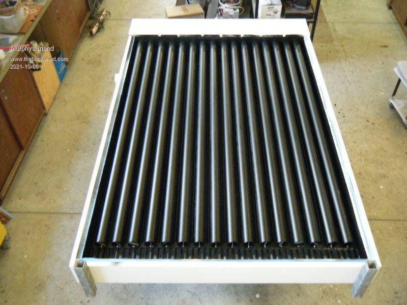

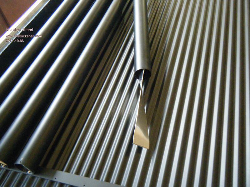

On top of that a layer of colorbond mini orb sheeting, painted black, to act as a thermal mass in the box.

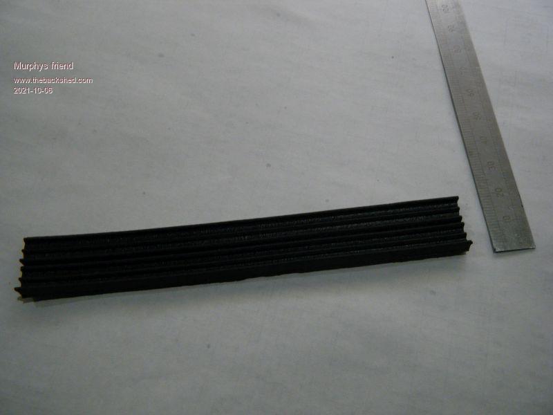

Then came the 16 anodised alu tubes (50mm dia.), these have twisted strips inserted to get some air swirling motion.
Full complement of tubes are in the box.

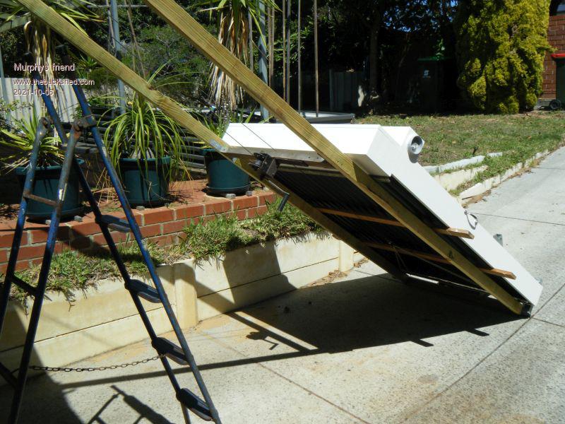

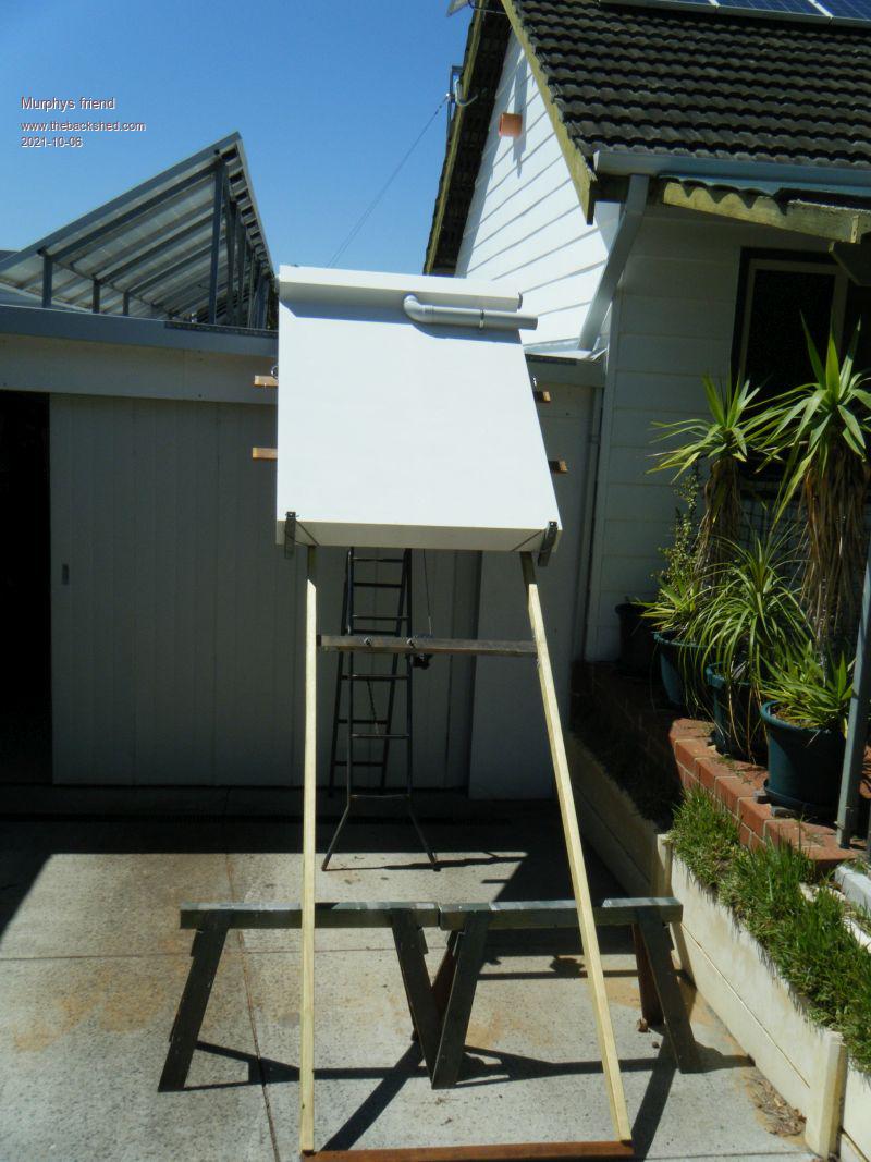

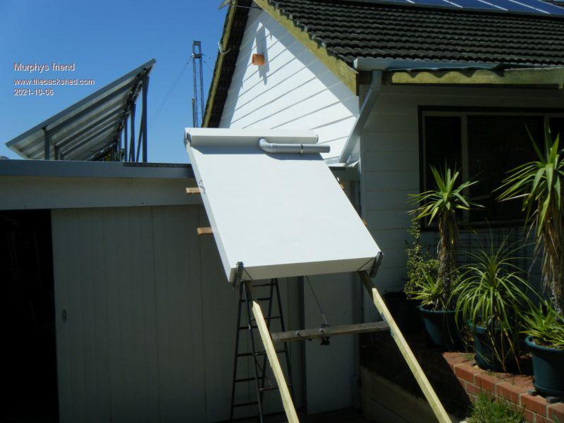

Here is how I got this onto the roof, the box stands 2m tall and weighs 60kg and is a *very* awkward shape to handle.
Almost up there.
Another view of the lifting ramp.

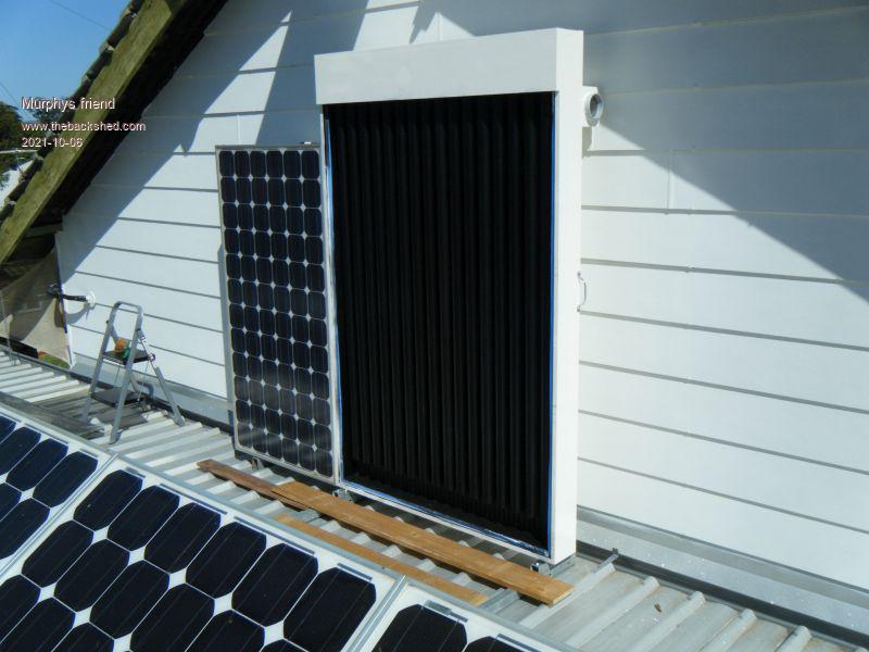

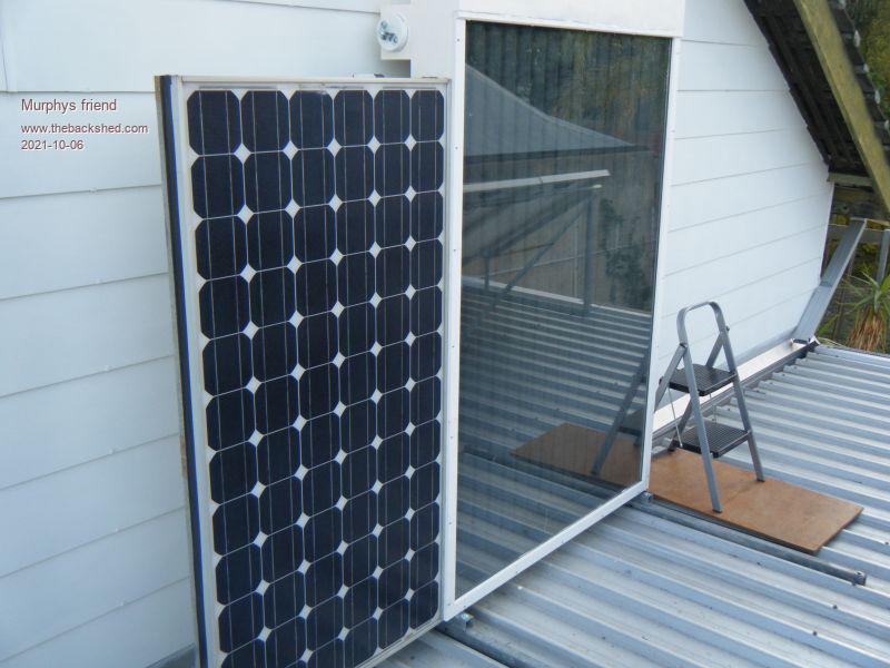

Stage 1 and 2 mounted in situ against the north facing house wall.
And now with the double glazed cover in position.
I used 2 x 4mm glass sheets, separated by this sealing strip. The gap is about 3mm, the edgres are sealed with gaffa tape before siliconed into the heater box.

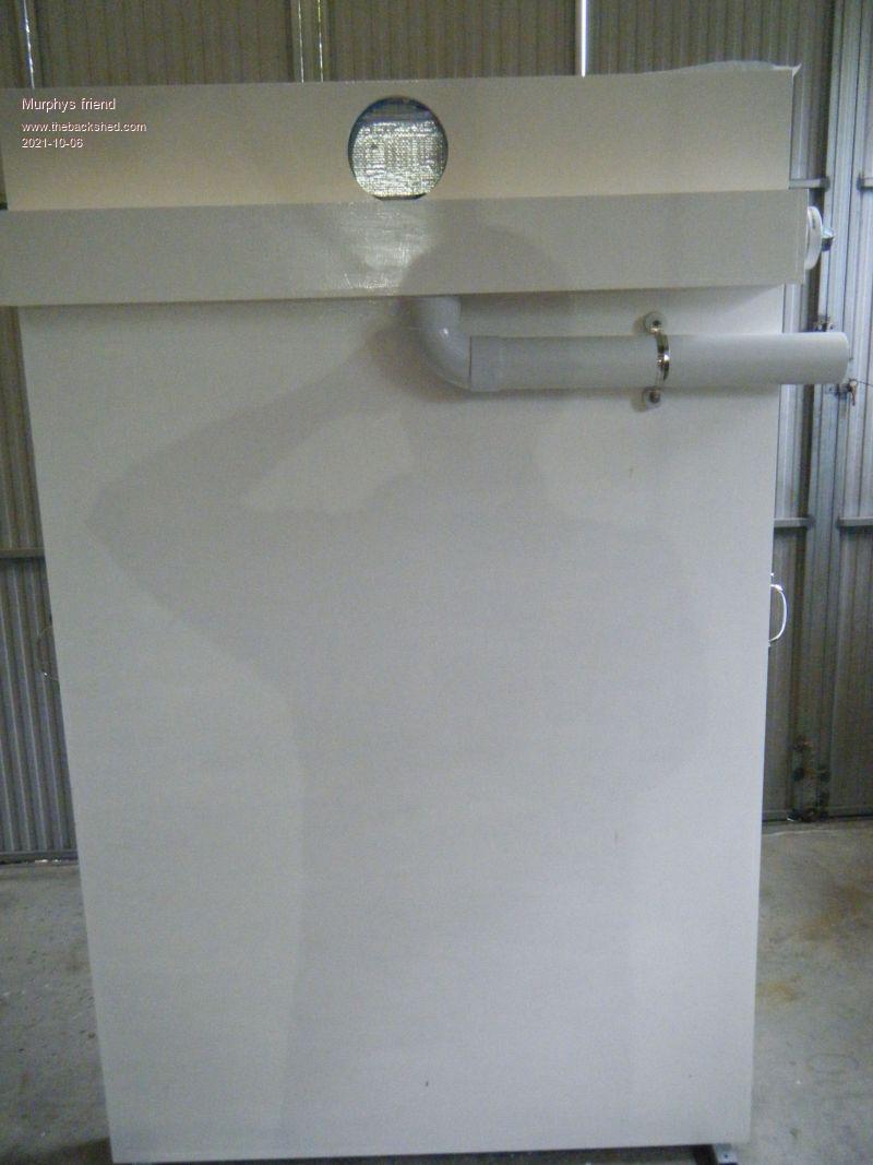

Finally, a view of the back side of the heater.
There is no ducting to any room in place as yet, plenty of time before the next Winter cold requires that . I will post some temperatures tomorrow from a sensor in the outled opening and one behind the box in the shade. It was too late for that today.

That box performs even better than I hoped. Today at about 8AM I heard the fan starting up as the sun had hit the solar panel by then.
At 10AM I climbed up and checked the thermometers, 21 degrees air in and 43 degrees air out. The heater  is located in a rather sheltered position so the intake air was around 2-3 degrees warmer than that near ground  level.
At noon I checked again, 23 degrees air in and 47 degrees air out. The fan running flat out all the time.
That double glazing pays off, the outer glass sheet is barely warmer than ambient to the touch.
Solar panel area is about 1 sq meter and the double glass surface 2 sq meter (1.96  ).

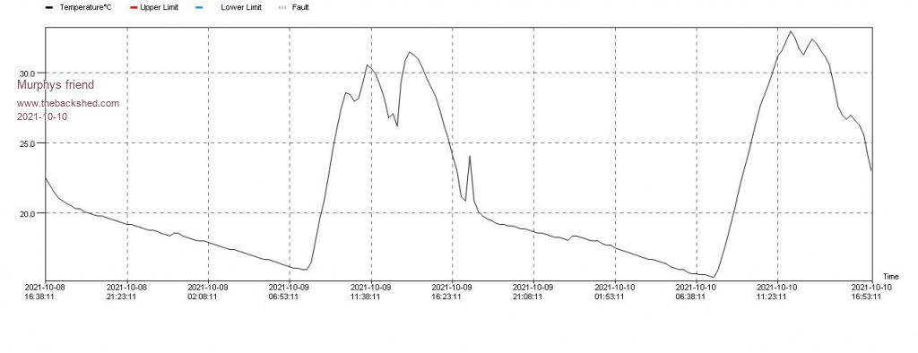

I placed my Elitech temperature logger on a support that is at top door frame level and about 750 mm from the ceiling grille. I will see tomorrow evening what a full day's graph looks like.

It's satisfying to see something like this instead of something you can look at and see gaping holes in the idea straight off.
I was thinking of the summer period and was wondering if the thing could thermo Syphon  and pull air out of the upper space by either venturi effect. I was trying to do the mental arithmetic but wasn't sure either way. Also wondered if it would be worth reversing the fan. That would have to be Physical however because those things  are maybe 10% of their output run the opposite direction.
5th thought as usual was one would have to be careful about introducing potential hot air from outside to the lower level when attempting to get rid of it at the upper level  where no one may be until well after dark anyway.
You have done a great job mate no doubt and I'm sure it will prove to be quite effective.

Thanks for your thoughts and kind words Davo. I built this device to be solely solar operated with no input from myself or any thermostatic control other than opening the vents during summer and switching off the fan.
So no plans to run the fan after sunshine hours.
The thermo siphoning idea came to me during the build and is also a reason why the solar collector is vertical (space limits were the other reason). If it does not work no big deal, it was an interesting thought to ponder.
One thing I learned about home made double glazing is, the panel ends up being *very* heavy. Mine weigh in around 50kg, its the only task I got my mate to help with when installing it on the roof - its just too fragile to accidentally drop it .
Also, anybody trying to make something like that, do clean the inside glass surfaces before sealing them together. I assembled it at the glazier's premises on his nice big carpeted table top where it was not easy to see the dust on the glass.
Carrying that lot home on a special board on my car's roof rack was fun too...
