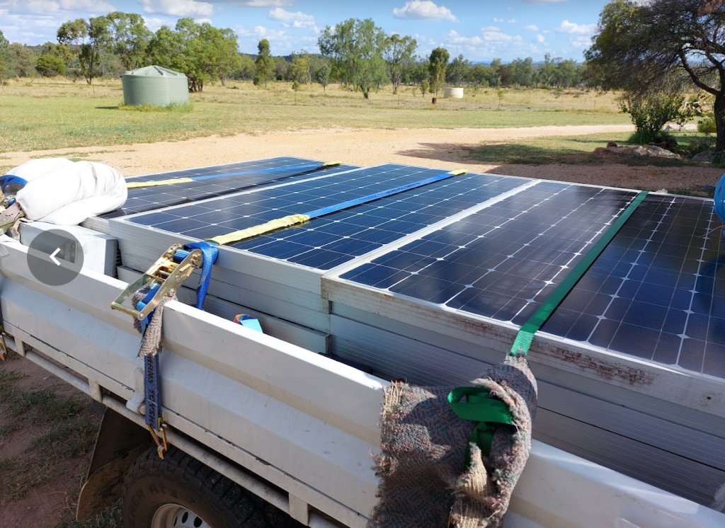

Some cabbage was too lazy to take these to the tip. Wouldn't even take money for them. What a steal.
I'm told the GTI works so I'll give the homemade inverter a go so I can backfeed and avoid buying a charger.

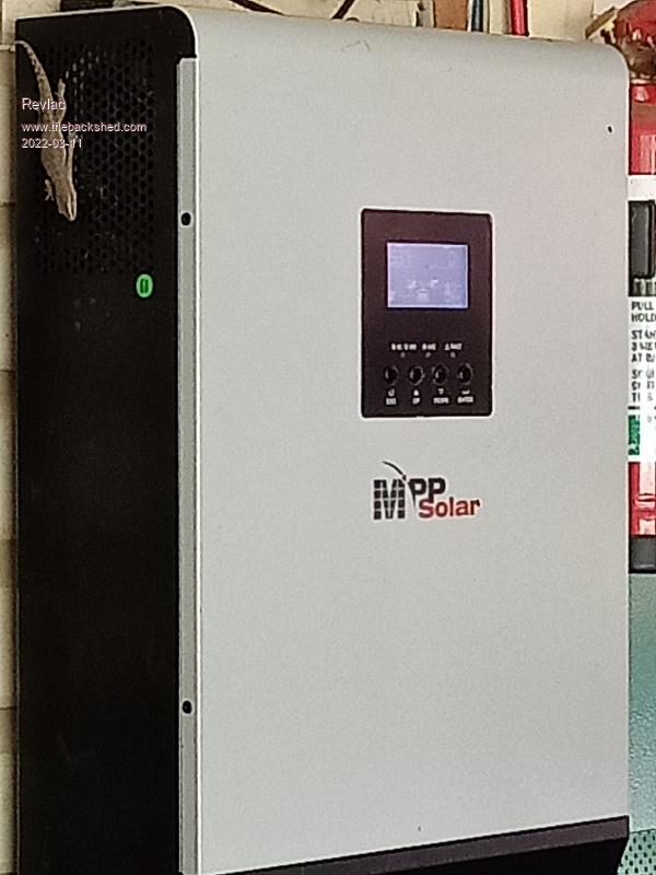

  Quote  I was pretty gung-ho about the MPP unit, but when I read the manual I don't really like how the powe path topology is set up. From my understanding it powers the inverter directly off the solar and if the solar does not meet the load it will transfer to battery or grid. Some of my gear is sensitive to small power losses, even from an interactive UPS transfer.
Also doesn't seem like you can use the inverter and charger at the same time. At night I would like to run off the inverter with the grid keeping my batteries from being too deeply discharged.
That pretty much how it works.
The changeover time is about 10ms according to the manual, even that would upset the old computer I had, it was connected to an ups when we had grid power here, sometimes it worked depending on computer load.
I have never used or connected the grid to these inverters and so have never had any interruptions (on solar all day and battery all night) plenty of storage.
The low voltage solar input (MPPT or PWM) on these models is fed to the battery side DC buss, so will supply power to the converter and charge the battery with any left over, the only way to charge the battery from grid power is to run the inverter backwards and is the reason for the 10ms transfer, thats my understanding of it anyway, pity they Didn't have another small converter that could bypass the inverter and charge the battery independently.
The other option that would eliminate the interruptions, would be to have a battery charger that would charge or at least hold the battery voltage from getting too low.
I have at times run a generator and a 50Amp 48v charger to the battery, no interruptions to the inverter or output.
There is one inverter that has Zero transfer time, I think the way that works is the grid input is rectified and fed to the high voltage DC buss, then the solar power is also fed to the same buss but at a higher voltage (430VDC I think it was) so it will use the solar first until there is not enough, I think the battery-less version works in a similar fashion, or its the same one.
Those were out of the price bracket though.
