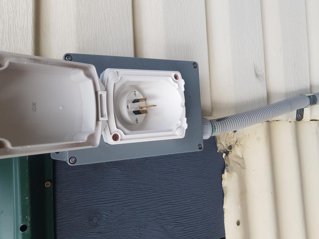

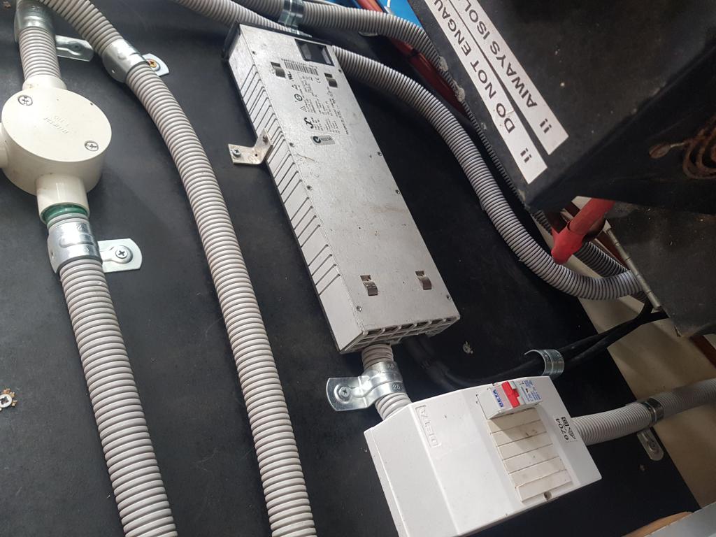

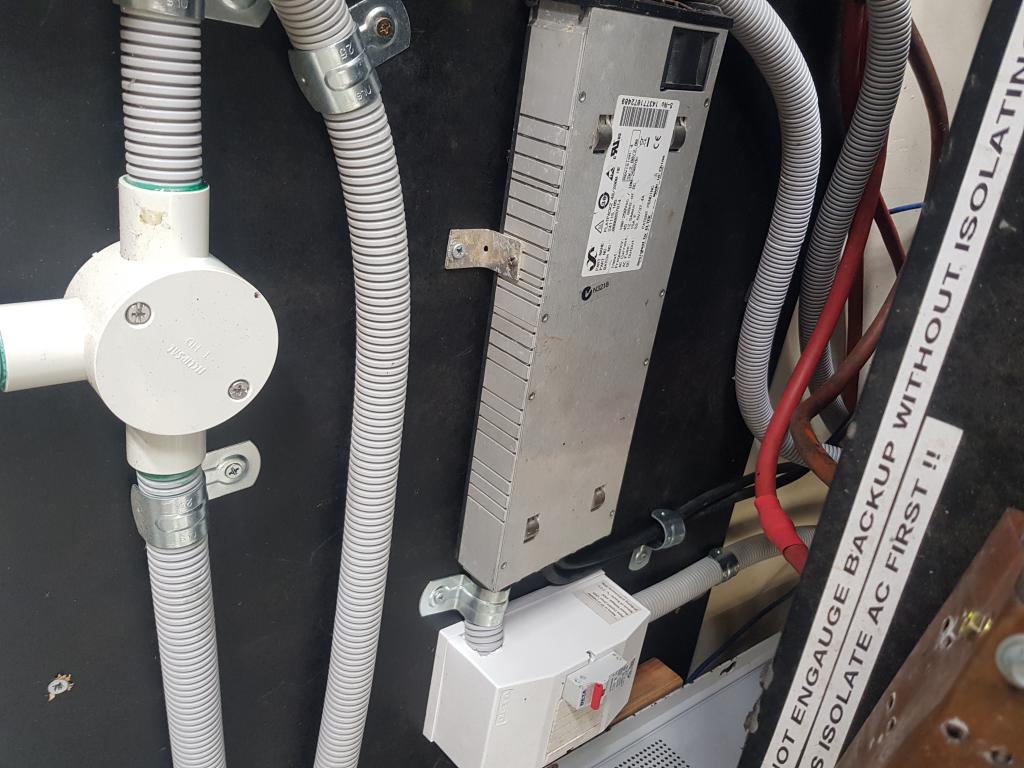

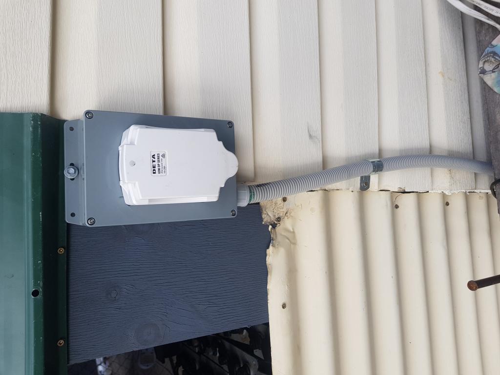

this is the setup I use, got a standard " caravan " input plug from bunnings, and mounted it to wall with a breaker etc... works great...
this is one of the welders I was talking about, just replace the electrode clamps with heavy alligator clips..and add the extra turns on main transformer if needed...
